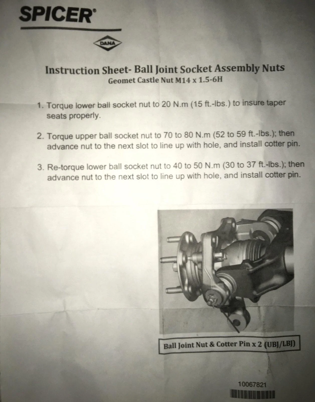

they have a pin in place, so if they were on finger tight they forgot to torque.
They forgot to torque was my first thought however Did anybody actually check the ball joints and find them torqued to spec? it seems like everybody that checked found them loose.
How about, they were torqued originally maybe some dissimilar metals were hot or cold or the ball joint moved in the aluminum because the aluminum is softer or something then nut would be loose and the cotter pin would still be in place.
Also if there is some problem or some movement with the steel and aluminum that would also explain why some are reporting that they torqued them and they come back to find them loose again ? How do you explain that ?
The loose ball joints happens when they torque them and it lines up perfect with cotter pin hole and they don’t tighten to the next one. The torque is so low this happens rather easy.

2019 JL 2 Door Rubicon
So your saying Dana spicer is not following there own instructions by torquing and advancing to the next hole. OK
How do you explain people reporting that they torqued it and came back and found it was loose again?
Jeep Wrangler JL Death Wobble / Bump Steer / Steering Issues / Drifting - RESOLVED 224A27E7-18FD-494B-9FF1-7960CAB2034D
