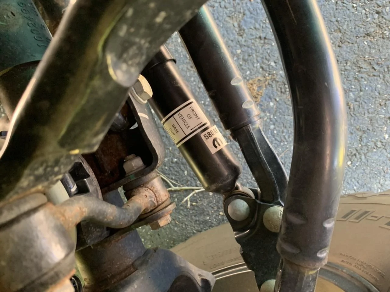

I had a serious death wobble with my Jeep. Turns out the dealer installed the recall steering dampener UPSIDE DOWN. Apparently, there's a bump that needs to be facing up.
Interesting you mentioned this. I just checked my replaced steering dampener and looking at the affixed sticker, seems to be possibly upside down (it’s shows front of vehicle arrow facing the wrong direction).
I hit a bump on the highway and legit thought I was going to die. Make them fix it. Scariest thing ever.
Ah so this is confirmed upside down? Just wondering if you can confirm comparitive to yours.

Thanks, sounds like I should have the dealership correct the steering dampener orientation (still looking to have someone confirm for me that it is in fact upside down), and while they are there check any loose connections, or loose bushings. I can then get an adjustable front track bar to re-align the suspension.
Anyone able to check their OEM dampener, and confirm which way that sticker should go? Mine looks wrong, but I want to be sure if I go to the dealer and demand them to fix.
I can confirm it is upside down. At least when compared to mine. They performed a recall for the dampener. After that I had the death wobble. The fix was to roll the dampener because they installed it upside down. With the sticker being on the bottom, the arrow will point to the front of the Jeep.
You only need to remove the bolt on one end of the damper to roll it over. You might just wait til you have a trackbar and either have someone do it all at once or do it yourself when installing the trackbar. I don't like going to the dealer if avoidable.
