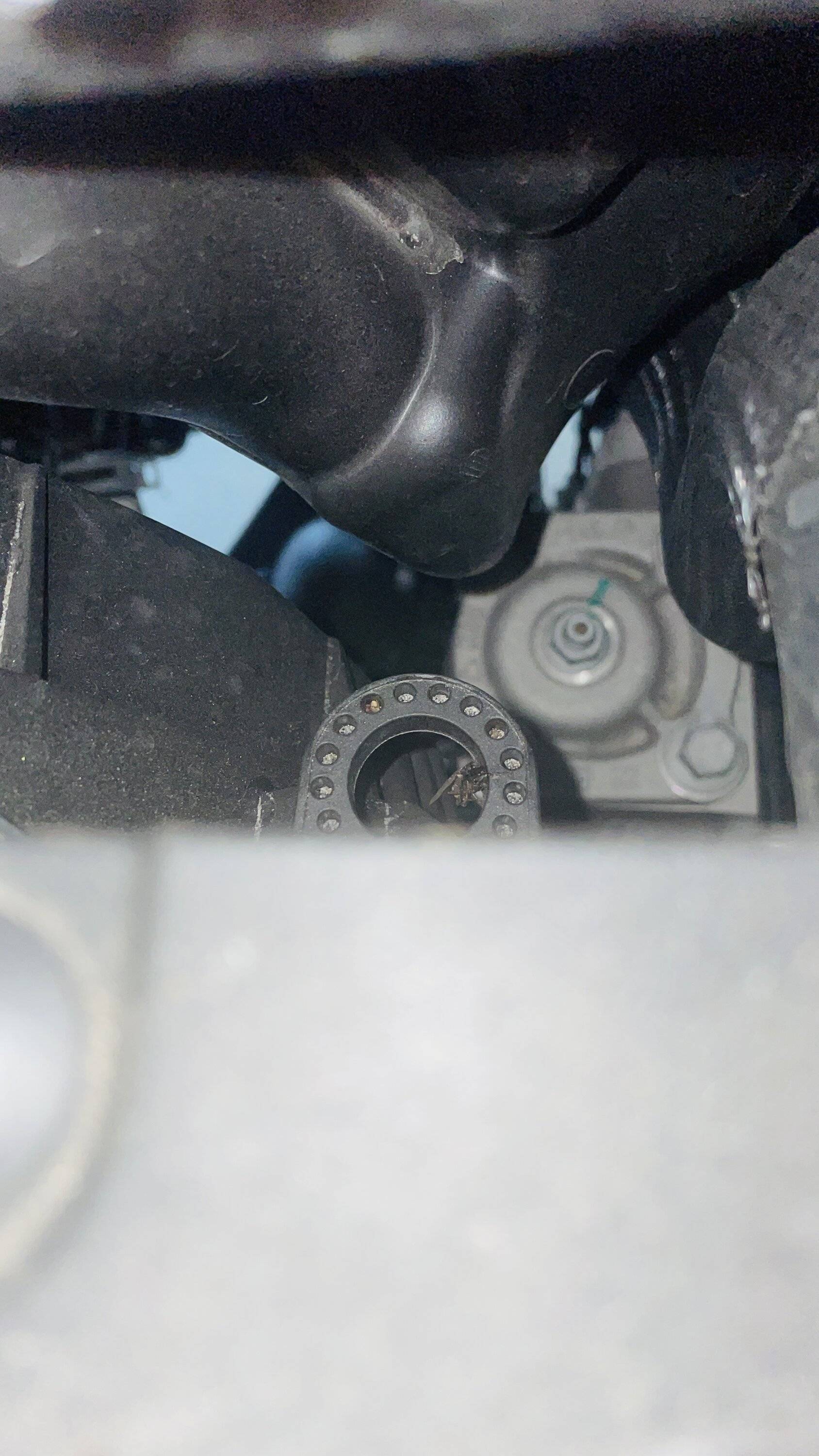

Be sure to complain that you have loose steering. That is one of the symptoms/complaints to make them do the TSB. Before you do though, are you sure that you currently have the aluminum box?
Yes, I still have the aluminum box.
