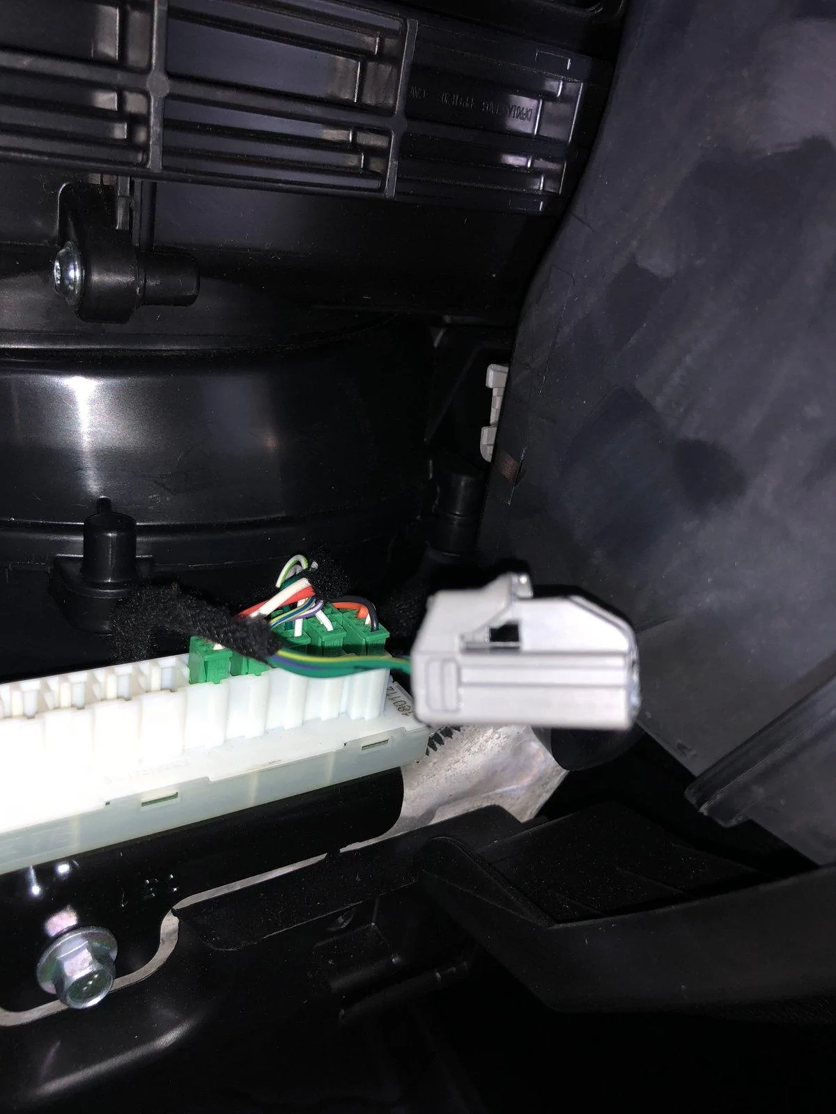

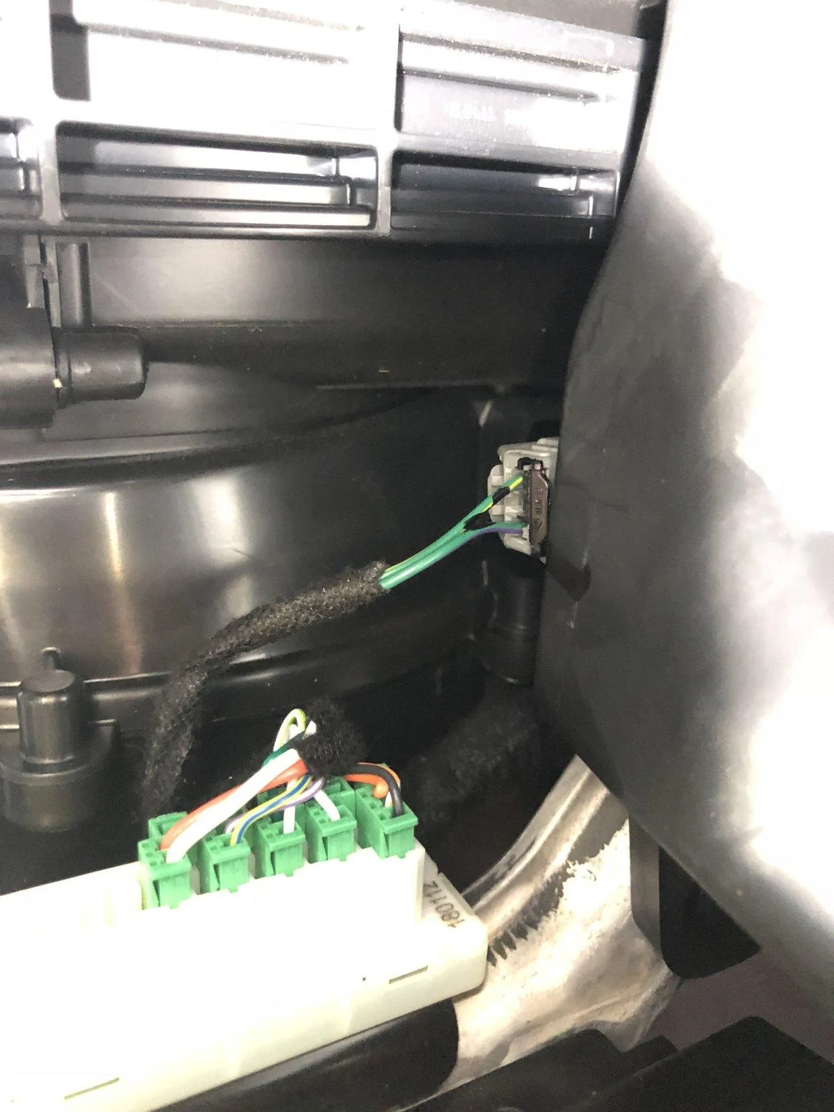

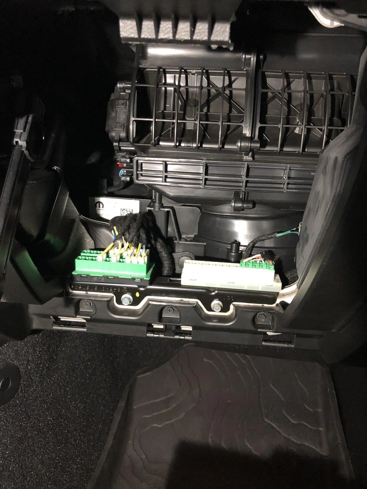

I was looking to access the lower speaker connections, and with a little exploring I realized that by taking out the glovebox, it allows access to the connector for the lower dash speaker on the passenger side. I am looking to add a line output converter to install my Infinity BaseLink. I thought this was going to be more involved, but this find has made this pretty easy. Hope this can help.
