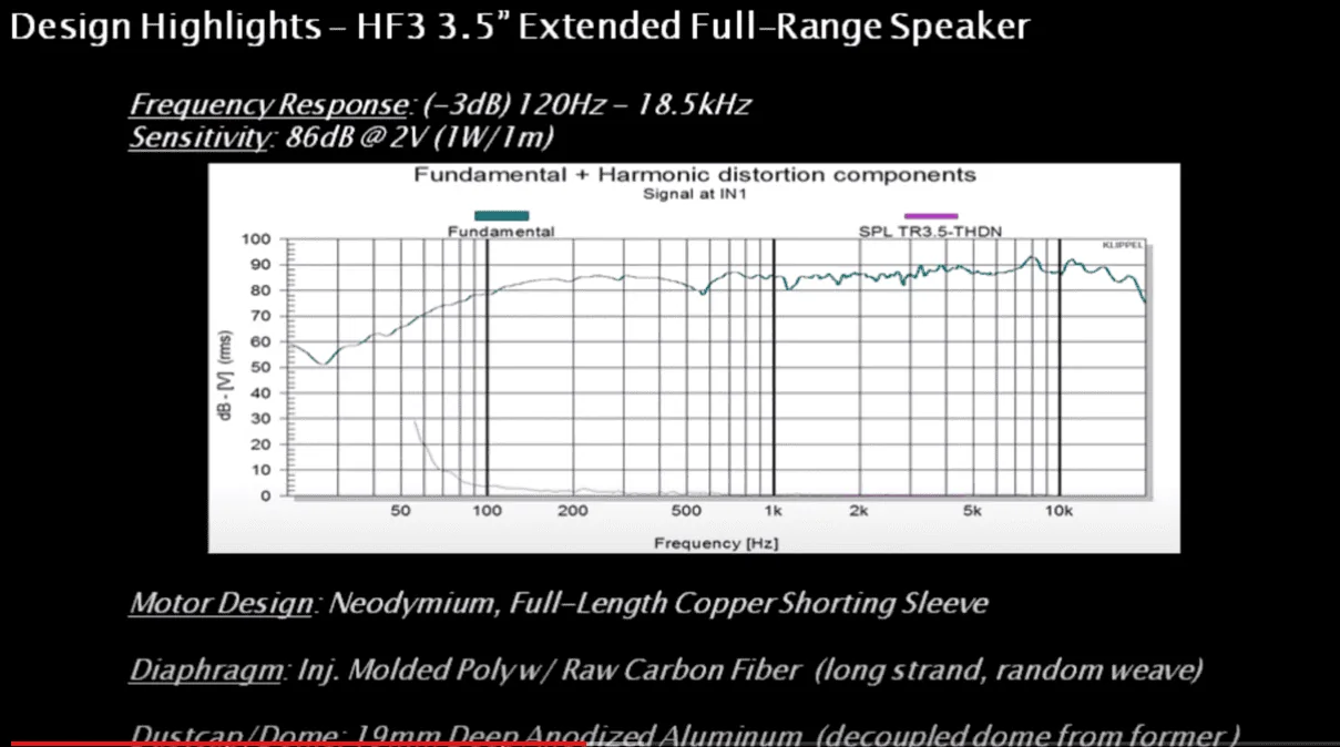

Has anyone found a decent midrange speaker to replace the dash speakers? I was looking for something like these, but Crutchfield and Amazon say they don't fit.
