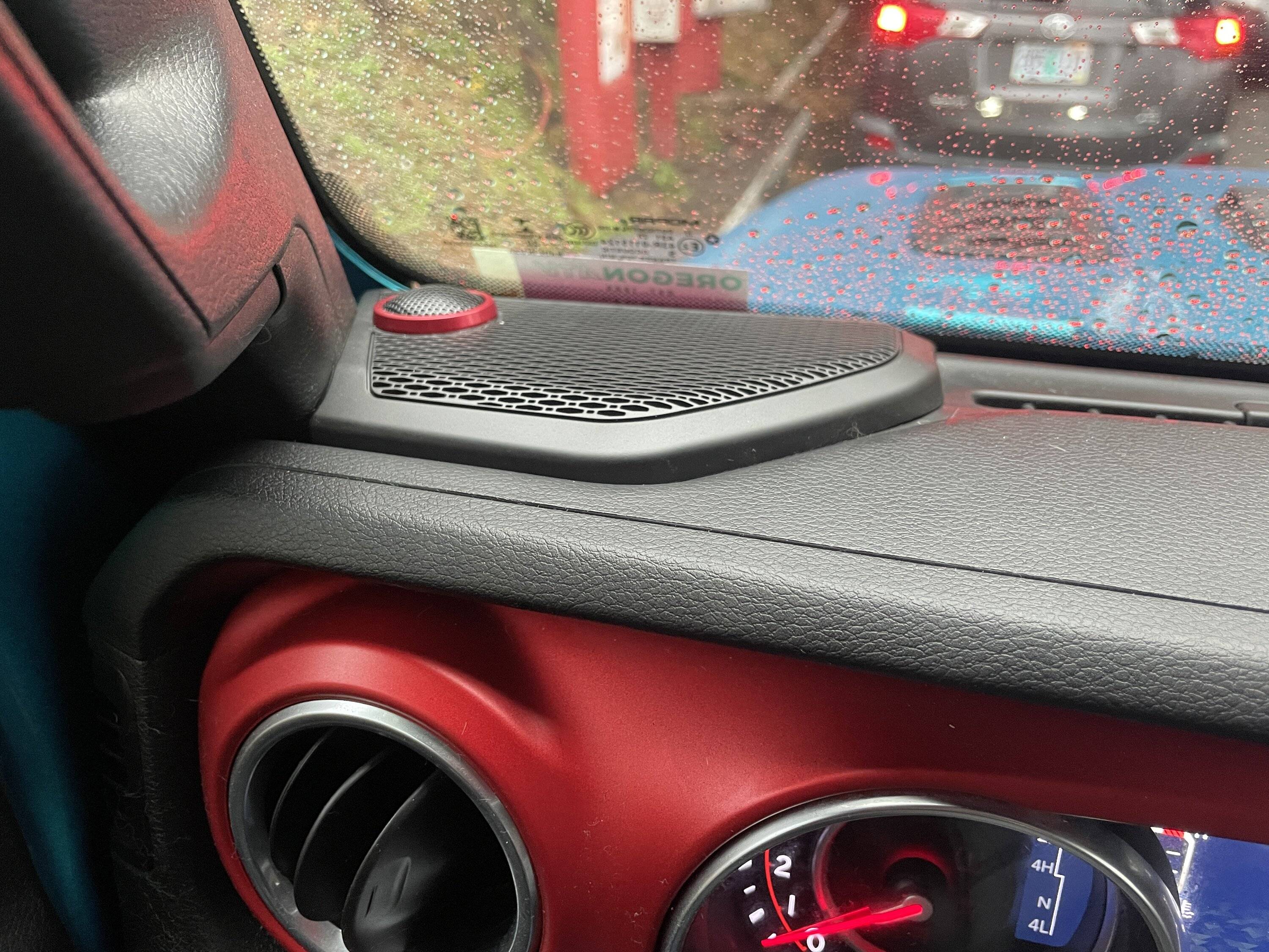

I went with Terra Acoustics JL front upgrade, not inexpensive, but I like the results and looks factory

Too lazy to work
If you don't mind, what is your opinion of the Terra Accoustics? I purchased a pair for my new JT, but haven't had the time to install them yet.
