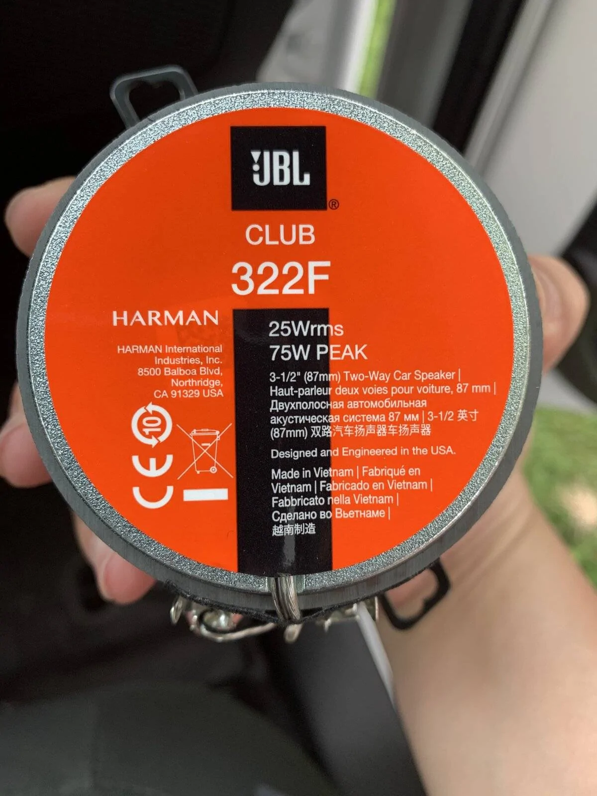

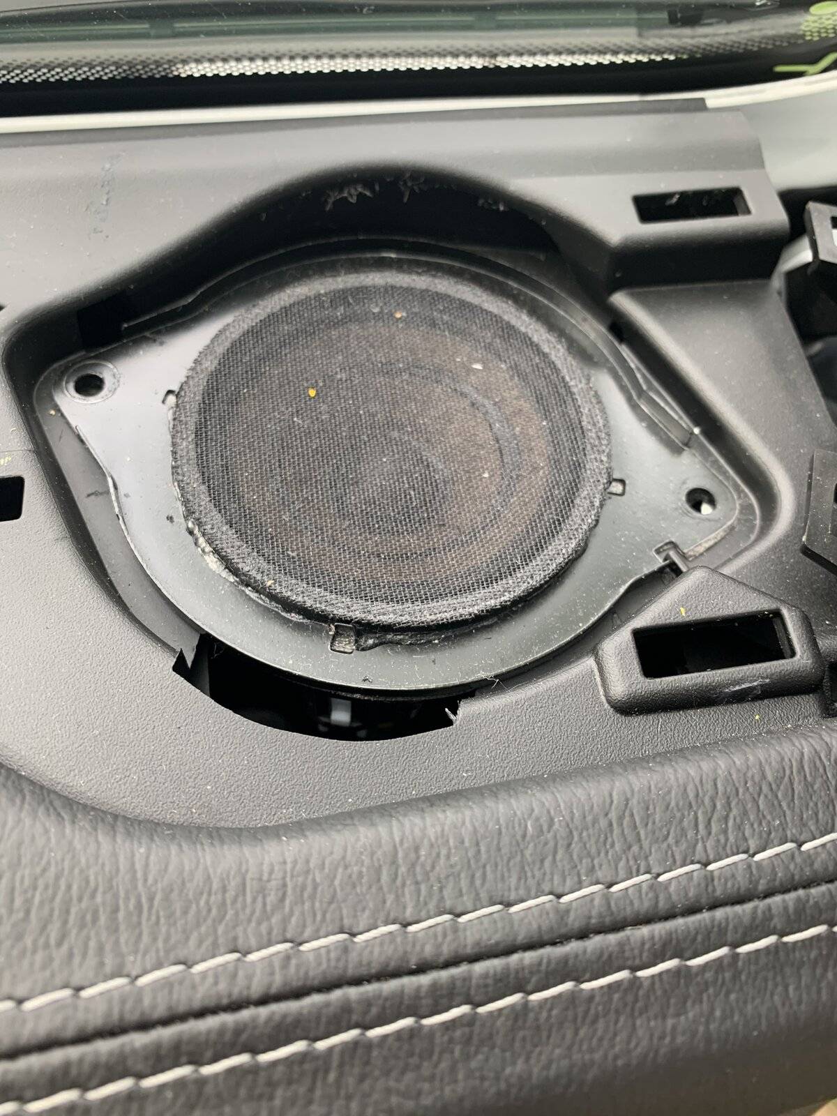

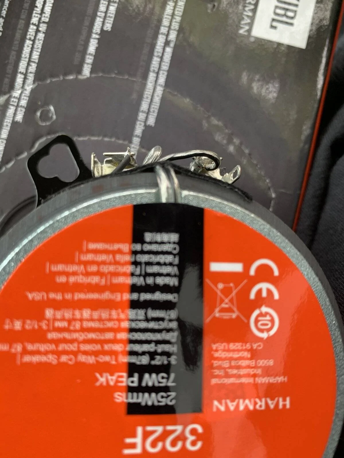

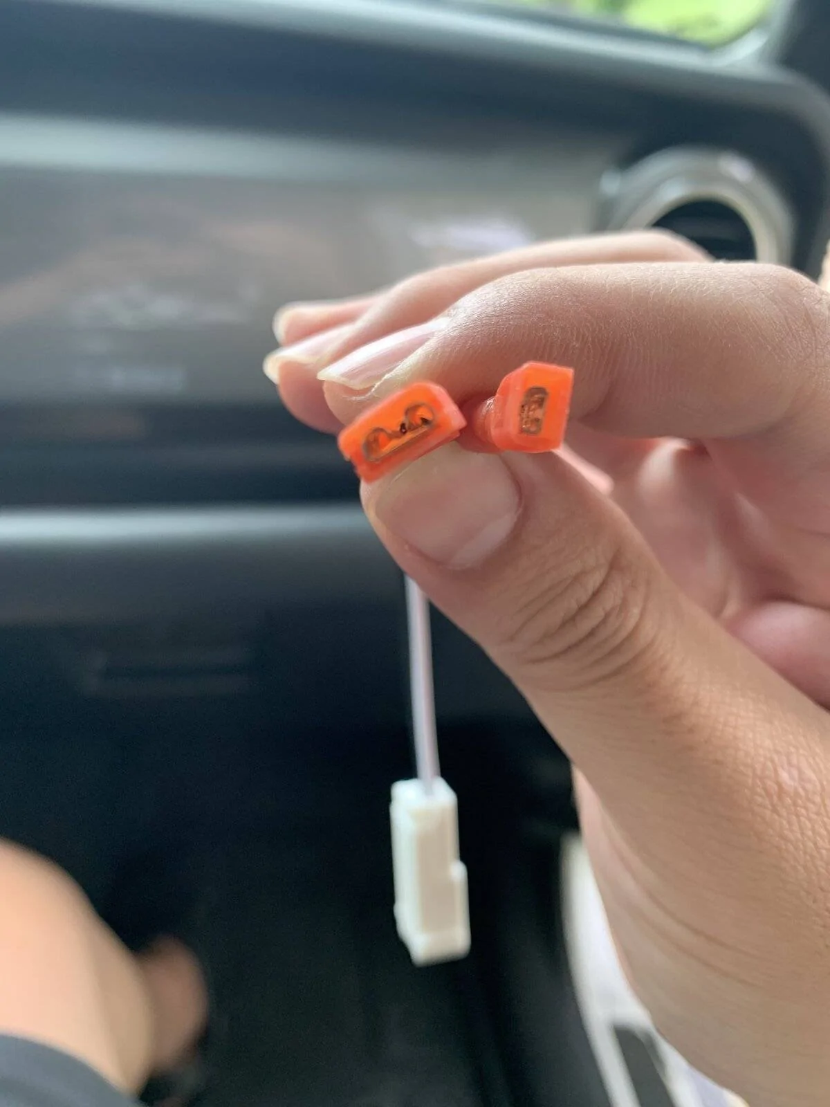

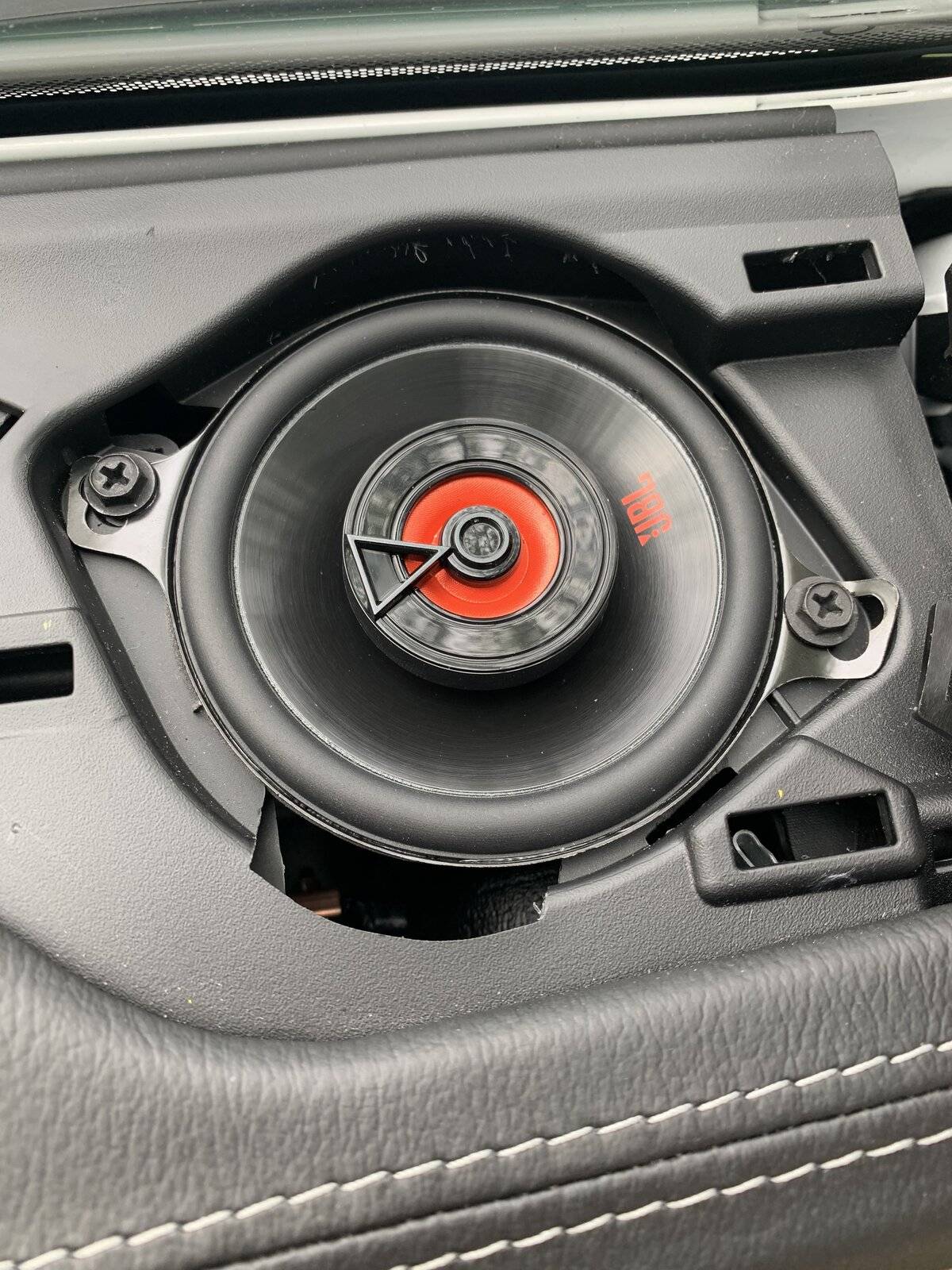

I just replaced my two front tweeter speakers on the dash and it’s amazing. I was deciding between the kicker and JBL due to it being plug and play without any modifications. I’m glad I went with JBL the sound quality is awesome! I placed the order through Crutchfield and they sent all the wiring so I don’t have to do anything but plug and play.
For the install you would need one flat head screw driver or a trim removal tool and one small phillips screwdriver or a angle phillips.

I ordered these exact speakers from Crutchfield so I got the adapters. I installed them yesterday. Had a hard time getting them to fit. I had to trim the mounting tabs a little. The speakers seem to be too deep and are pushing on the plastic vent hoses. I am getting some vibration at certain levels that almost sound like a blown cone. Did you run into any issues with your install?

Nope, you have play with the angle when you’re putting it in. No vibration or trimming needed here.

Same here--short of trimming the mounting tabs, there was no interference below the speaker. I used the Infinity Reference speakers.
