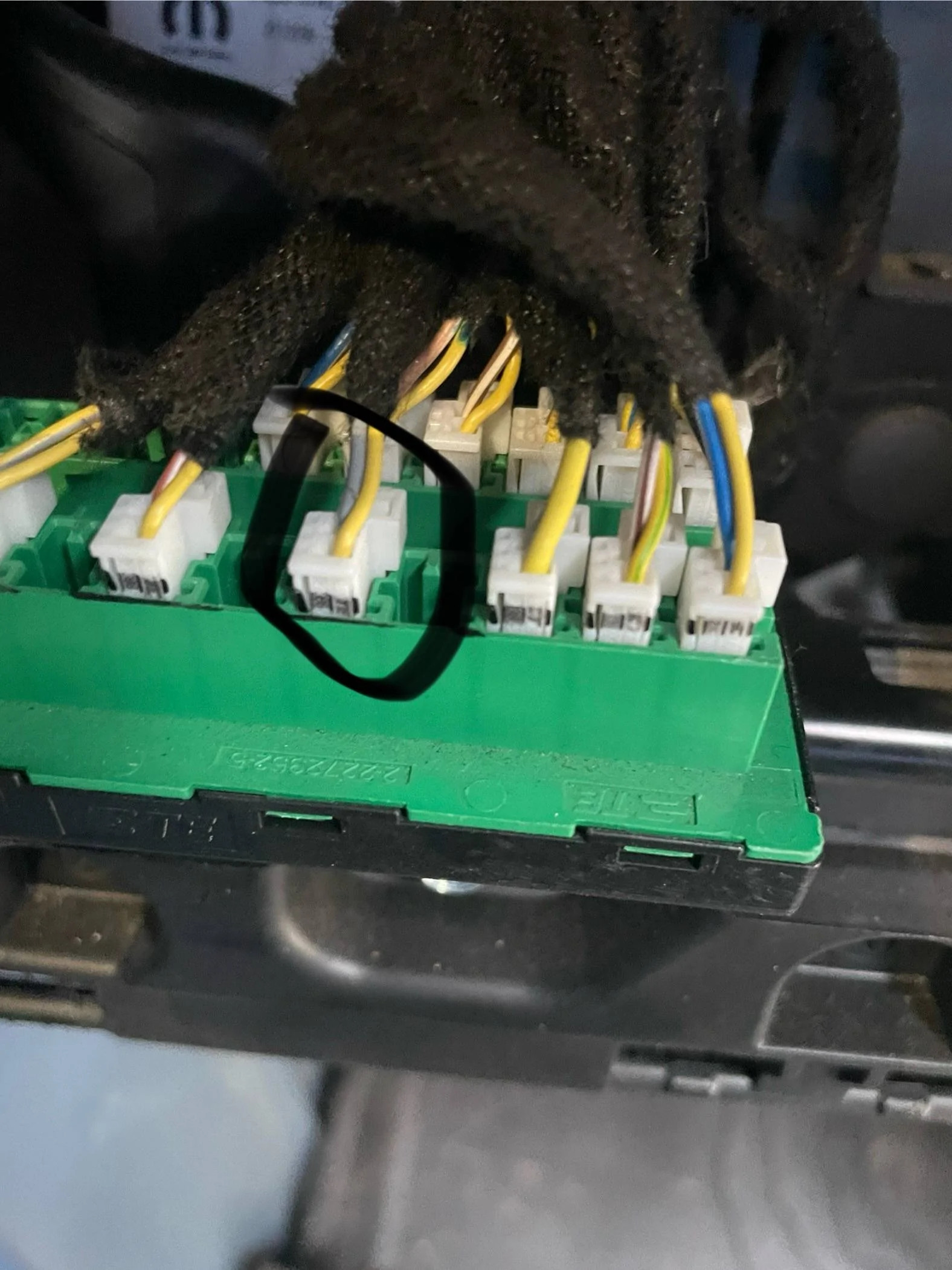

Canbus replaced. I will say after I checked the canbus previously and push the connectors I haven’t had an issue so hopefully this is the problem. Next issue. One of the white wiring connector clips broke. Does anyone happen to know a part number for these. I tried to look but am not having any luck. Also I have never had to replace one of these. Is it something that can be down with regular tools or would I need something just for these connectors?

Just an update. So far issue hasn't repeated itself. I will give it another week and then I will take apart the old canbus to see what it looks like inside.
Glad to hear! It's amazing the troubles that can be caused by an $8 piece of plastic. I took my old one apart after I replaced it, and could not see any visible signs of failure.
Hi - when replacing the STAR connector I also broke one of the white plugs that go into the connector. Have you been able to find a replacement or get a part number by any chance?
I never did find another connector. I haven't had an issue with the plug not being clipped in. I would've had one a few weekends ago when I was at AOAA if it was going to be a problem.

Thanks for your response - unfortunately I broke one connector in half using needle nose pliers. Does not feel secure plugin it back in. I cannot locate the little white connectors anywhere.
Tried eBay, jeep parts online etc. - it's tough most likely an electrical standard plug from some manufacturer unknown to us. Getting the green can bus connector was easy ...
One more: what is the right way to remove the white connectors from the green can bus base?
I most have done something wrong?
Attach a good photo or two to an email and send it to Jim at EB. I've sourced esoteric electrical connectors, etc. from him for a while now. If he doesn't have what you need, he might at least be able to provide the correct name. No guarantees here, but worth a shot.
Push a very small flathead screwdriver into the clip and you will feel and hear a slight click - when you do, the connector can be pulled out easily.
The green CANBUS is made by TE Connectivity - perhaps they make the white clip as well?
Little flat head screwdriver like a glasses repair one and on the one side is a clip. Push the screwdriver toward the connector and pull up. Just needs a little pressure not much. That’s how I broke mine with to much pressure.
