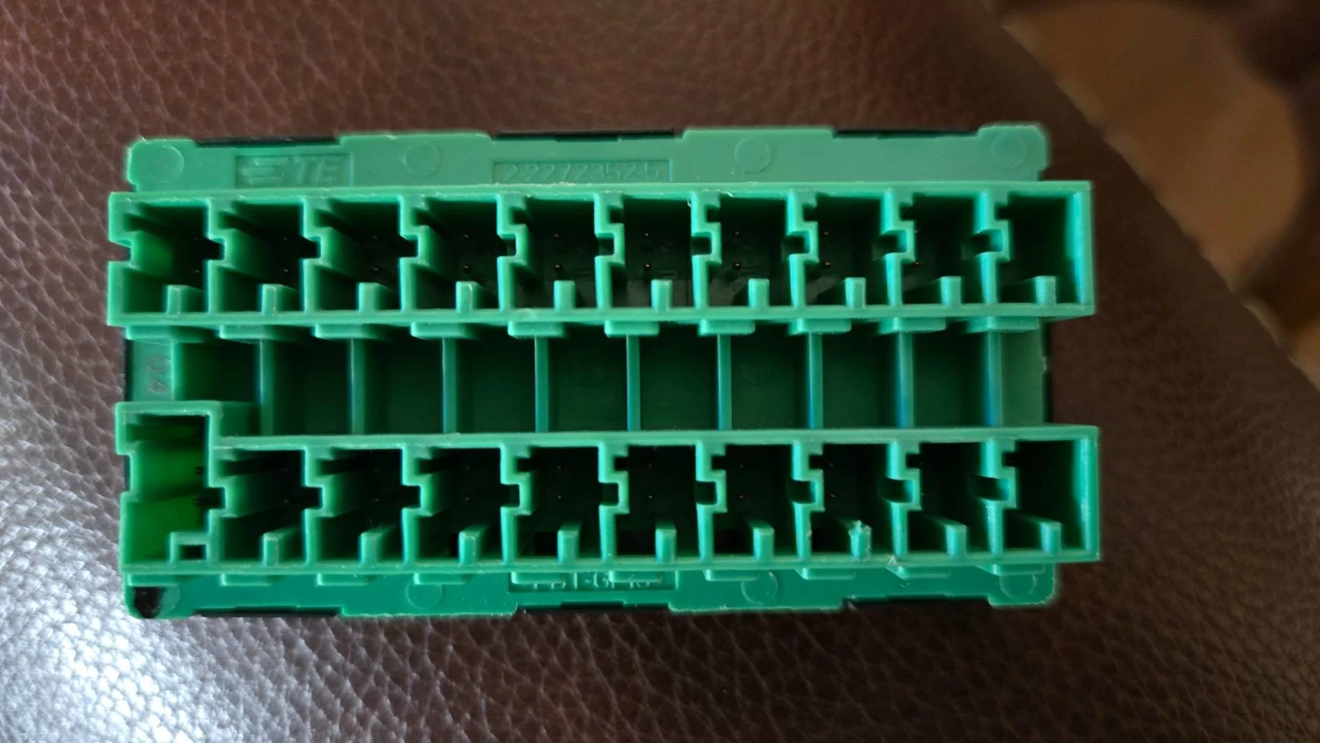

Start investigation the Canbus star connector in the glove box. My jeep did the same thing but I was throwing communication errors.

I pulled codes and there was a bunch of communication errors. Read about it and then took the Jeep in and told them. Of course they did not listen the first time and said it was my security bypass for JScan that caused the issue. They removed that and said fixed. They pulled Jeep up for me and as it was sitting there it started doing all the same stuff. This time they listened to me.
Some have just bought the part on eBay and have replaced it. I believe it is fairly cheap.

Good place to start. These used to be easy to find but I think Stellantis must have bought them all up for warranty work?
68321746AA Wrangler JL JLU Gladiator CAN bus Star Connector

Investigate replacement of the CANBUS block(s) behind the glove box, as suggested.
Do also consider replacing the main 12V battery, depending on its age. When they're nearing the end of their practical service life, they can sometimes cause a variety of seemingly unrelated electrical problems. Modern vehicles that are excessively encumbered with electronics, like our Jeeps, are susceptible to such things. Be sure to use an AGM battery, if or when you do replace the current one.

Hi all, unfortunately replacing the CANBUS didn’t solve the issue. Anyone have any other suggestions or ideas? Thanks, TT
