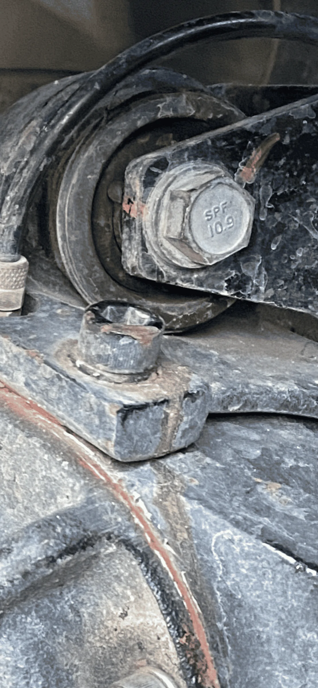

Jeep Wrangler JL Crystal Rubi build… 6175A13B-87FC-4906-A526-E39230437C32
mine go squish forward, granted its hard a hard life and that diff is heavy son of a bitch haha

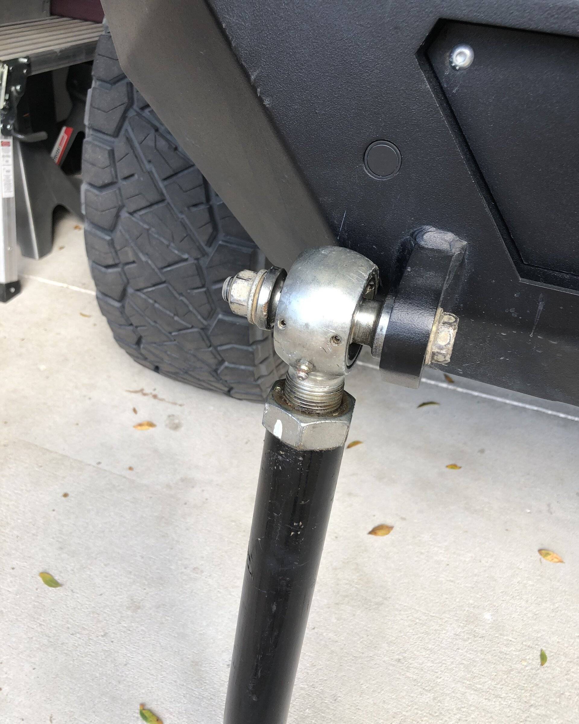

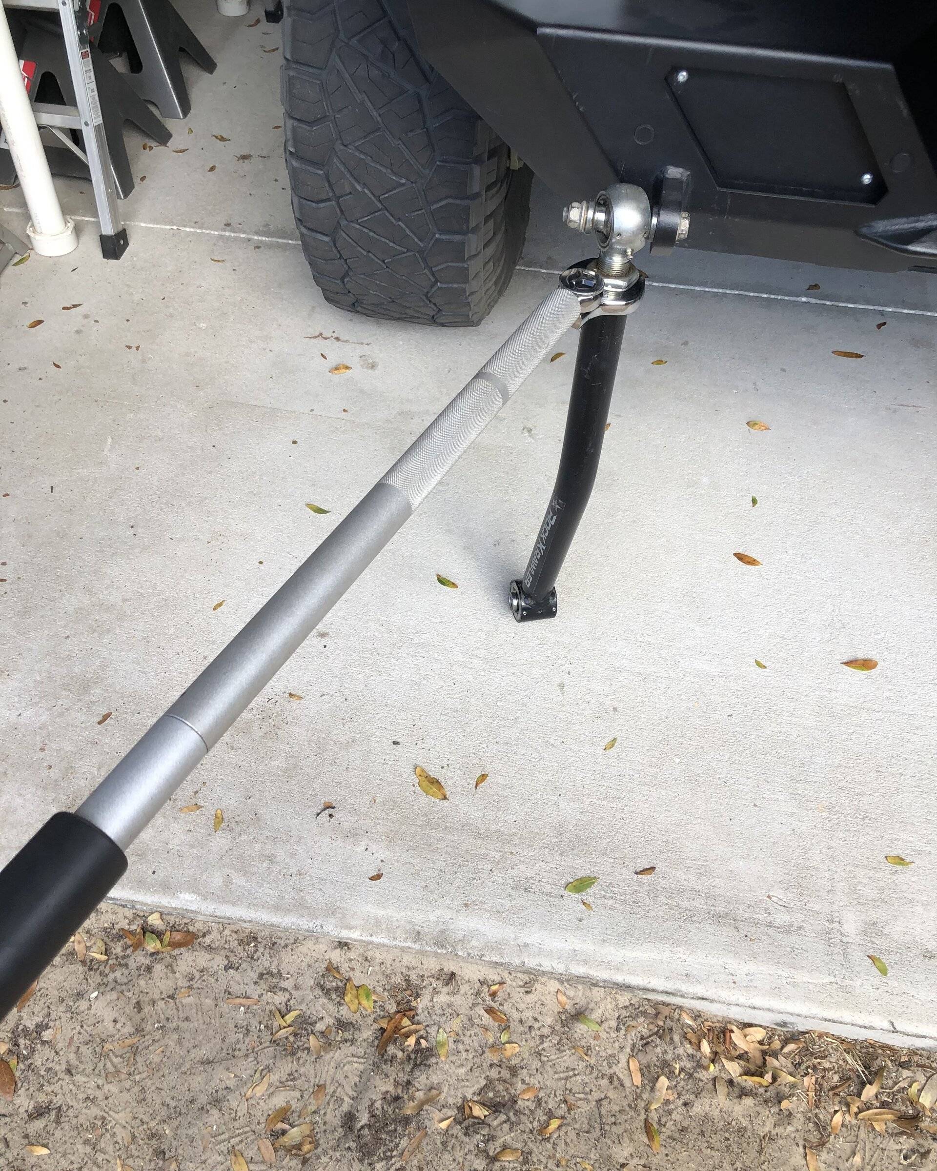

I have to install a lift for a fellow forum member, he’s also the new owner of my RK control arms. He’s doing a 2.5 inch RK lift so I had to adjust the lengths from 3.5” to 2.5” lift height.
Those Jam nuts been torqued to 250 ft lbs for near 2 years. Loosening them while off the Jeep presented a problem. I tried my vise, but couldn’t get it to hold. Next I tried driving up on it but the tire would give to much and I was lifting the Jeep but the nut didn’t budge…..? …… Finally an idea popped in my head standing there staring at my bumper……:idea: …..
Jeep Wrangler JL Crystal Rubi build… 4800D168-ACEA-457F-8BBB-0463578CA1D4
Jeep Wrangler JL Crystal Rubi build… 9176DBA1-F33D-491E-BF60-E146EC132321
1/2” ratchet with crow foot wrench and my floor jack handle worked like a charm… Thank you @lodoffroad …...?
