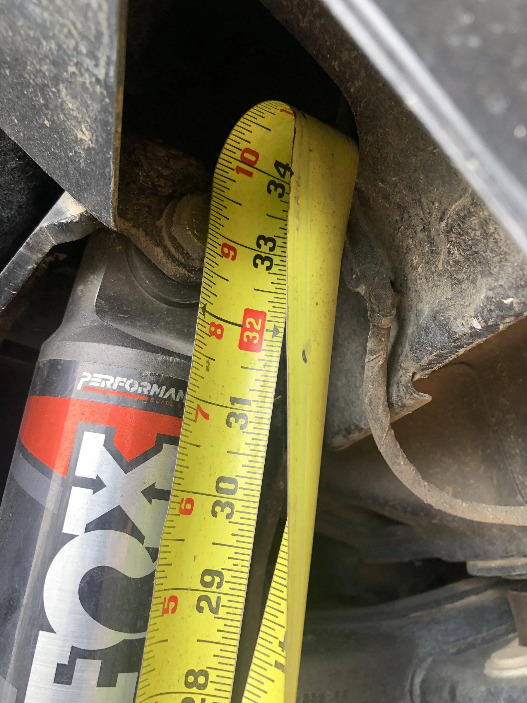

I raised my track bar up to the 4.5” lift hole on my bracket…….WOW !! No difference, lol. But it looks cool, it’s really flat now , and everybody says that it helps, so I’m going with that…….
Jeep Wrangler JL Crystal Rubi build… 06EEEC3F-AECF-467D-B553-0F568544829C

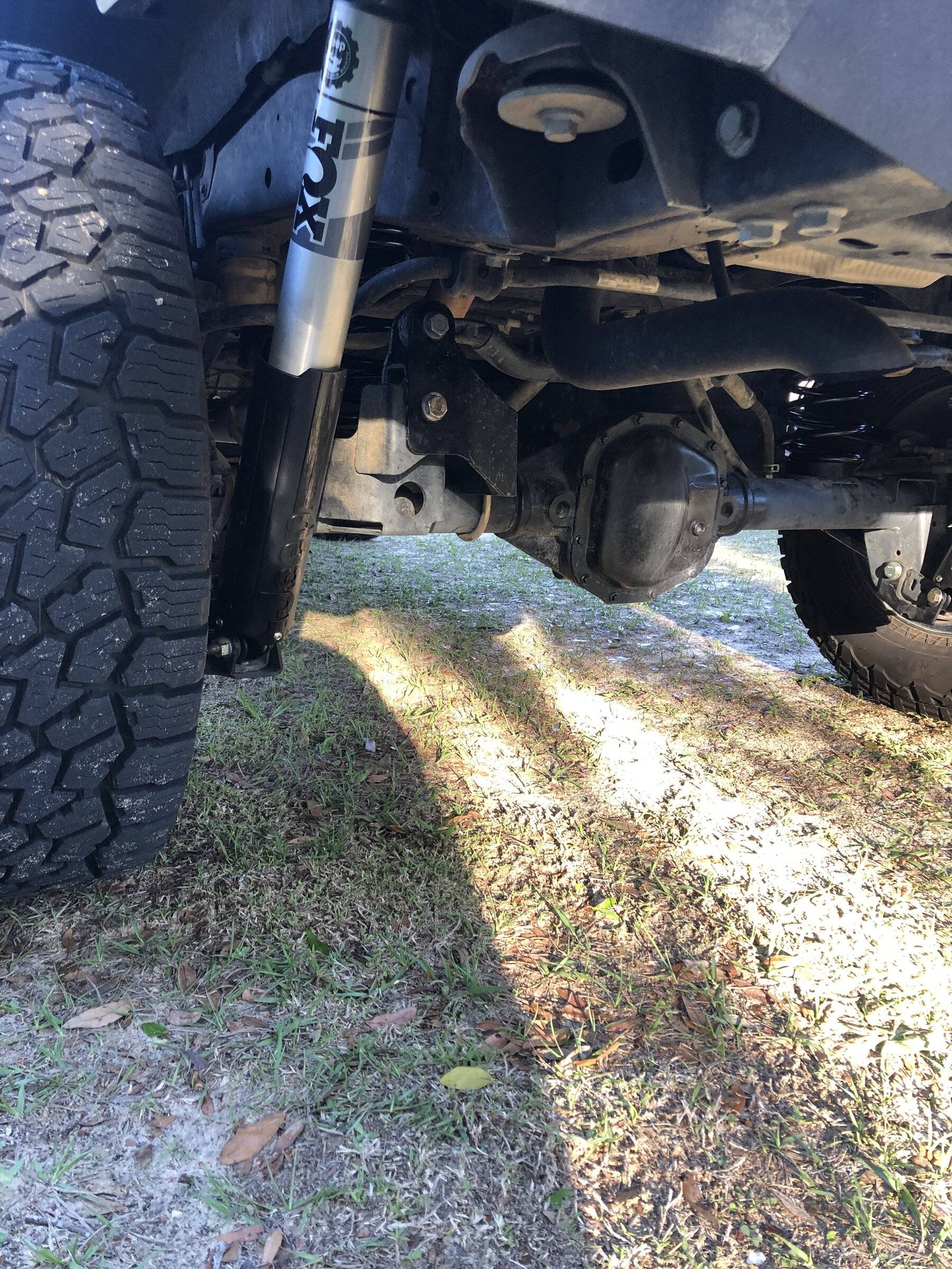

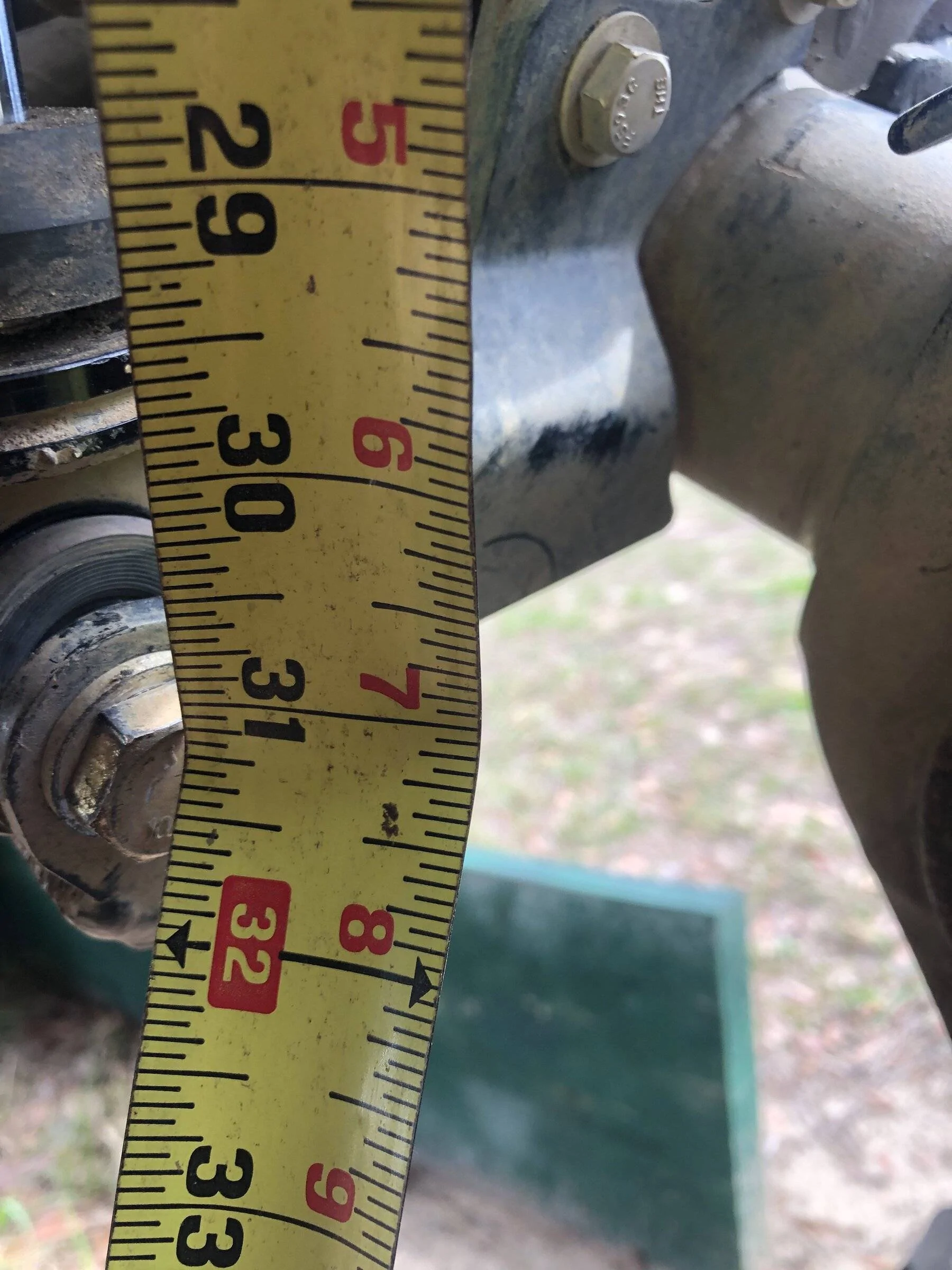

I measured my shocks too while they were extended, my rears are spec’d at 32.3” ext. but in the real world they are 33.25 “ and my fronts spec at 30.51 ext. but in the real world they are actually 31.0 “, on the front I had to measure top of bolt to top of bolt which is still center to center…..…….?
Jeep Wrangler JL Crystal Rubi build… F79E20AC-9506-4C1E-80CE-5302EEB25039
Jeep Wrangler JL Crystal Rubi build… D8076DBA-8767-4746-B96F-9747D6F7675A
So to sum up, now and forever I will be referring to my shocks as 31” ext fronts, and 33.25” ext. rear, and I won’t be exaggerating ……….?
Really surprised the roll center didn'y feel different.
that looks like 31 1/8" to me LOL
? …….. I didn’t know what the decimal for 1/8” is for reasons documented with my math teacher….??

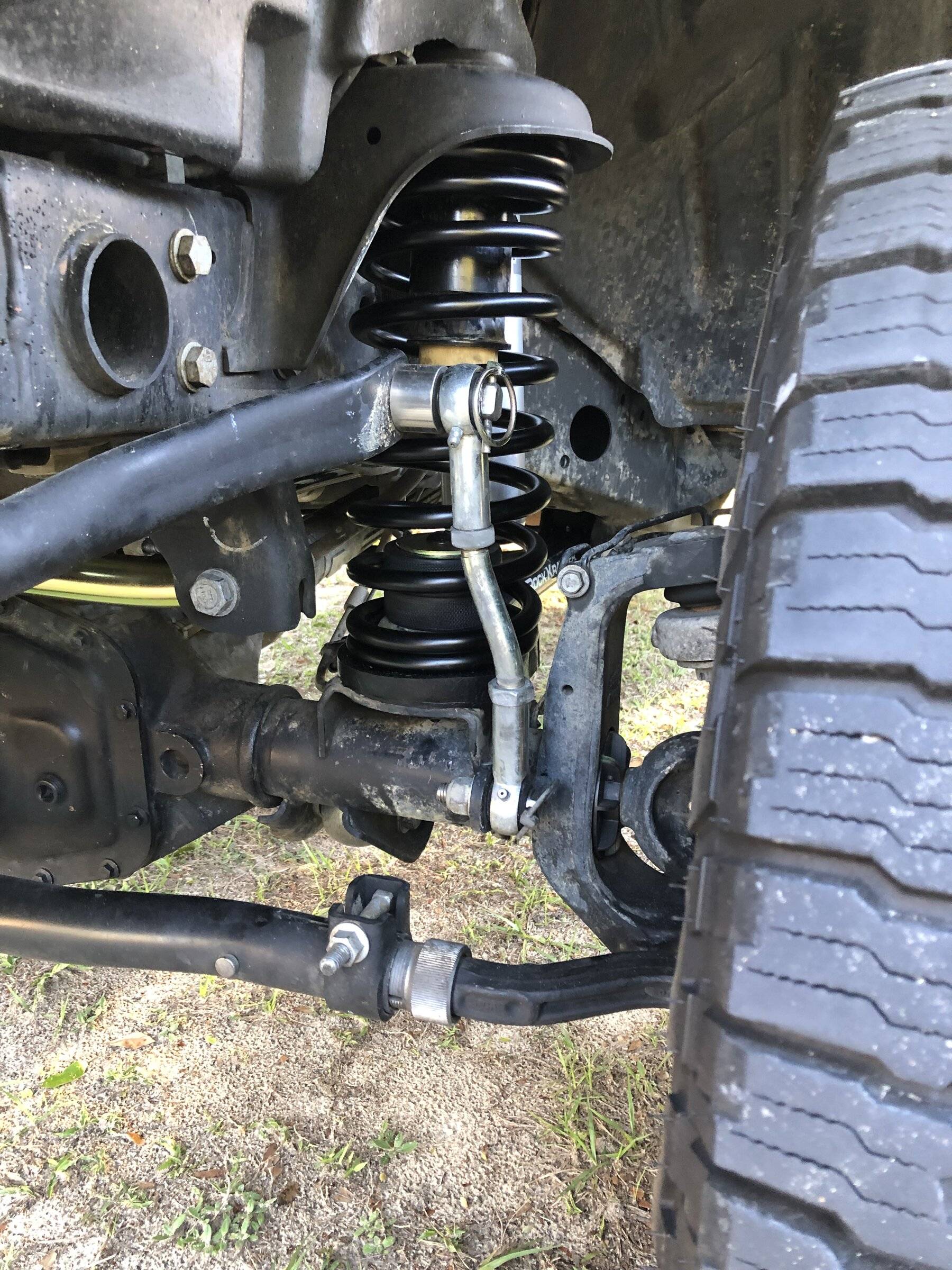

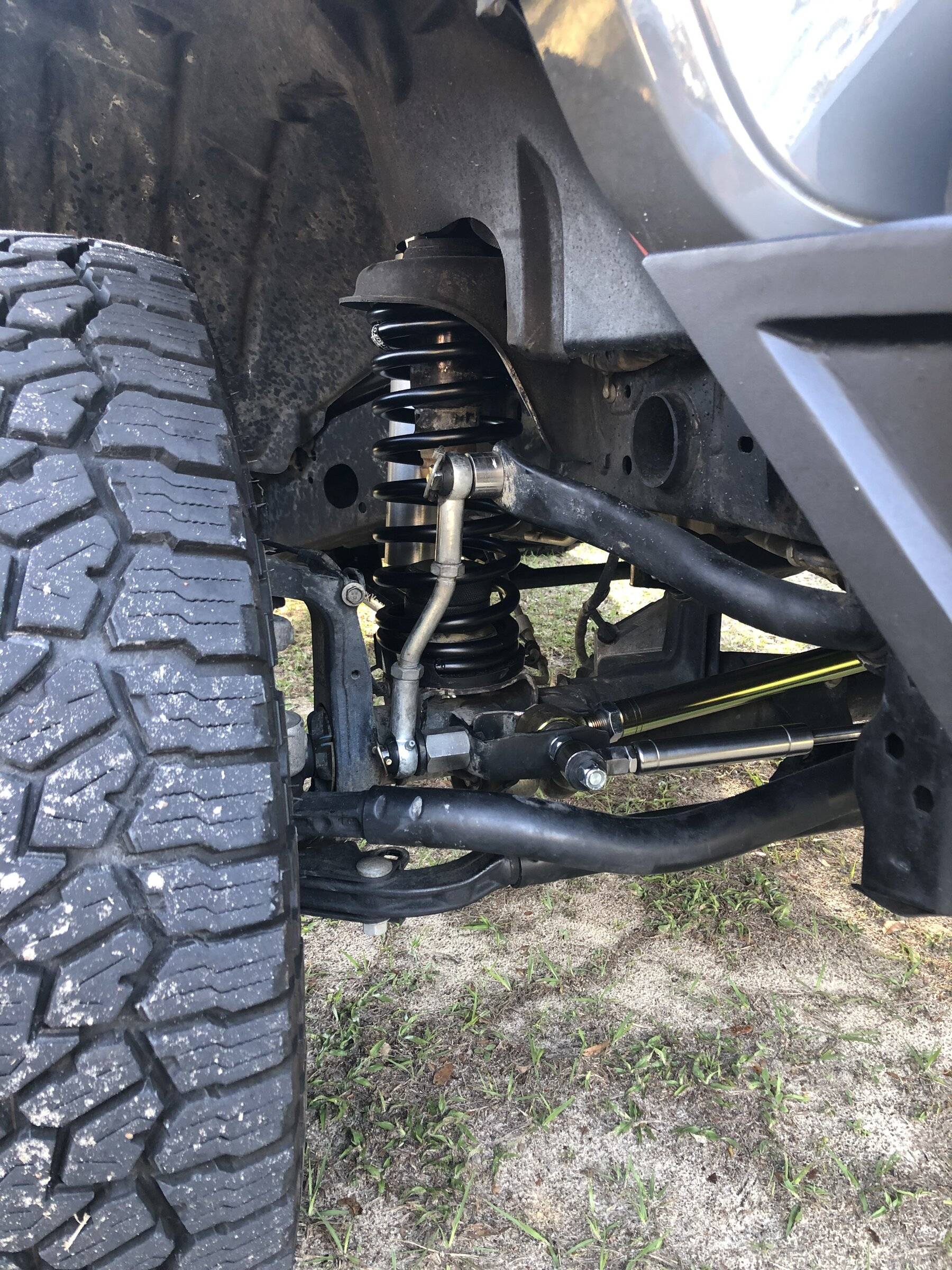

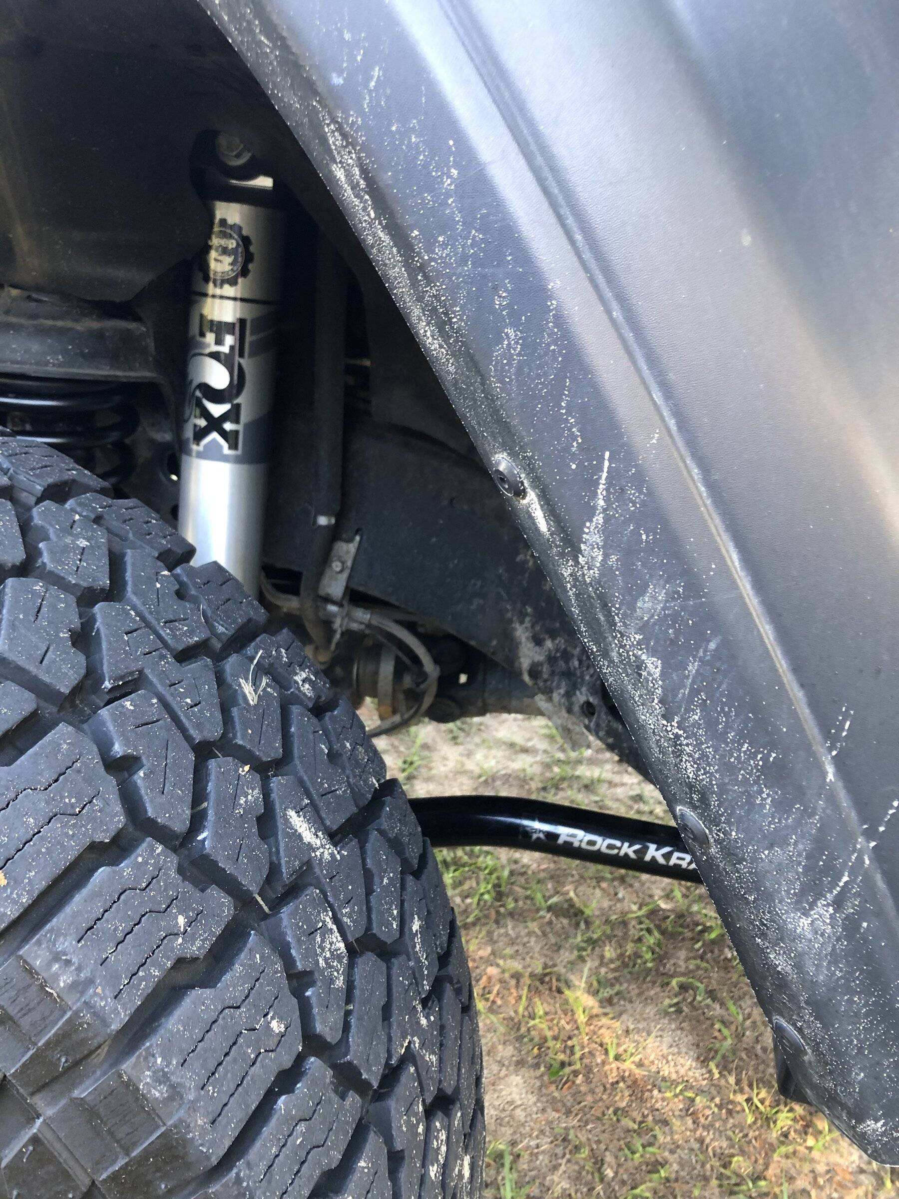

Finished up a 2.5” Rock Krawler XFactor lift on a buddy’s (@DShanesky ) rig…… it’s also the new home for my RK mid arms……. Turned out pretty sweet! He paired the Fox 2.5 Mopar lift shocks with the RK 2.5” triple rate springs. The highway ride is awesome!!
He’s on 33s, but saving up for 35s……. Pix……..
Looks great. Nice work ??. 35s will fit nicely.
