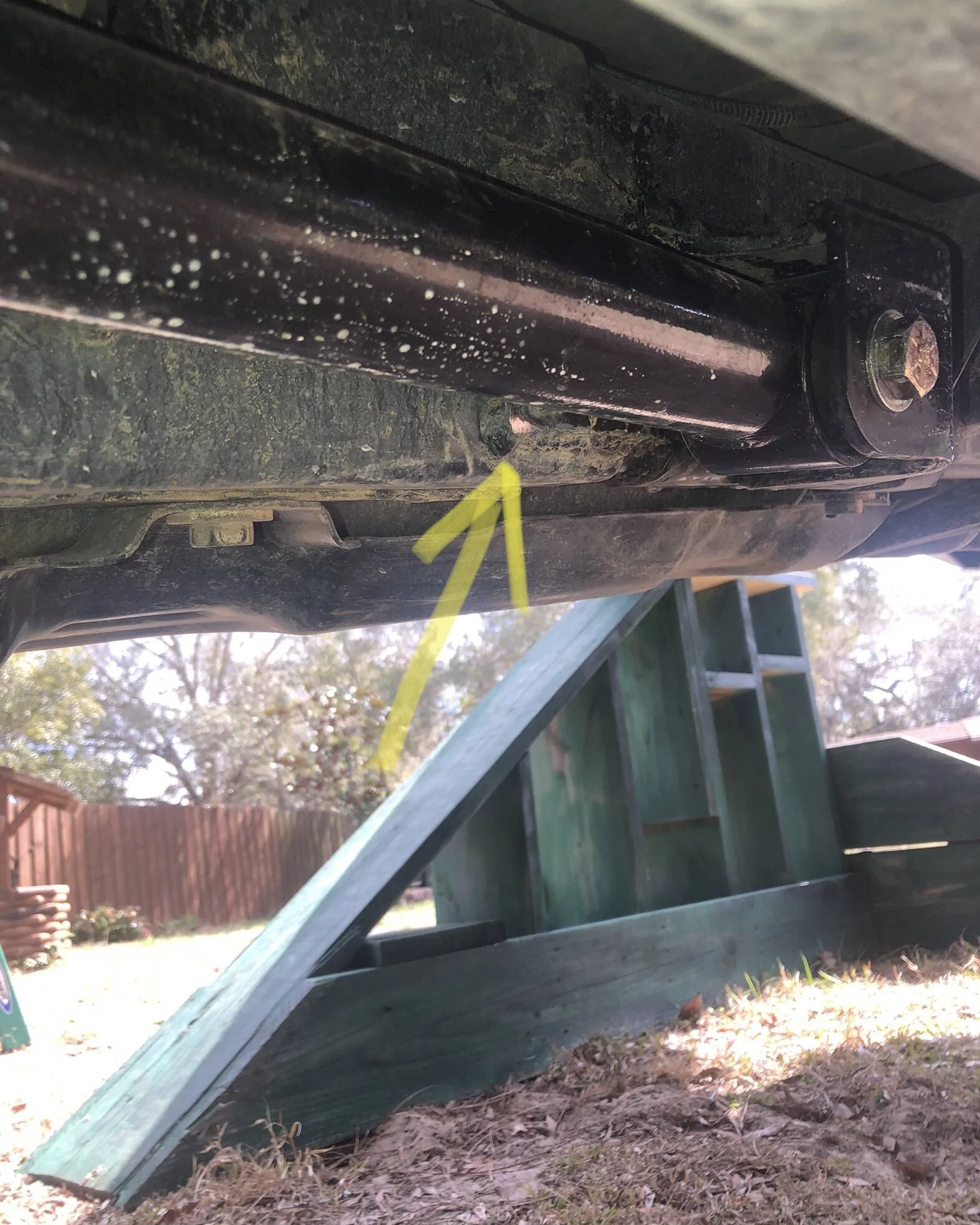

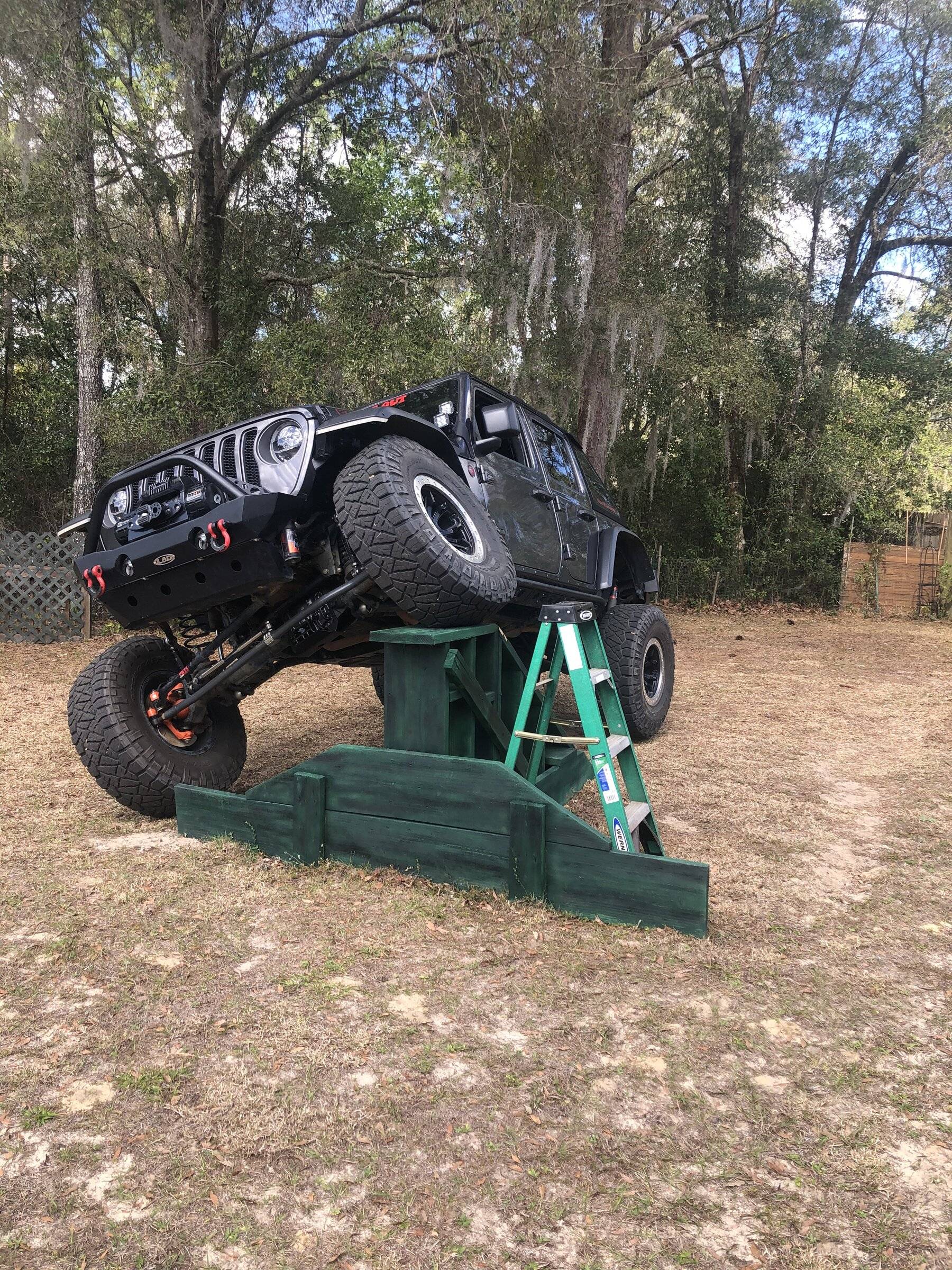

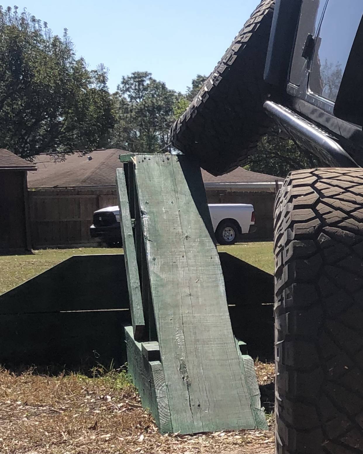

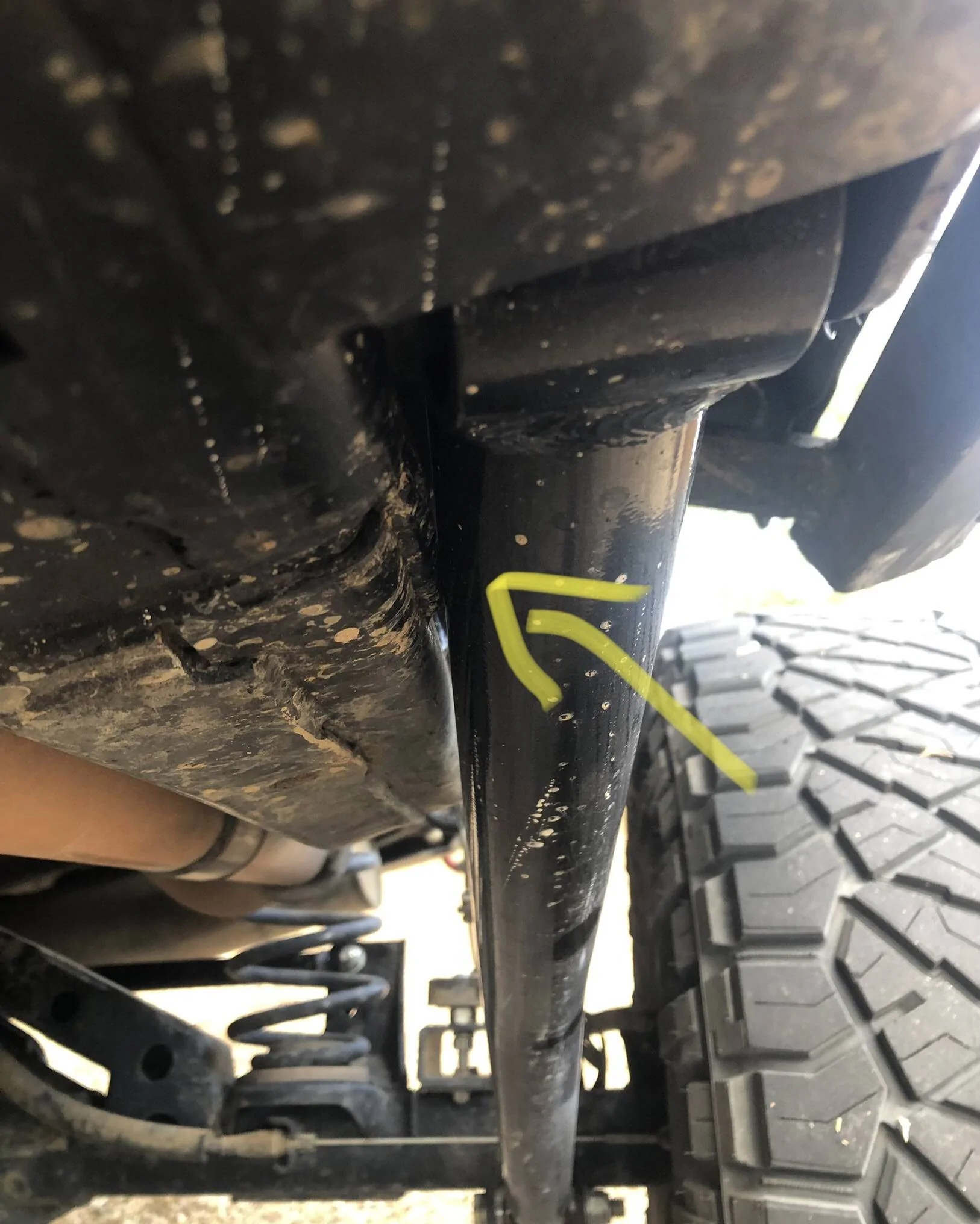

Warning…. This is a long one, you may want to bring a snack…..?
I had the wife drive up the ramp, ( I know ? )…..while I listened for that clunk I’ve been chasing. When your in the drivers seat it sounds like it’s coming from the front so that’s where I’ve been looking.
She did a great job, she didn’t run over me, or drive off of it, had to get the ladder for her though…..? ….
Jeep Wrangler JL Crystal Rubi build… BADAC6F5-ECE1-426B-BC30-2DFEAFEAF2AE

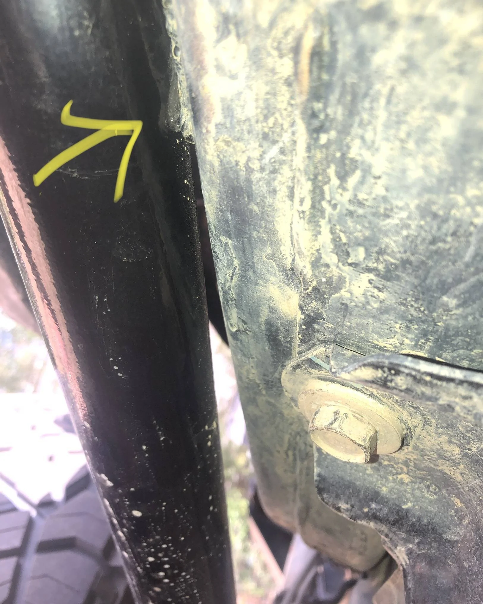

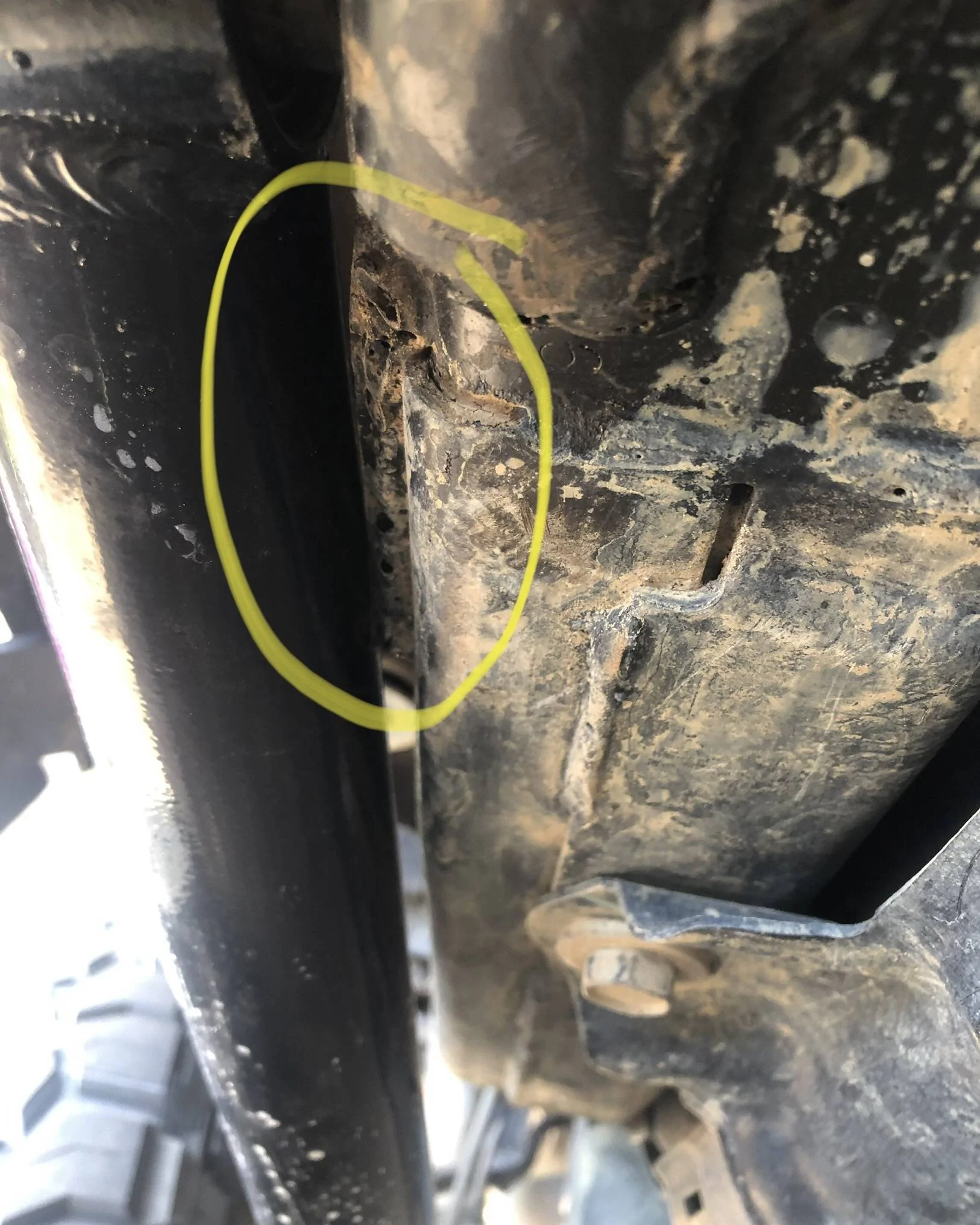

The rear lower control arms are hitting the frame. It’s catching on the weld of the bracket then slides off and smacks the frame.
Jeep Wrangler JL Crystal Rubi build… 7D00153C-F6C2-473A-8C16-8EEA8C9AD821
Jeep Wrangler JL Crystal Rubi build… B2655AE5-06BF-4648-A3CA-33AFFD52263E
Jeep Wrangler JL Crystal Rubi build… 262E20AC-2724-4B0F-B506-8DDFC2A85B0C
Jeep Wrangler JL Crystal Rubi build… D8448908-E8ED-4BE2-8009-B073D84A2936
I sent a PM to Rock Krawler, and an email to Adam with RK just to let them know and so they’re aware of it. Waiting to hear back from them.
I don’t expect them to do anything about it since I’m running long travel shocks with shorter springs, and I’m sure all their R&D was done on lifts with appropriate length shocks, and the coil over rigs have enough height that this isn’t a problem in most applications.
Their fix for this is probably gonna be switch out to straight arms, but that is NOT an option for me. One of the main reasons I went with RK in the first place was their approach to high clearance.
I absolutely love this long arm kit, it’s definitely the best mod I’ve done so far…..if I have to live with that clunk, so be it, at least I know where it’s coming from, which is a big relief cuz not knowing drives me crazy….:angry:

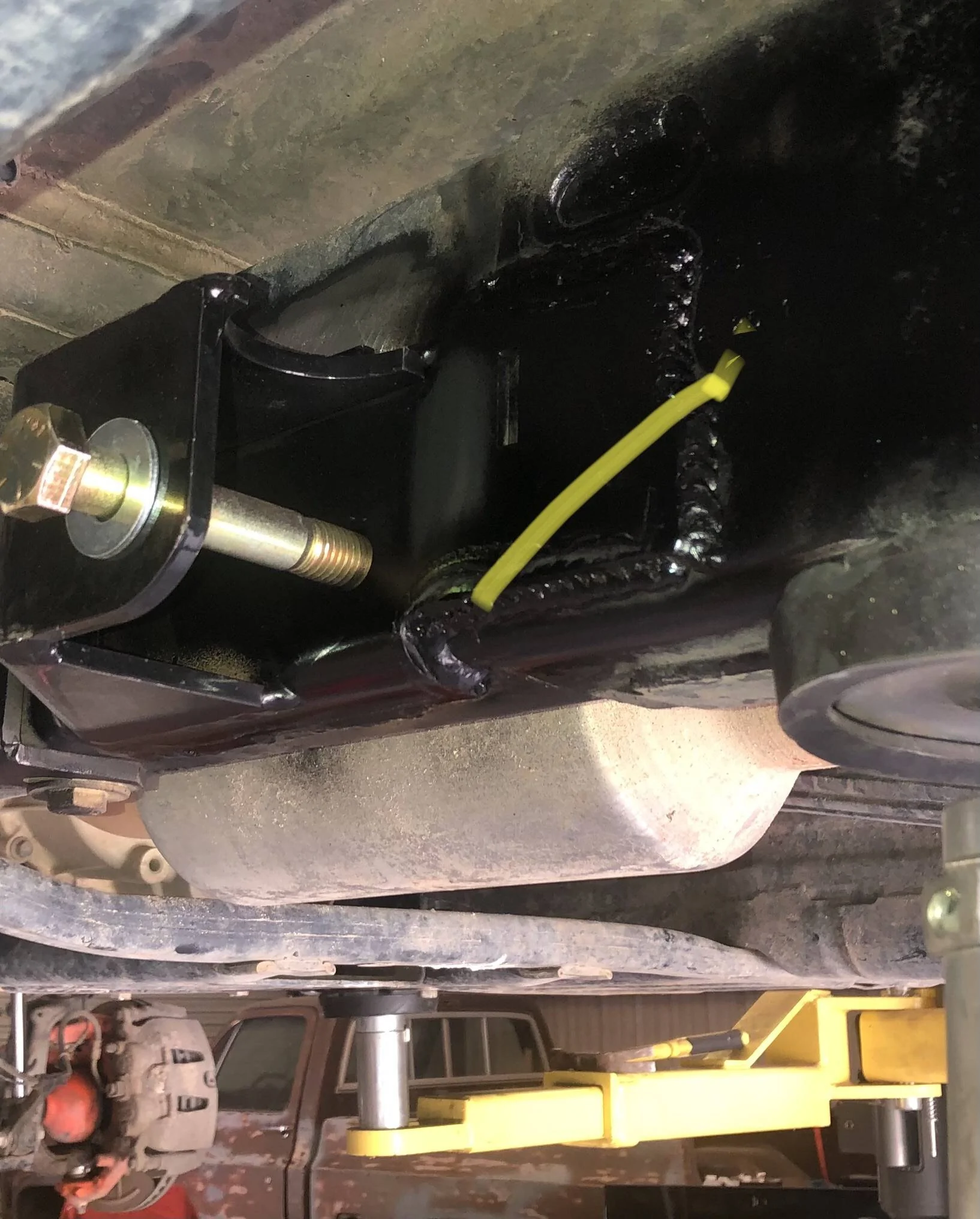

I’m gonna meet up with my buddy that’s a welding guru next week and go over it with him. I texted him pics, and he seems to think we can add some support and clearance out that section of the bracket.
Cut and grind and weld where the yellow line is…..then add support to the front of the bracket
Sorry for the novel………:facepalm:

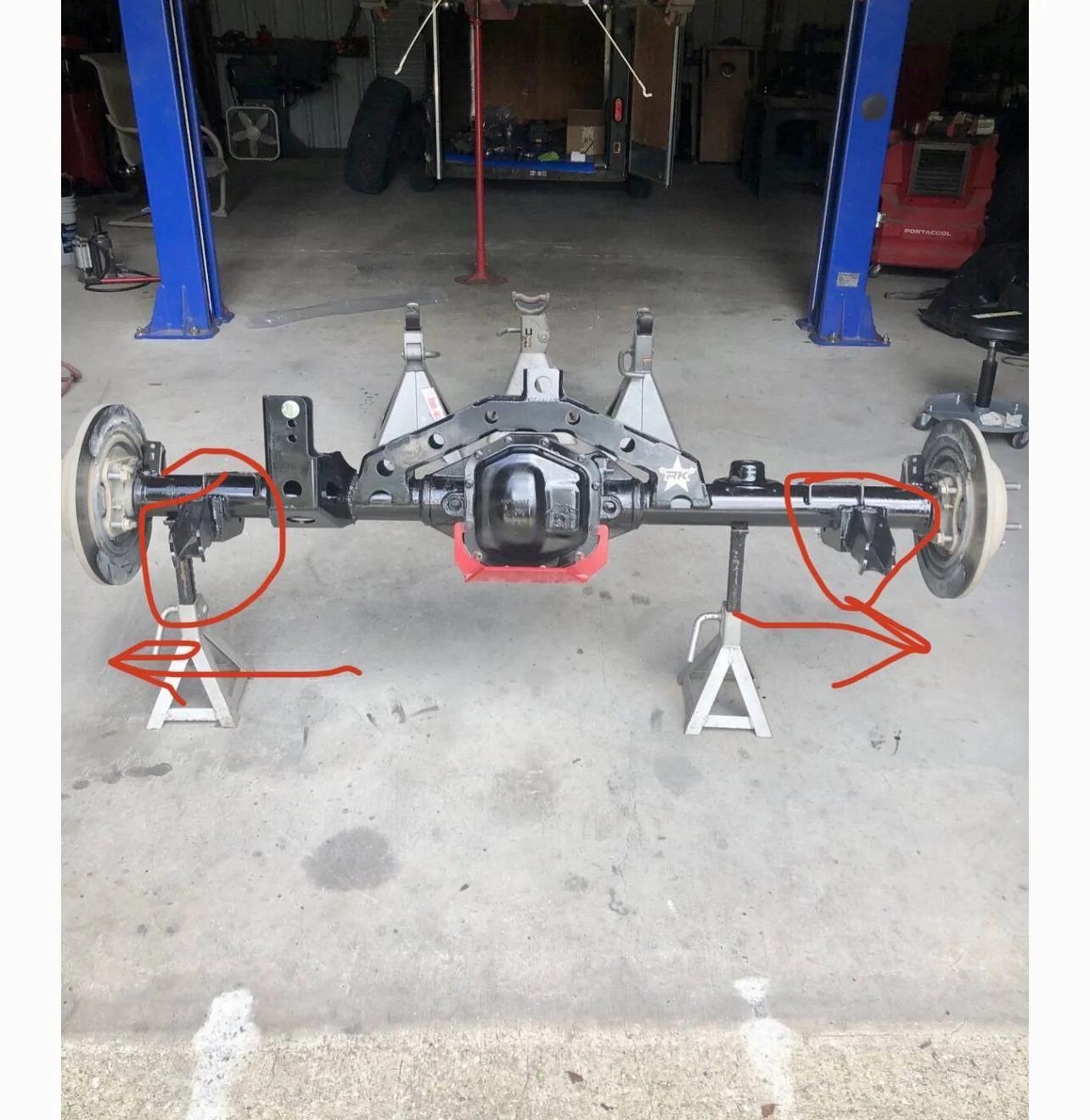

My wife would be “nope, not going to happen” lol. This was not a novel , all the novels are over in exact center thread ??‍♂.
I know this probably not an option for the rear LCAs but could the axle mount be positioned further out (wider)?
Lmao….yeah , I could have went a little closer to the wheel with the mounts, in fact Eric ( motto21) told me to when I was installing.
But the sway bar also hooks to that bracket and I didn’t want them leaning to much. If I was running Antirock sway bar it wouldn’t matter. Also I wouldn’t have been able to go far enough towards the wheel to where this wouldn’t happen.
And the main reason I didn’t put them more outboard is, this was the first long arm I’ve installed and if something came up like hitting the body mount bolts, I didn’t want RK to have any excuse not to warranty something because I changed something from the instructions.
I honestly don’t think they would bail on me but not knowing for sure I wanted to error on the side of caution……
Gotcha. Not ever seeing one of these in person wasn’t sure there would be enough room. Just a thought, never considered sway links in the equation. Sounds like other route considering may be best route ??

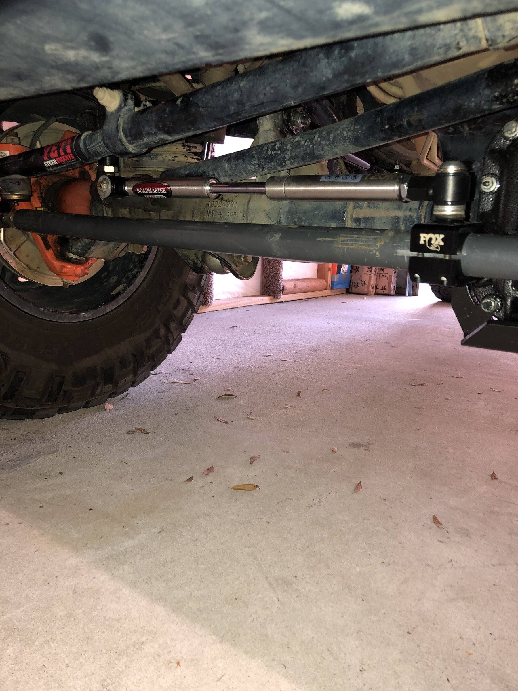

Exact Center review……
I reviewed this in the EC thread but wanted to document it here as it’s part of my build.
I tried 4 different Exact Center stabilizers Saturday, pressures ranging from 67, 87, 110, and 130.
The 67, labeled 75 is a bit light for 37s. It held the center but was so light that I was over correcting trying to keep up with the crown in the road, and going around curves, so IMO don’t even try this one.
The 87 , labeled 100 was real good, it was pretty much identical to the old stock 75 I’ve been running which is really 82 confirmed on scale.
Next the 110 labeled 125, this one is awesome, it was a heavier feel turning off center and getting into the curves was more controlled and I wasn’t as twitchy with the steering wheel. Felt like my Fox ATS.
The last one, the 130 labeled 150. This one is slightly firmer off center and a little quicker return to center but not as much of a difference as between the 100 and 125. The difference is enough to make you think it’s better, but IMO I could run either one of these last two and be happy with it.
I’m going to test the last two off-road and see if there’s a discernible difference. If not then I’ll have to figure out which one I’ll end up with.
My final thoughts on this is that the EC unit is BADASS!! If you’re running 37s and up I recommend using the 125 or 150 psi units, if you like or are used to a heavier feeling steering wheel, if you like a light steering feel, then the 100 will work, but I would suggest not going below 100 with 37s and up……..
