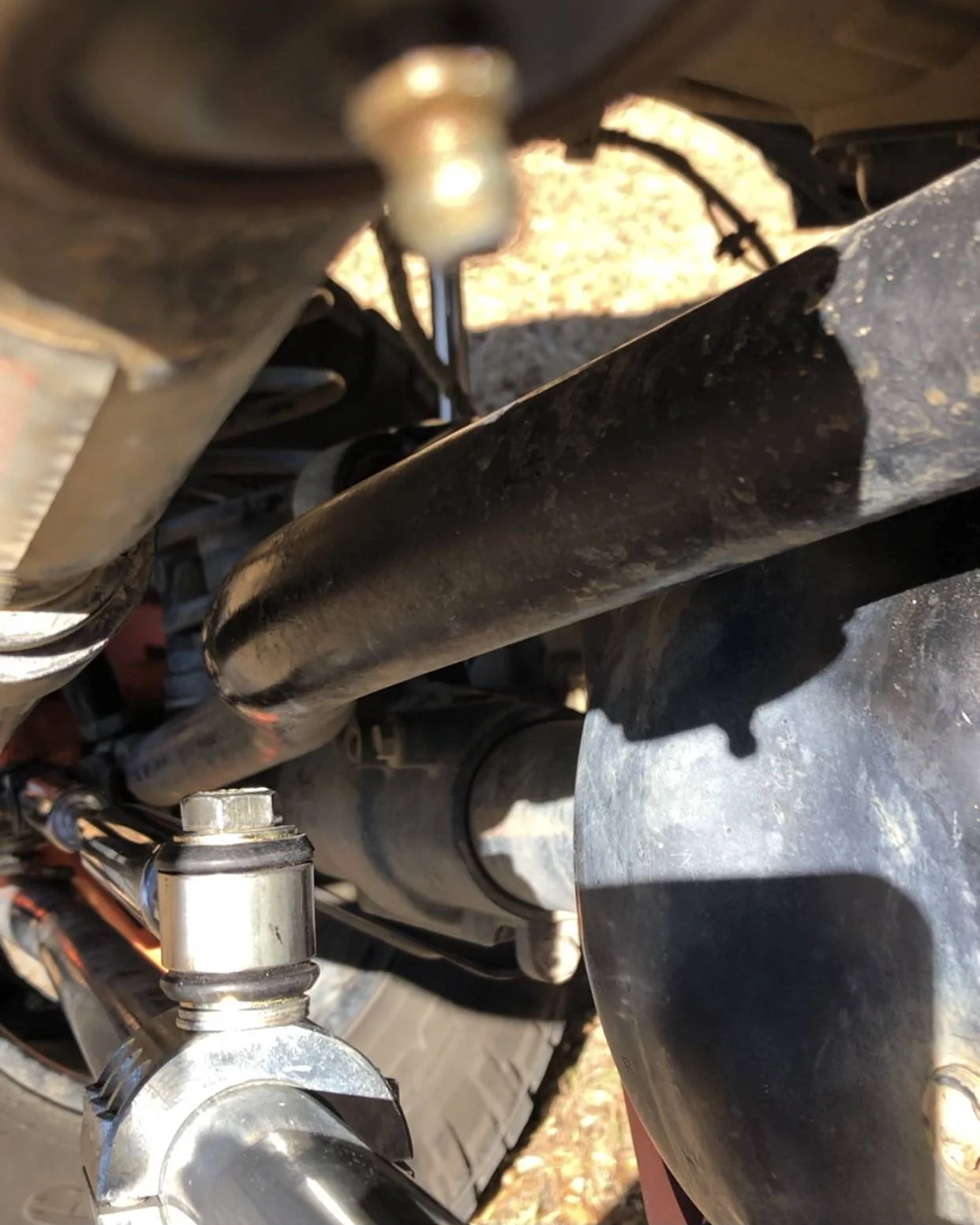

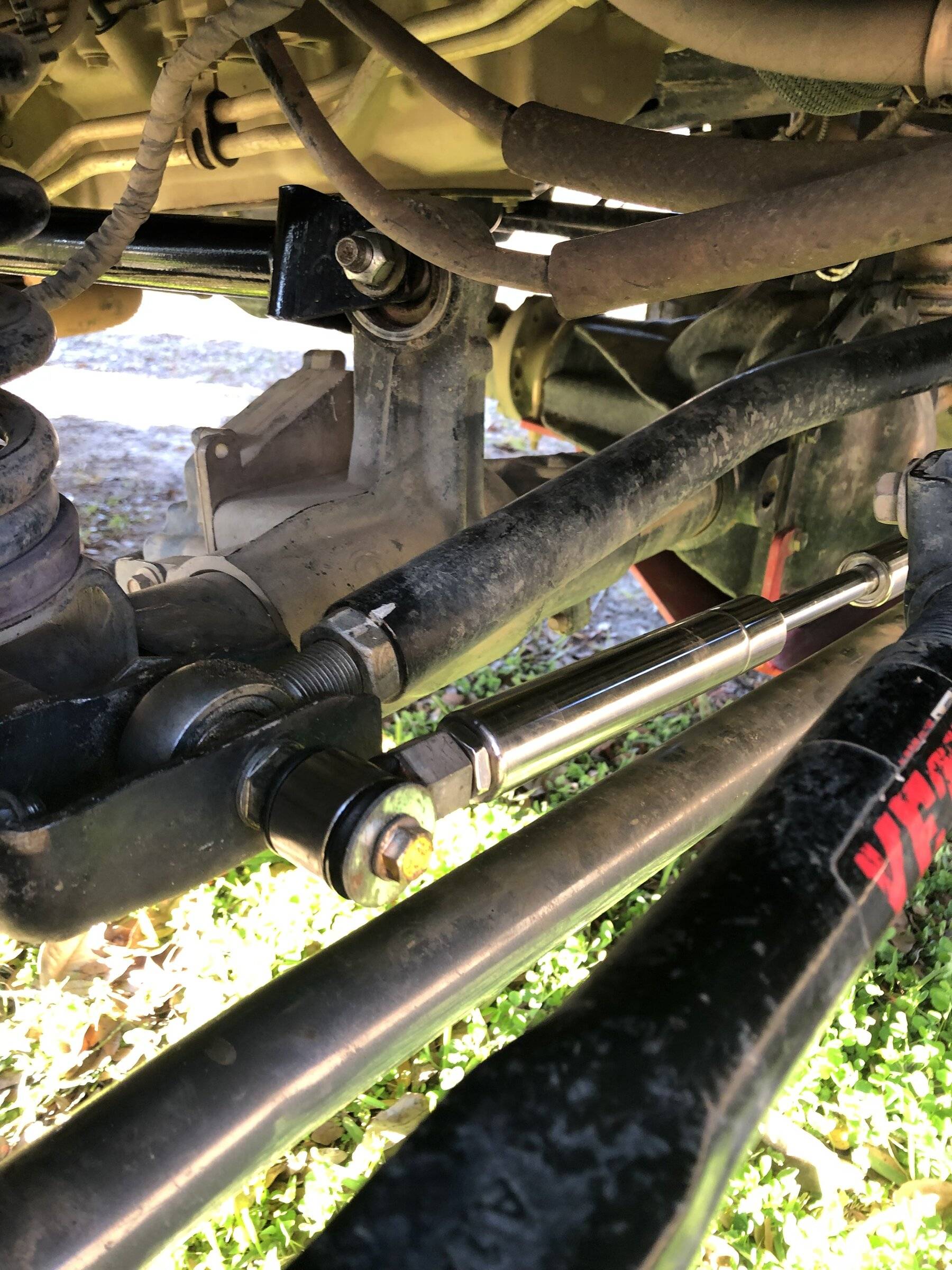

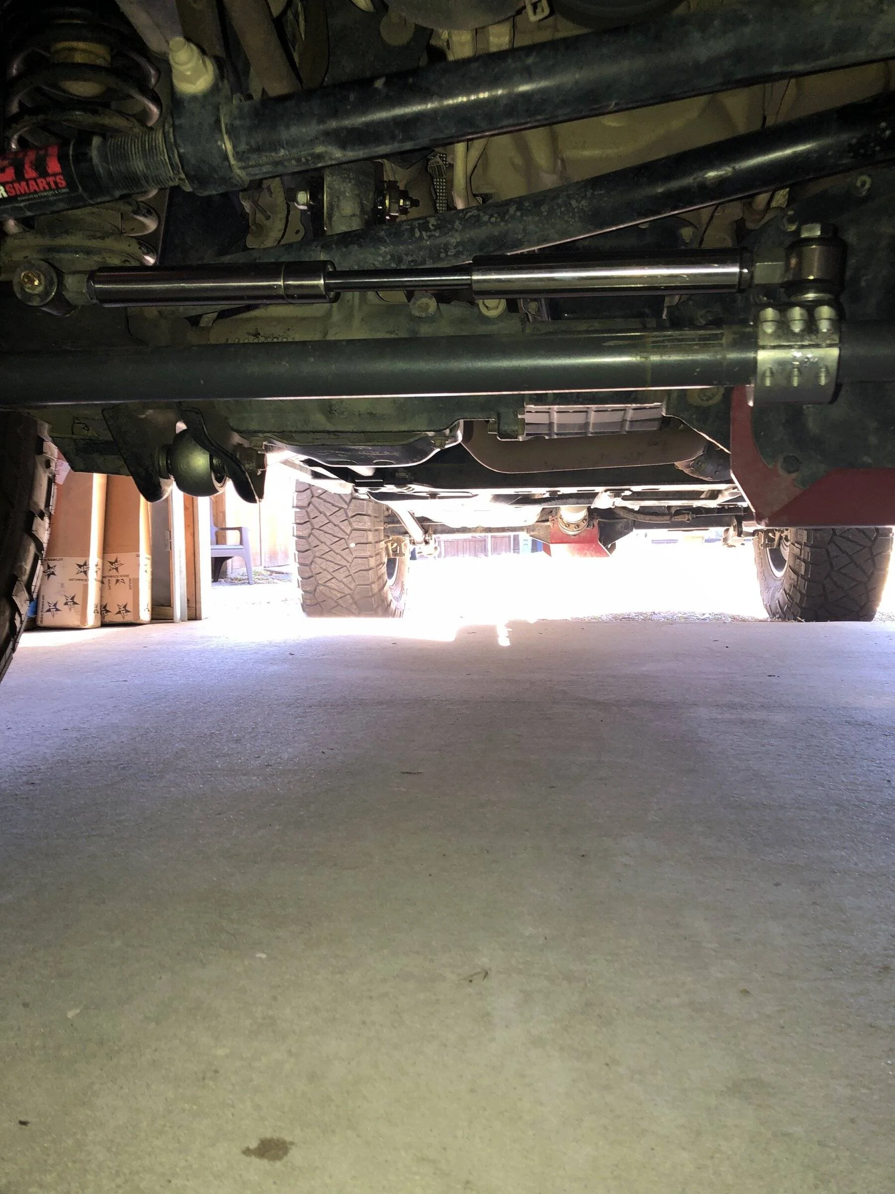

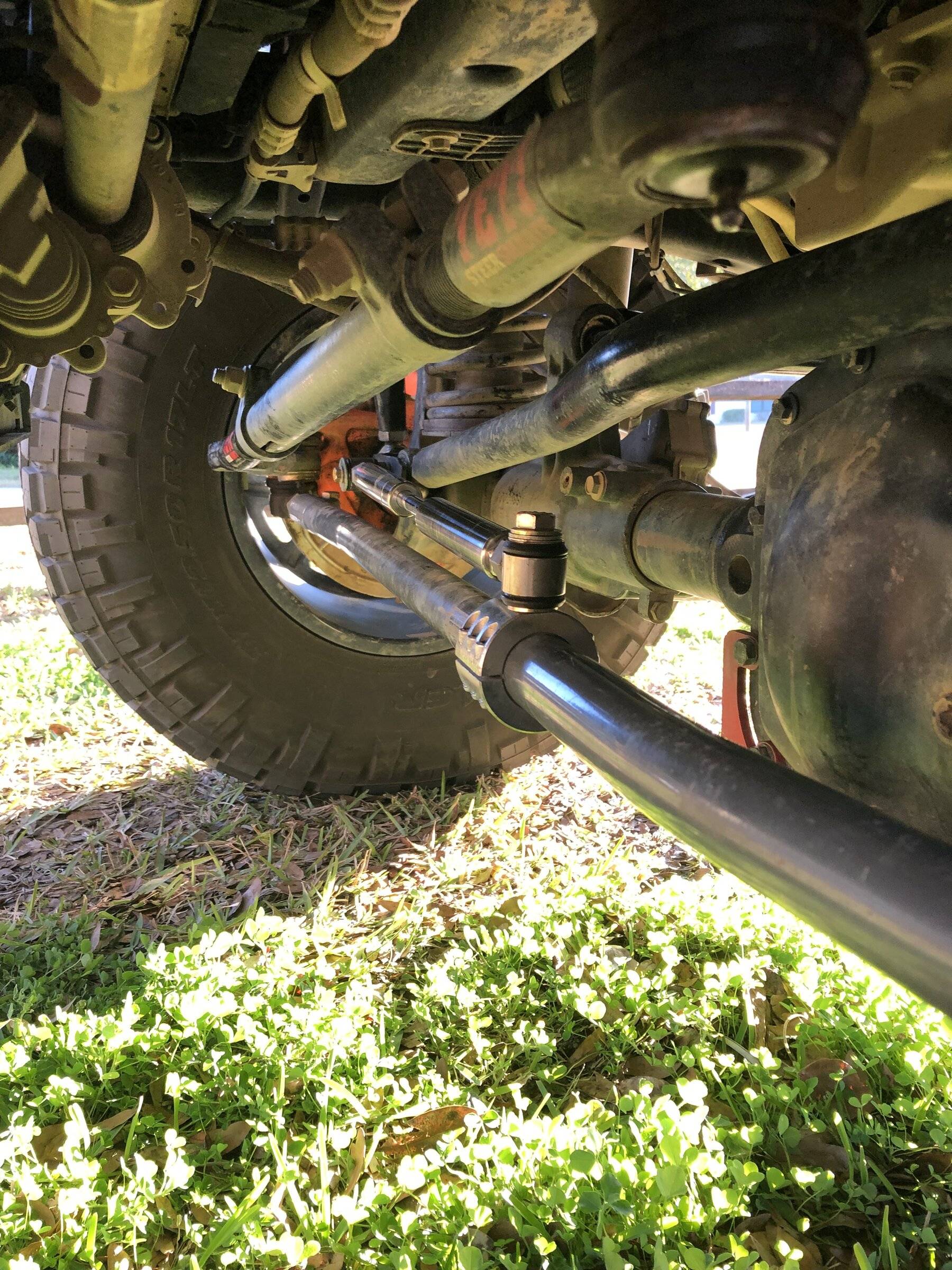

Initial thoughts:
So I was fortunate to be asked to try this prototype, nitrogen gas based unit, in place of my steering stabilizer. This thing is pretty sweet! It’s a device that holds the center on your steering wheel. It returns to center after making a turn, but doesn’t spin the wheel out of your hand or anything like that. It just holds the center.
I like a heavier feel to the steering wheel, so for me it took a little getting used to. With this device the steering is lighter, but stronger. Hard to explain and I’m probably not explaining it right, but the steering wheel doesn’t move driving down the road.
Also what I noticed the quickest was driving in the wind. You still feel the wind hit your rig, but the steering wheel doesn’t move so you don’t over correct……
Over a rough road where I would usually make small corrections, there’s none of that with this. Steering wheel is stone cold silent, not even a twitch. I took it down a pot holed dirt road that leads into the woods at about 30mph, with hands off the wheel, and the steering wheel didn’t move. It would move slightly, maybe a quarter to half inch over the deeper holes, but returned back to center. Remember this is without me holding the wheel.
No bumpsteer, no DW, nothing. I’ll try and get some video later this week or weekend. Now to be honest my Fox stabilizer keeps my steering wheel pretty still as well, the difference being I have the pressure turned up on it to achieve close to the same result.
All in all, this is something I would, and probably will run on my rig. I’m still learning about it, and figuring the best way to mount it and such…….

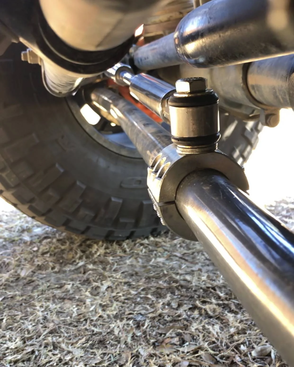

Right now I have it attached with the Synergy steering stabilizer relocation kit. It has a track bar bolt and a tie rod clamp.
This how I have it…….
Jeep Wrangler JL Crystal Rubi build… 2272B2B2-ADEA-4B75-B242-B12E9CD4736A
Jeep Wrangler JL Crystal Rubi build… FB0B1219-BF24-40EA-BF4C-FBA17B0996AB
Jeep Wrangler JL Crystal Rubi build… 024E6301-ADE0-4D8C-A31C-EC8B79649686
I have a Steersmarts axle bracket coming so I can rotate the axle side eyelet 90 degrees, with the bolt, it’s in a slight bind, not bad though, I wouldn’t even change it if I wasn’t testing……….
I also checked clearance with the track bar and diff. I stuffed the wheels 2 different ways, and I have plenty of room, although I am still going to pick up a flathead bolt, just for a little extra assurance…….

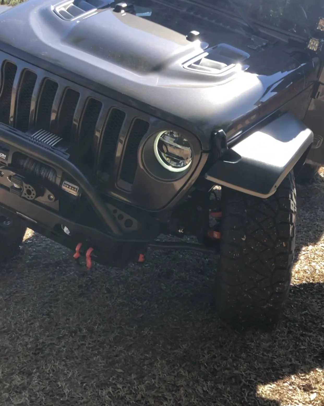

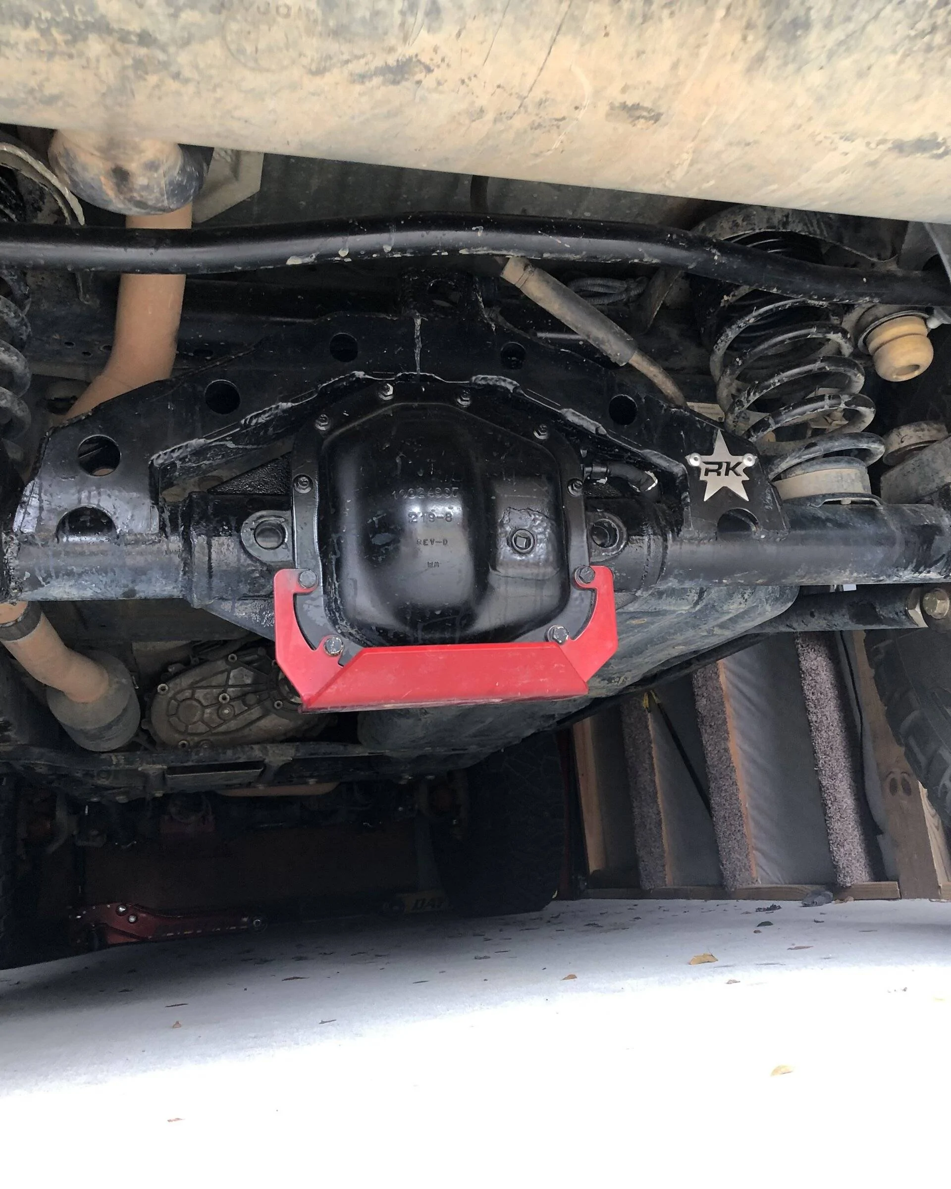

A little vanity mod today…… I’m over the red skid, so put some hammered black rattle can on them, and put on some classic Dana covers ………..
Before/after….

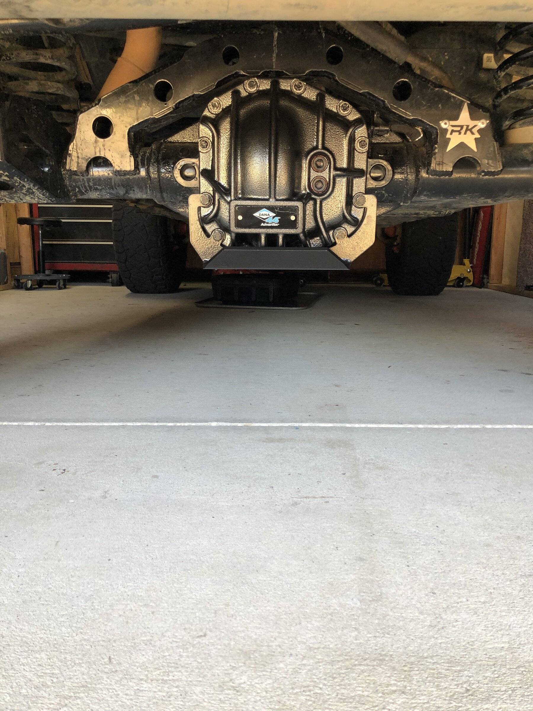

The Mopar 2” lift.......
I’ve installed over a dozen Mopar lifts over the last couple years on the JL. For whatever reason ( probably anticipating added weight ) the Mopar lift gives more than 2” of lift and they don’t include the parts to make it as it should be.
The best way to tell exactly how much lift you get, if you’re able to, is to measure from the top of front axle to the bottom lip of the upper coil spring housing before and after lift, the difference is how much lift you actually get .......
When you get more than 2” of lift your caster is decreased and your axles shift, front to the drivers side and rear to the passenger side. Because everything on the alignment read out doesn’t show anything out of spec, that’s how they justify not adding parts to the lift kit.
Now you can drive it as is on the highway or light trails without issues. But if you’re gonna be off-roading and want it to drive better on the highway then you need to add a few things to the kit, the brand is up to you....
1 - front adjustable track bar to re-center the front axle.
2 - rear track bar relocation bracket if you want to keep factory rear track bar or an adjustable track bar
3 - front lower adjustable control arms to increase your caster ( around 6 or a little more is optimal ) to minimize if not eliminate wandering on the highway.
4 - front lower RK coil spring isolators. This is optional depending on how much spring bow you got and how hard you wheel it, the ones in the kit can collapse.
Some don’t care that things are a little off and are using the kit as is which is fine. There is no real ill effects short term but long term I think the factory lower control arm bushings will wear faster being in a slight bind. Again, this is in more extreme cases.
I have no science to back that up , only a couple guys that came to me a year and a half later with worn bushings. This could also be it’s just the way they use their rig, I don’t know. But I won’t install anymore Mopar lifts if the customer doesn’t have these extra parts with them........
Here’s some pics of a more extreme example........
You can see the axle shifted
this axle was over an inch off...
Here’s a collapsed coil isolator
Again this is just a guideline to what to look for and address if you have some of these issues with your Mopar lift. IMHO, if you do these few things you'll enjoy your lift a lot more............:)
