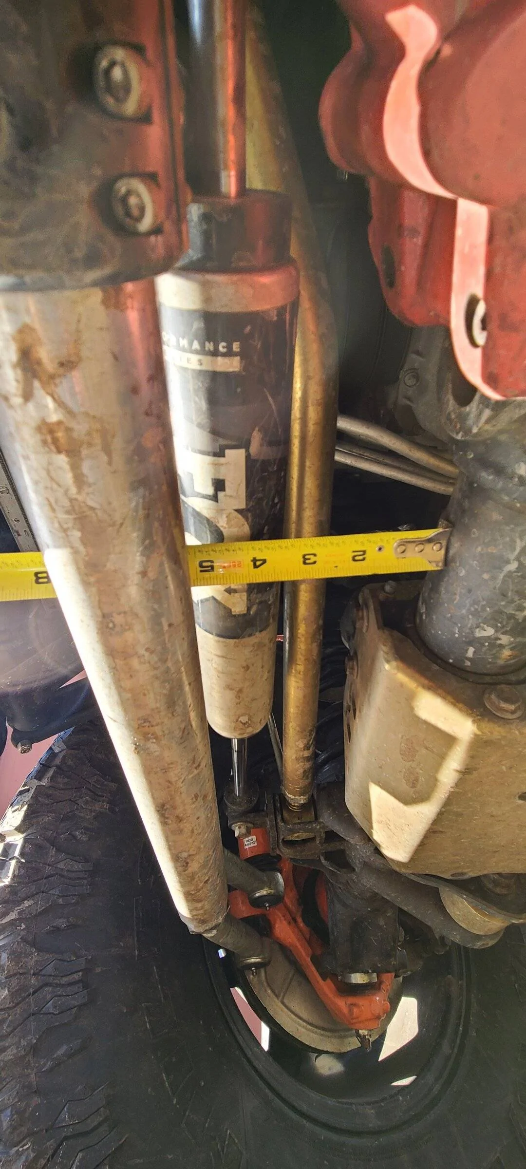

Apologies for the delay buddy!
I'm getting 5" of air space between the backside of the tie rod and front edge of the axle tube, with the wheel turned full driver. I haven't yet trimmed the Reid knuckle steering stops, so I'm guessing it might drop to about 4.5".
Let me know if you want any other measurements or pics.
