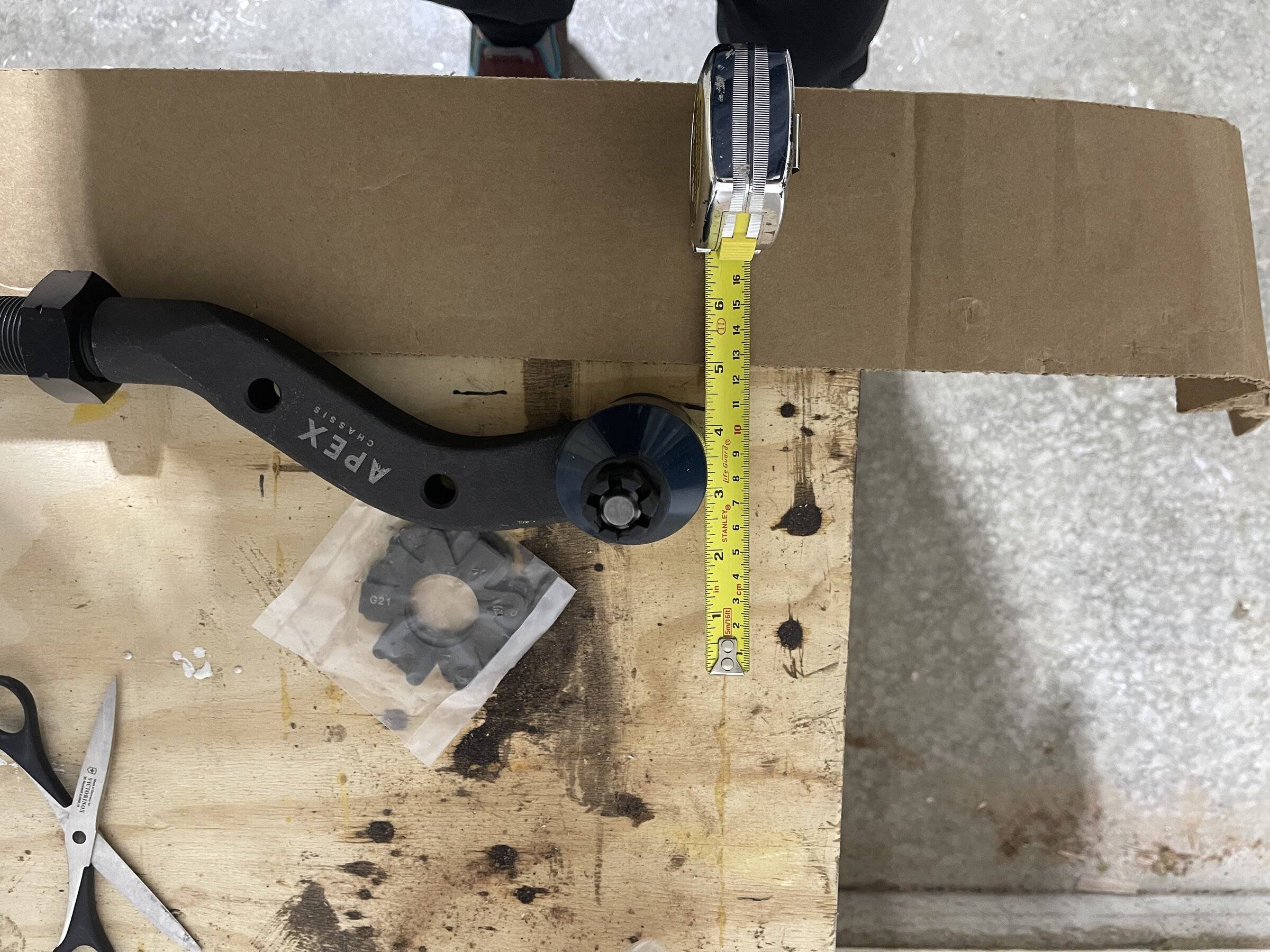

Picture courtesy of my wife ;)
Looks like 1 3/4" from center of threads. You will loose 1" of that due to AL rod diameter, or 0.875" if you go steel rod (I went steel rod as this is what they recommended for something that sees a lot of highway miles)
Awesome, thanks, and thank the wife for me….. I don’t need much, 3/4t to 1” should be plenty….
