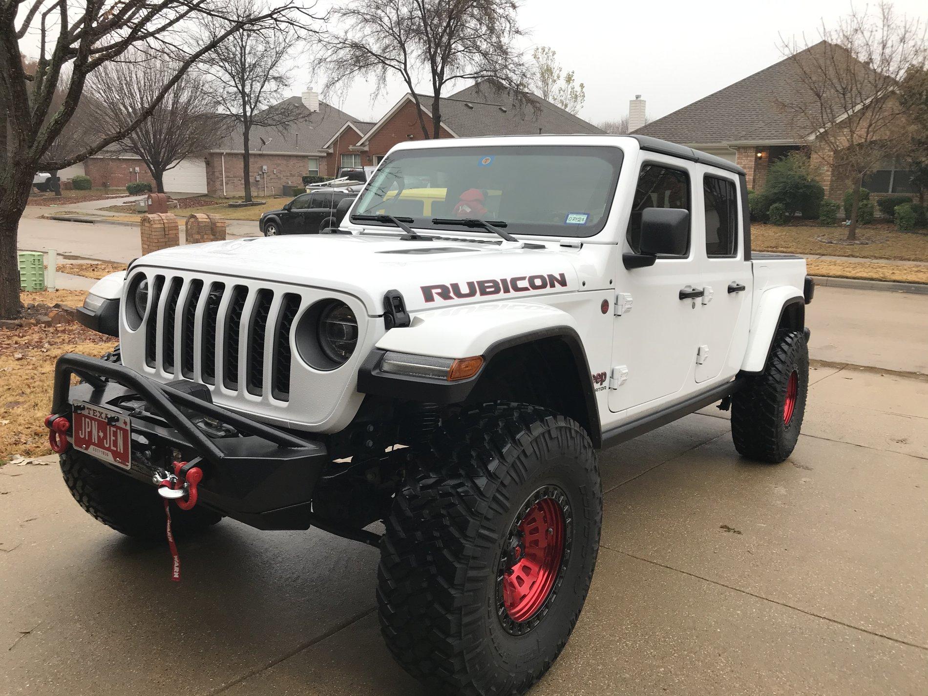

The Trail Grappler is a great tire too. Wife has ran them on multiple Jeeps, including her current Gladiator, and never had a problem.
aren't those loud ? i had those those tires on my truck about 9 yrs ago and they were so loud
