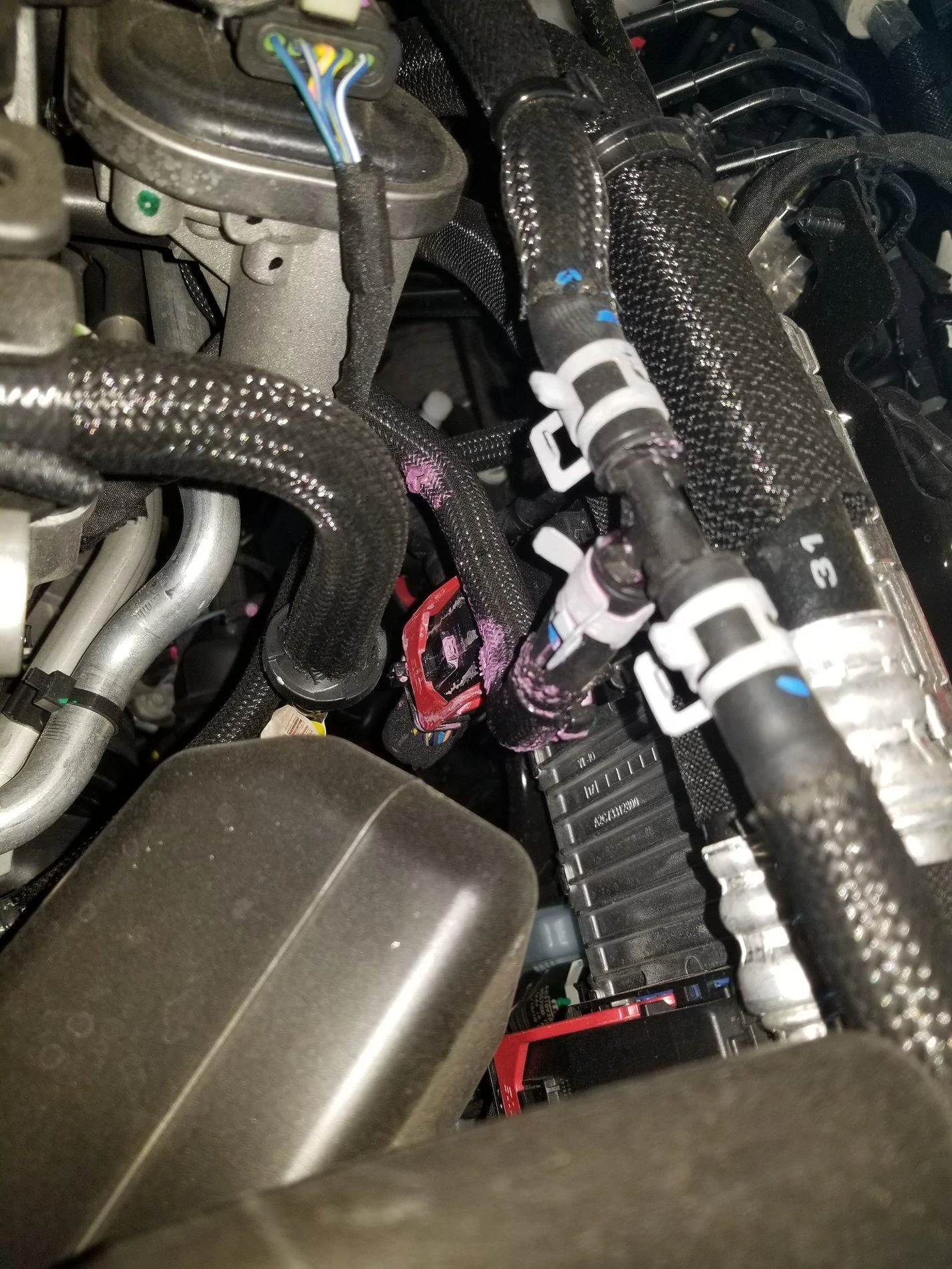

These small diameter spring clamps are weak, can't be tightened. Easy for robots to install.
I understand, would you recommend the type we have on our air intake? If you could link me to the type you recommend I would be hugely appreciative

Have you been monitoring your coolant temp? Those fitting shouldn't leak under normal circumstances and normal pressure. If your coolant is getting too hot it will increse pressure which could cause it to leak through the fittings.
Normal hose clamp just get the proper size something like this. A solid band is better compared to a band with slots. This was on Autozone
thanks ill give this a shot today
