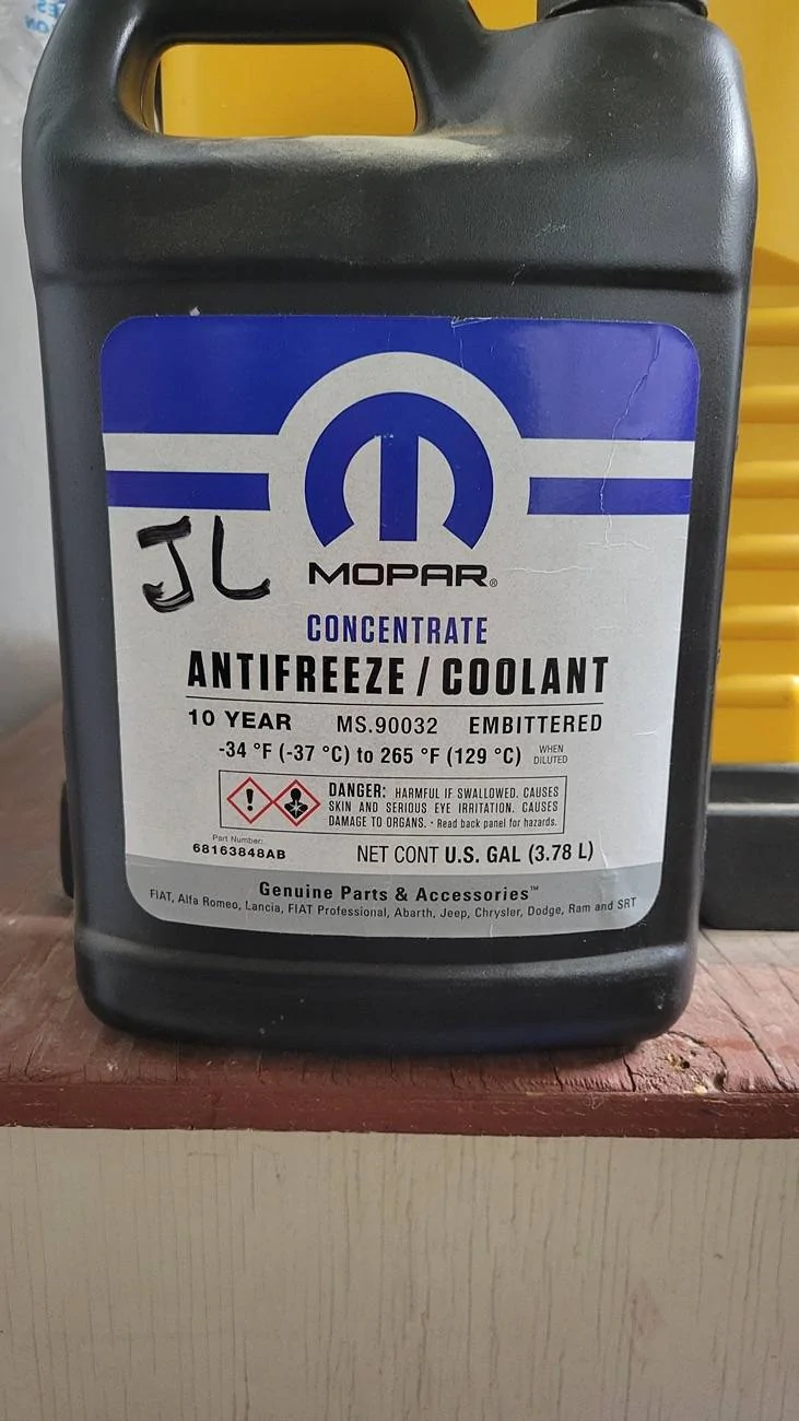

Thank you! Last thing, what coolant do you recommend?
