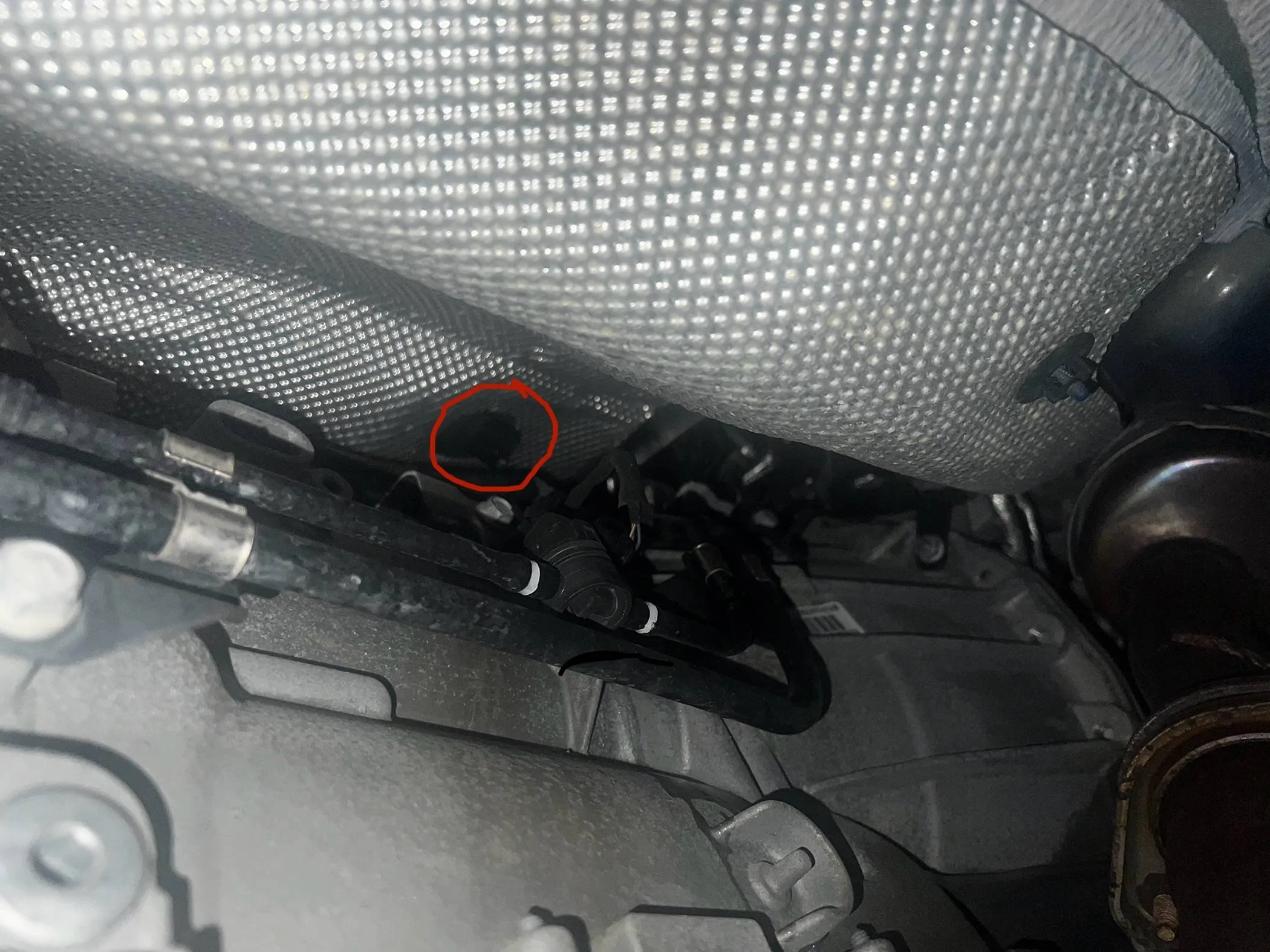

Lucky me after buying a used 2018 JLUR I turned on the heat and instant coolant smell. The reservoir was almost bone dry. I refilled it and plan to watch it over the next few days. The carpets are dry but as soon as I turn on the blower for heat or A/c a drain over the transmission starts pouring water instantly. My thought is still heater core but would love some input. I really do not want to remove this dash.

Your short video just looks like condensation, normal for the a/c. Try running the heat on the floor without the a/c on, see if you get the same result. Is this a 2.0? There was a TSB for the water pump bolts.

It’s a 3.6l. This flow is the same heat or A/c and starts flowing immediately. Just with the heat comes the smell of coolant. As soon as turning off the blower the flow stops.

That's pretty normal. That's exactly what it's supposed to do. When your AC is running, it produces condensation. I'd dare you to find a vehicle that doesn't leave water underneath when the AC starts running. Good luck, you're going to need it! ? ;)
As an added note, to lessen the amount of humidity that the heater produces when you turn the heat on, most modern vehicles will initiate the AC as well to dry out the air coming out of the vents. Last thing you want when you're trying to defrost your windows is to create more humidity to freeze on them.
Depending how hard your AC unit is working, will differentiate the amount of condensation dripping.
Sounds like you fixed it by adding the coolant. Probably good idea to just keep an eye on the coolant levels like you were saying. One of the downsides of buying used vehicles is you never know exactly why they traded it in. ??‍♂
There is a possibility your heater core has a small leak in it and coolant is getting into the vent system. If that's true... Best of luck to you! The heater cores on these Wranglers are NOT easily accessible. I've always figured if my heater core goes, I'm just going to remove the fuse and freeze all winter! I'm not about to pay some shop $2,000 to tear apart my dash just to get to the heater core and replace it.

Just so know you literally have to remove the entire dash to access it. So you're going to be looking at a very pricey fix if your heater core is leaking.

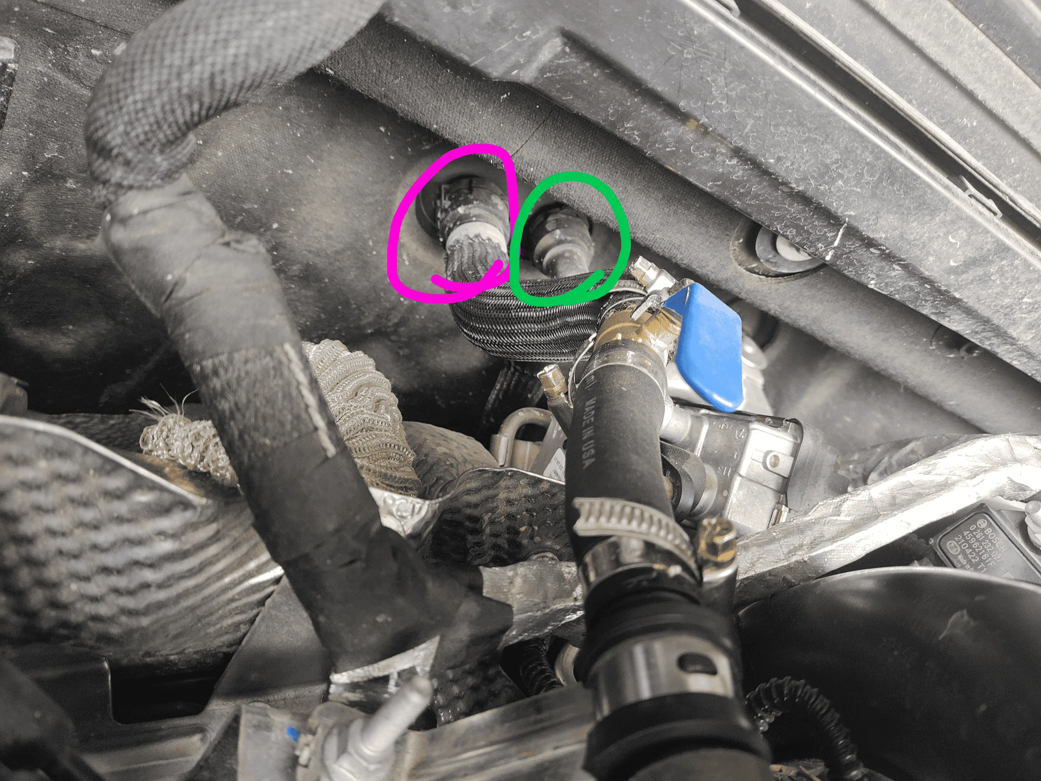

I don't know if it will help you at all, but here's the location of the heater core inlet and outlet pipes...
Mine's an EcoDiesel, but the 3.6 l should have the same heater core location I believe.
Jeep Wrangler JL Coolant issue! Heater Core? IMG_20240506_095426048
Jeep Wrangler JL Coolant issue! Heater Core? Screenshot_20240506-095516-193
The pink circle is going to be your heater core inlet, and the green circle is going to be your heater core outlet.
(You can ignore the little blue handle on my heater core inlet, that was a stupid mistake I made which could have killed my Jeep, but you know f*** it why not!)
Not sure how exactly you would test to see if there's leak in the heater core other than monitoring coolant levels. Maybe you should run your heater for like 30 minutes or an hour in your driveway and see what happens with the coolant levels.
Because of the firewall in the engine bay, if you smell it only when the blower motor is running, there's a good chance you're concern is accurate and it's inside the cabin, the leak that is. If you smell at all times it's coming from in the engine bay more than likely.
I hope this helps somewhat. Hopefully there's some smarter people on here than me who have better knowledge of the heater core. I've only recently started messing around with things in the engine bay of my EcoDiesel.

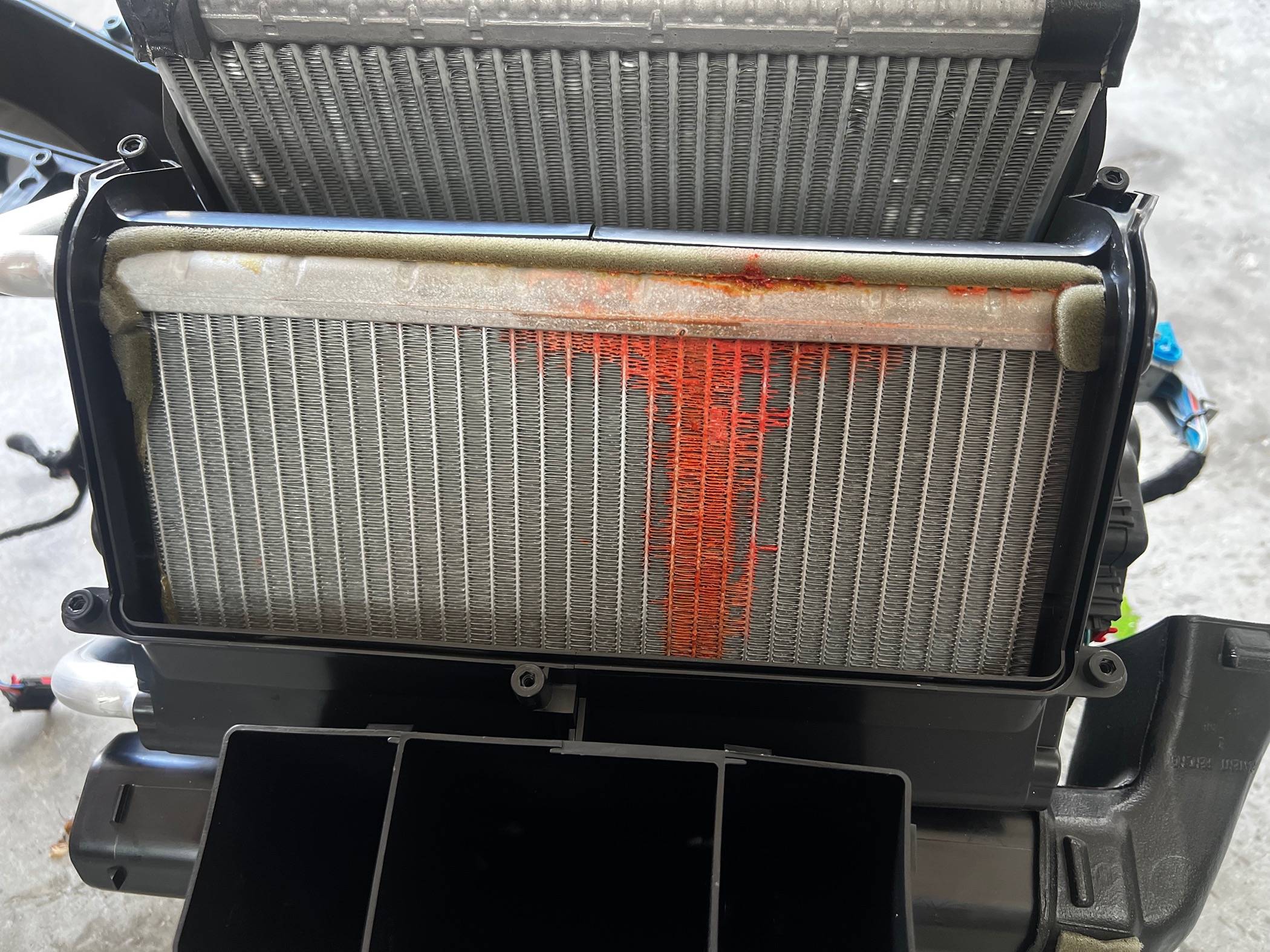

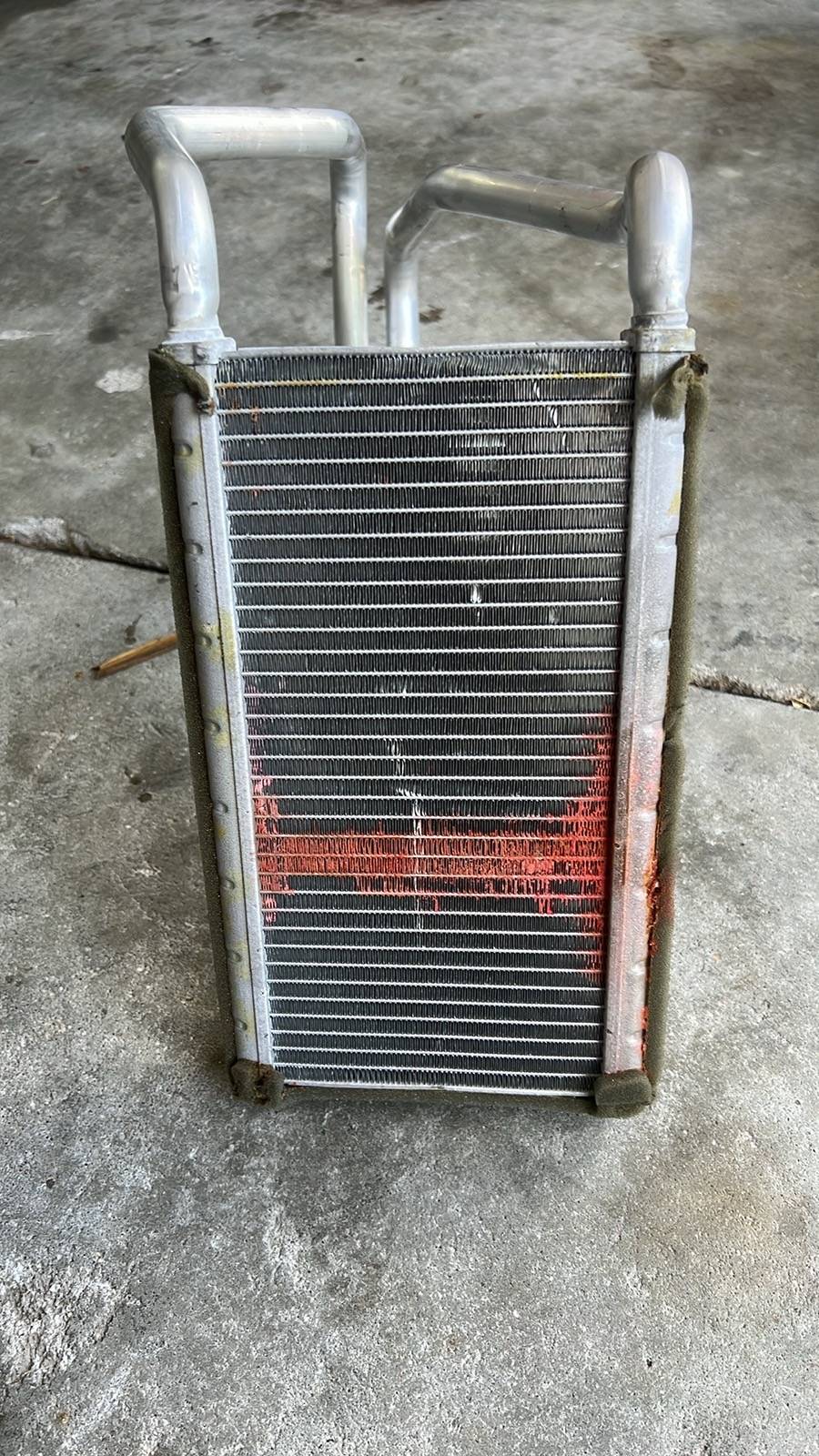

After a 15 mile drive coolant level has already went from max to below minimum. I can’t find the coolant anywhere and oil level is normal. Sounds like it’s time to start removing this dash

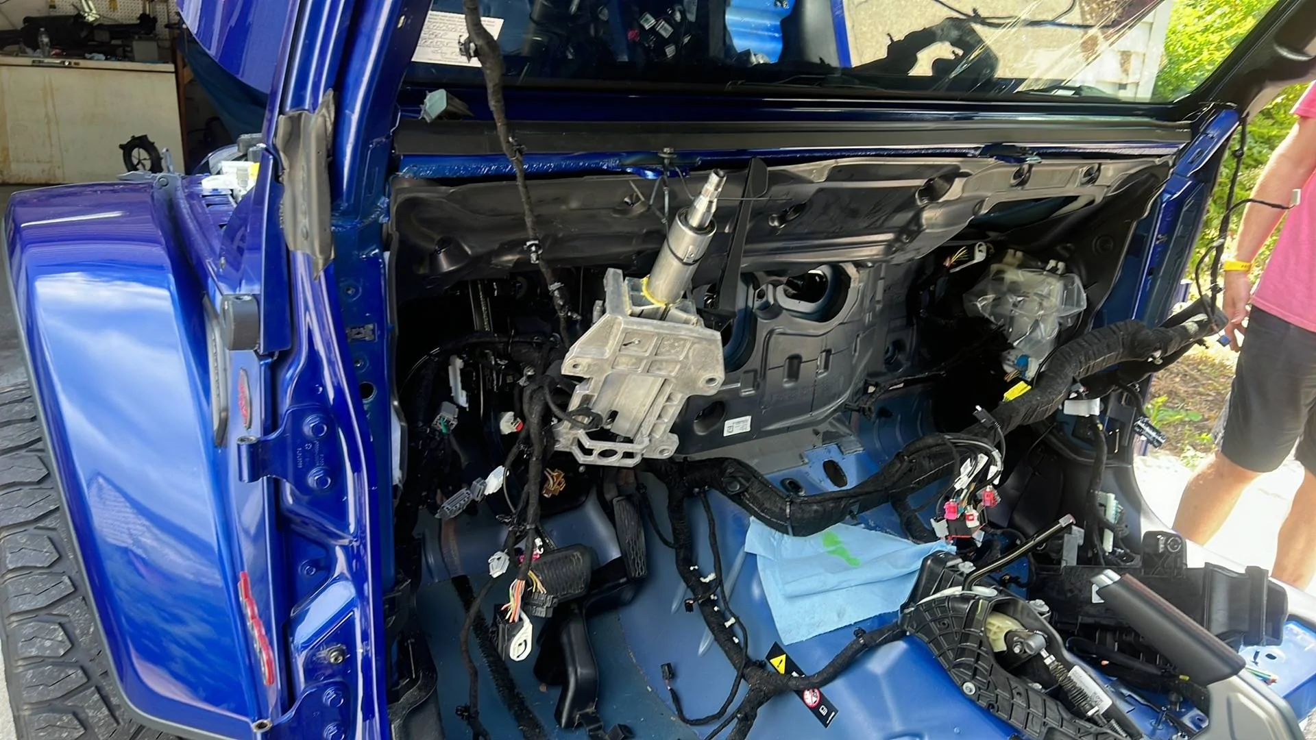

Wow, glad you found the issue. How many hours did it take to remove everything?
I have about 8 hours into removing the dash and heater core. Waiting on parts to go back together. It was absolutely not easy and very time consuming but it beats dealership prices.

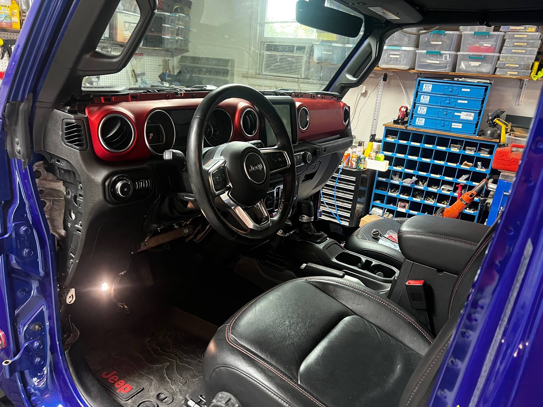

Finally back together all that is left is to recharge the A/C. Definitely not a job for the faint hearted. Holy crap it was a lot of work and I will not be doing again. (Pic is missing the last top trim piece on the dash but it’s installed now)
