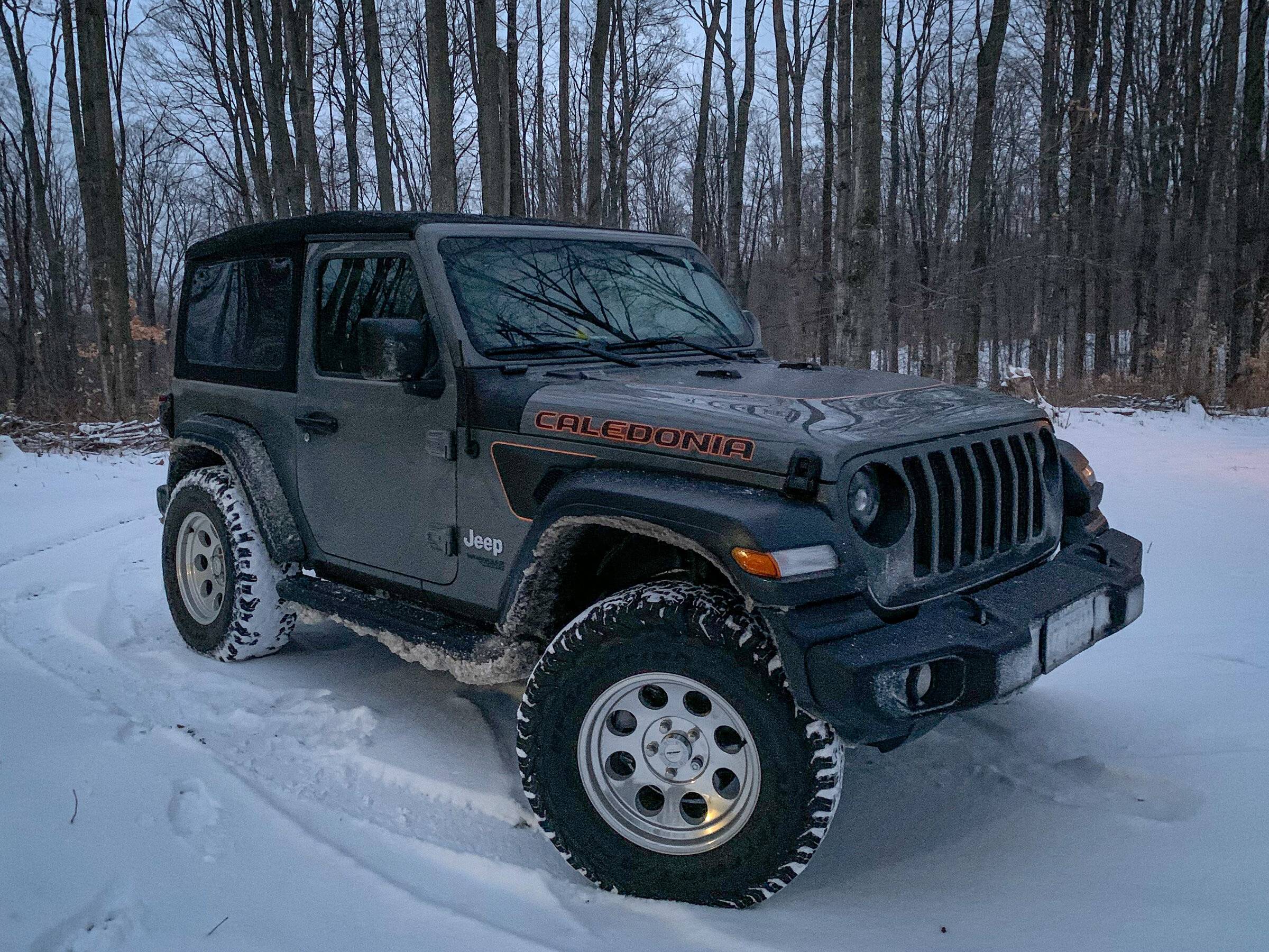

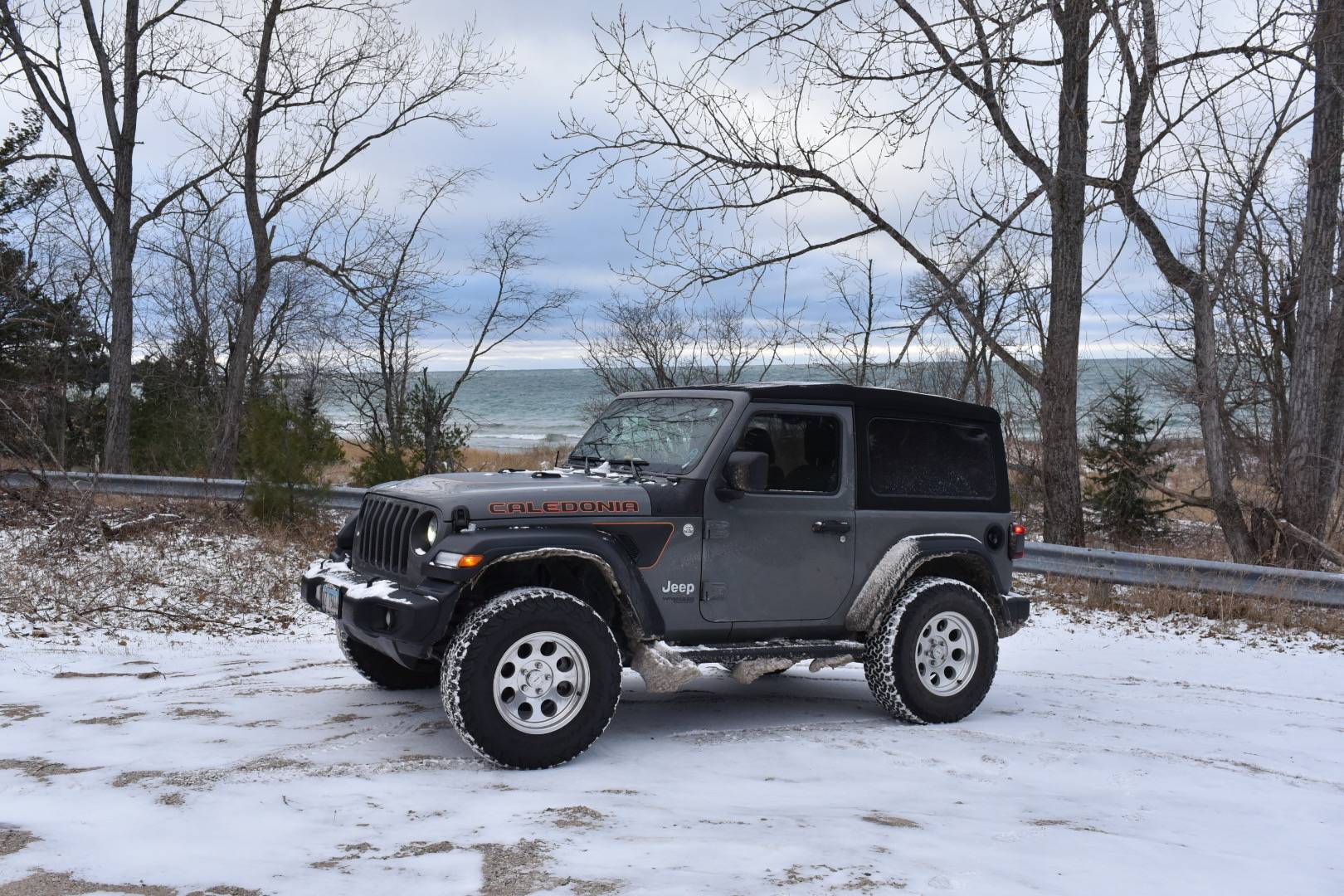

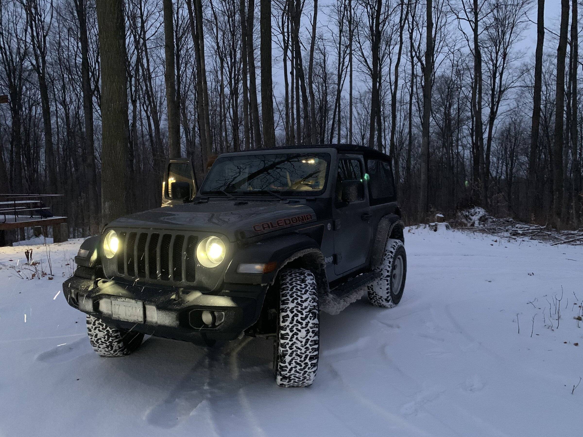

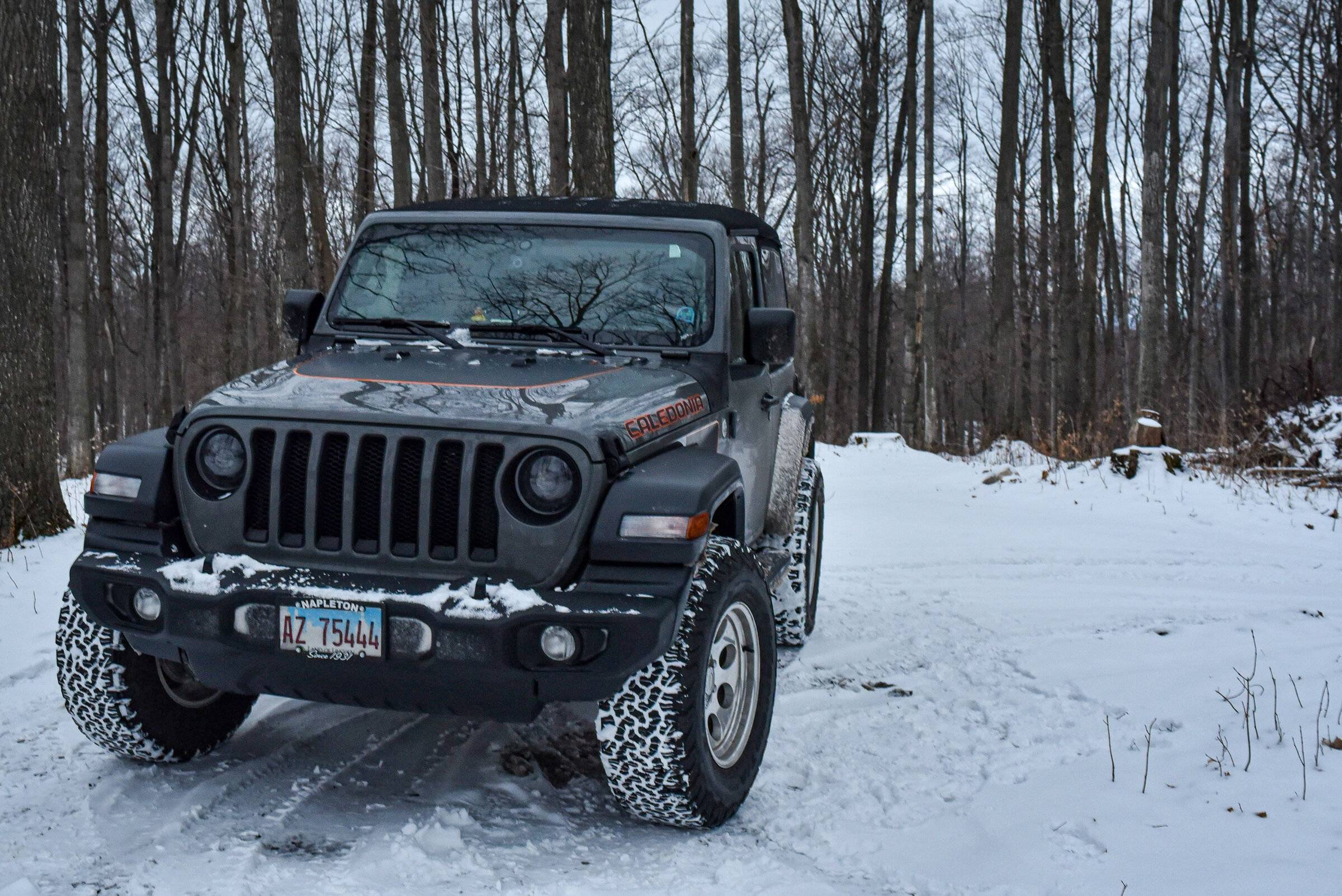

I live in Chicago and honestly, I would recommend just keeping the soft top on year round. I have the premium soft top and whilst it’s in a garage overnight, I have travelled to upper Wisconsin and Michigan in the depths of winter and even when left out overnight, it’s not a problem. Partly because of the power of the heater (we recently were in Bozeman with a rental 4Runner in the depths of winter and I was amazed just how poor the heater was by comparison - the jeeps could literally burn you haha)
*I do love the look of the hard top and would like to have it as an option if it was easier to swap out
