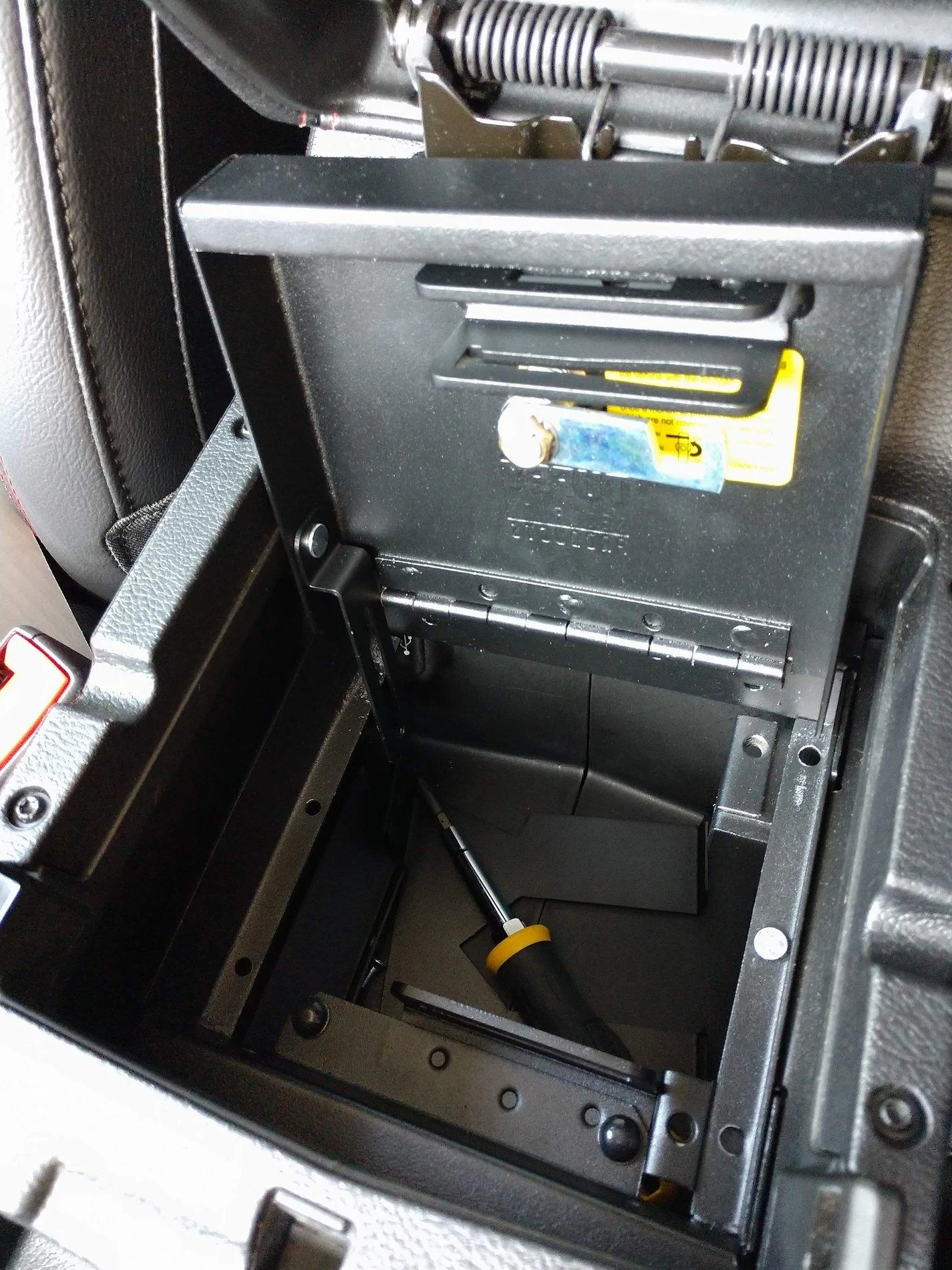

I just installed the Tuffy security console this weekend (part # 348). While I'm relatively happy with it now that it's installed, the actual installation was AWFUL. The instructions leave a lot to be desired, and because they're all black & white it's almost impossible to see the specific part & orientation in the drawings. In addition one of the parts was assembled backwards at the factory and I had to drill out a rivet and then rivet it in the right place.
I like having a place to store a firearm securely but I wish their console went together easier.
In the end I have these suggestions if you buy it:
1) Buy a couple of those gun magnet mounts- I attached them to the two vertical supports within the console so the actual pistol & magazines hang from the sides leaving room in the center of the console for other items (in my case a holster and two boxes of shells)
2) Buy the optional combination lock. It's super easy to set your own combination and you'll never be in a bind where you can't find the key or don't have it with you. The combination lock installed quick & easy and it feels super solid when operating it
3) When installing the main console lid to the vertical supports I used a tapered nail set to help align the mounting holes. They need to be perfectly lined up to accept the hardware so having something to work them together helps.
Jeep Wrangler JL console or glove box vault... IMG_20180622_154520059
*In this picture you can see the "hold-open" rod attached to the passenger's side (the screwdriver is pointing right at it), however the flange it mounts to is actually on the right side.
You also lose the functionality of the little LED on the back of the console because the lid blocks it while open. (Not a big deal in my opinion)

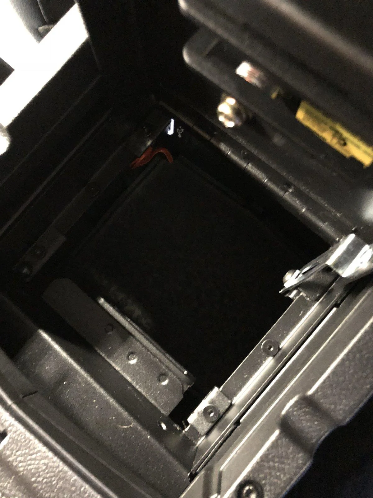

Agreed that the install was not fun at all. I had to open up the bolt holes a little with a 3/16" bit to get them to align and let the bolts through correctly.
That hold-open rod should be on the other side. That looks like a wrong part or mistake by the manufacturer. Mine came with the rod on the driver side.
Once installed, it seems super secure though.

I have the light and I didn't think it got much in the way. It was definitely awkward getting the lid assembly into the console and holding it in place to start bolting on the side guards and "legs". I didn't have it available I but a second set of hands would go a really long way.

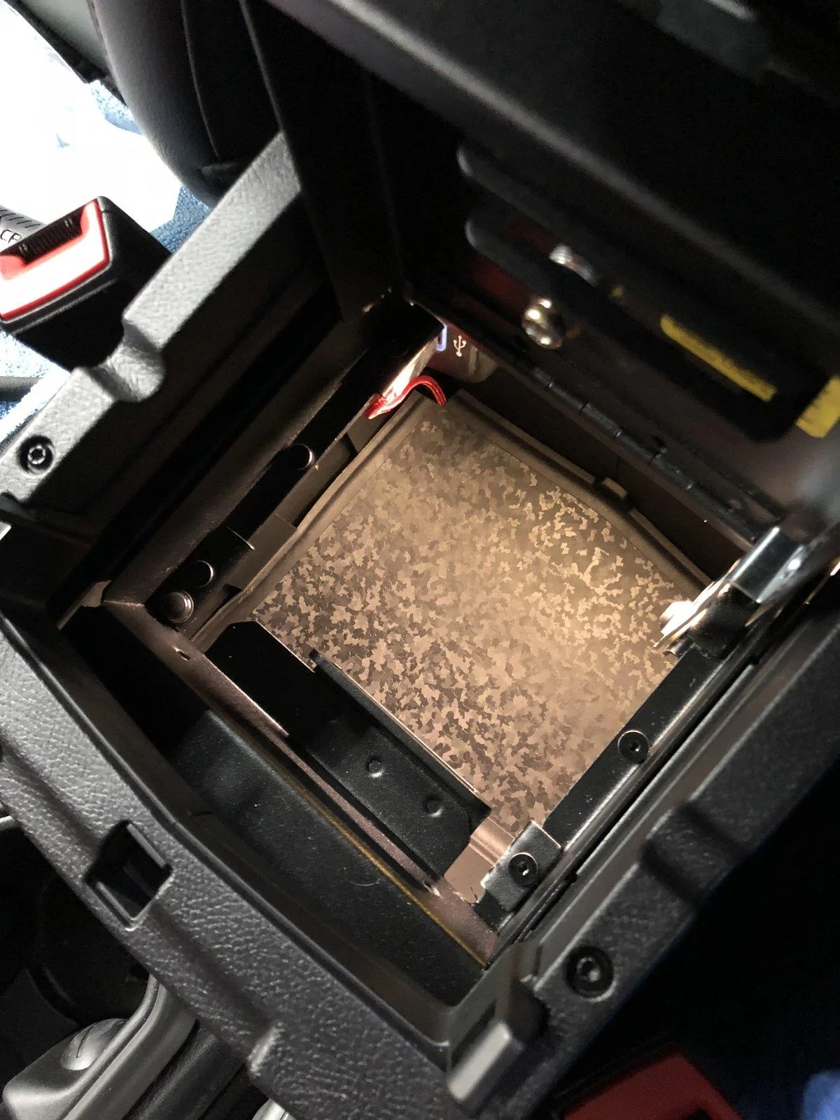

Installed this a few weeks ago. Didn’t like how dark it is inside the console especially when reaching in for a gun. Pulled the console out today and added a little led strip that I wired to the ignition on wire from my aux switches under the passenger footwell.
I also routed my usb wire out a hole I drilled down into the console so I didn’t have to have it coming out of the safe. Swapped the safe hardware with all black too for a cleaner install.
Oh yeah and this thing is a big a pain to install as everyone has mentioned but once it’s in it’s solid. Install went a little smoother the second time.
