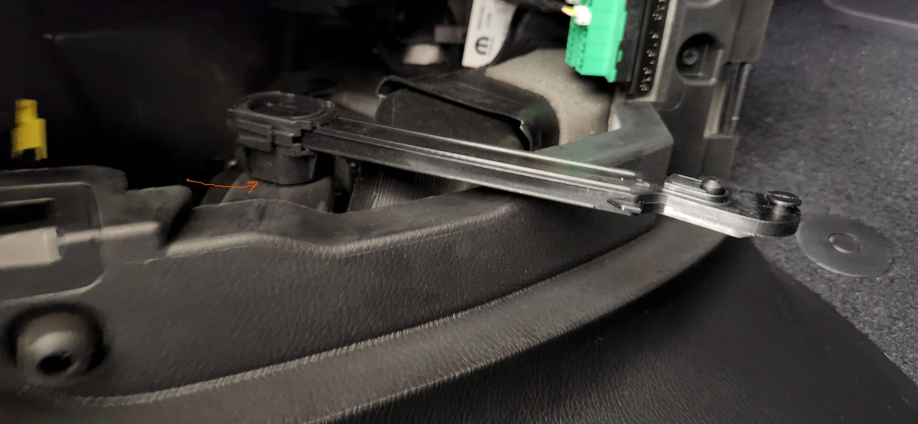

The glove box falls out. I've searched and searched. Found the damper lying behind the glove box. Not installed. I've searched and searched. Would appreciate help, or links to something that will help.
See the pic of the Wrangler JL Glove Box Door Dampener - Mopar (68437969AA) below. See the red pointer arrow. That red arrow is pointing to a male key that twists into a female you will find on the left side of the glove box housing.

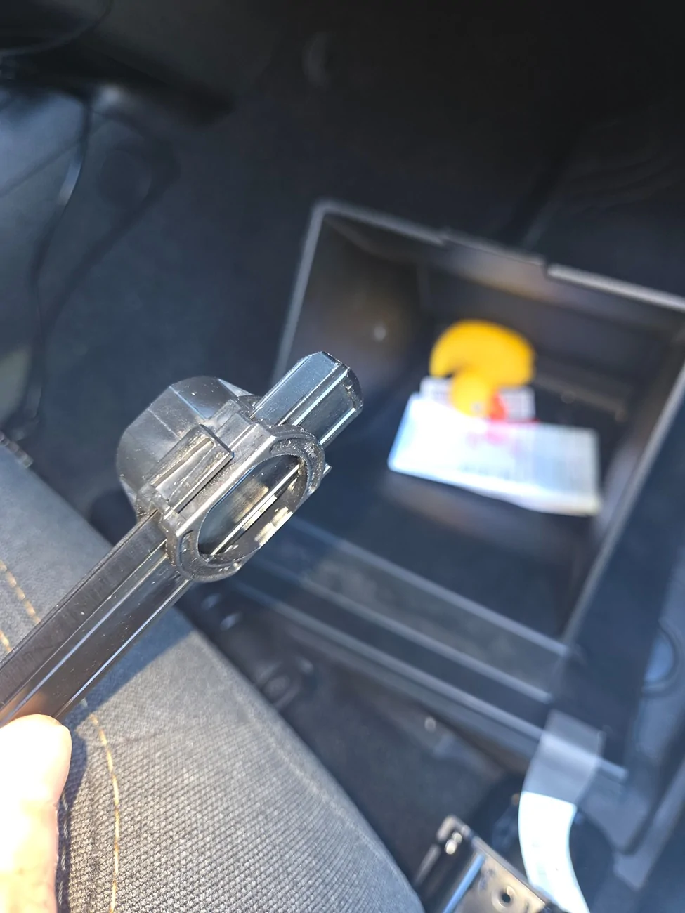

See larger second pic below and you will see the installed Glove Box Door Dampener - Mopar (68437969AA)

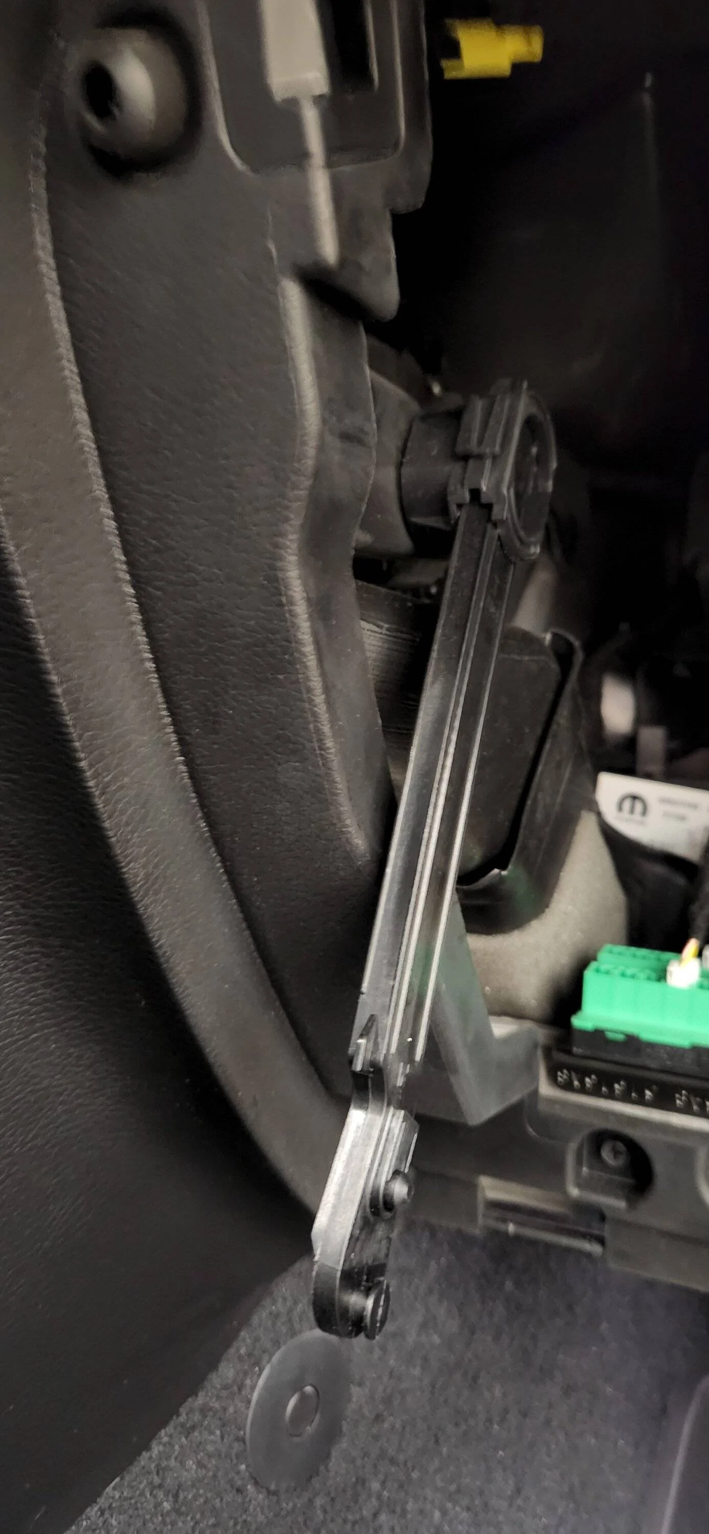

The third picture below, has a red arrow pointing to the area where you will find the female slot that the male twists locks/secures into position..
