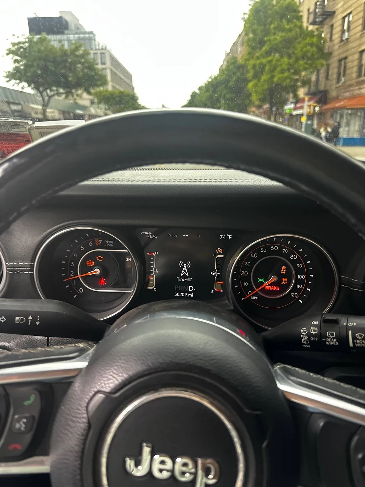

Brake light indicator on dash gets illuminated and I cannot put my truck into any gear while it’s in park even if it pull the manual transmission disengage rope. While I am driving every error light comes and then disappears after a short time. No idea. Have no idea where to start troubleshooting. I ordered a new tazer mini and having the same issue. Biggest concern is auto park disabled and cannot put into gear. Checked all my doors and pins.
Jeep Wrangler JL Computer or tazer issue IMG_1502

I strongly encourage you to unmarry the Tazer JL right away.
I highly doubt your issue is related in anyway to the Tazer JL, but you do not want to have the Tazer JL in the mix when trouble shooting issues.
Could be your issue is related to aged out batteries on your JL... Are you still running the batteries installed at the factory in 2018?

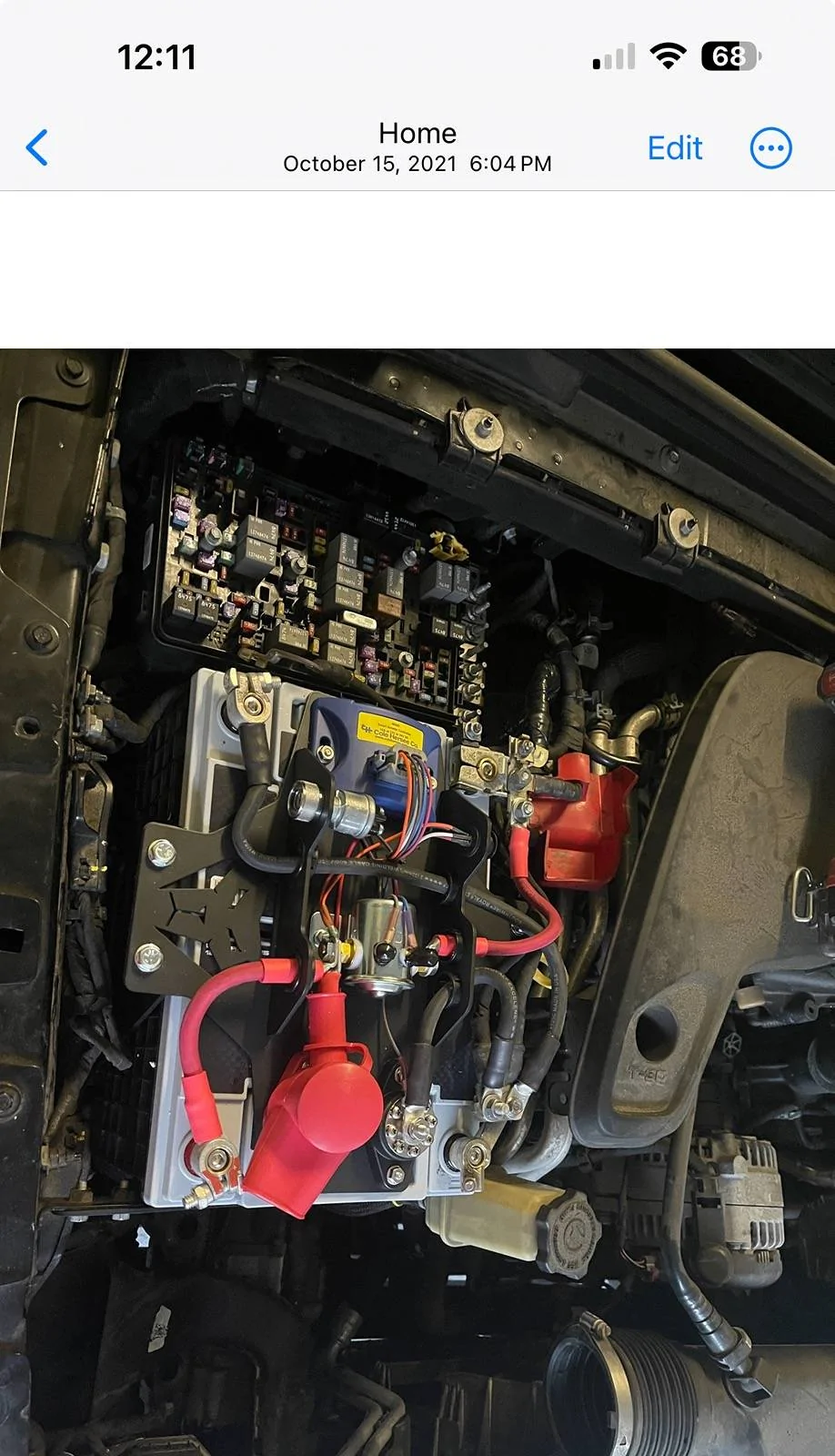

I was thinking the same. not stock batteries. I changed stock to genesis dual batteries maybe 4 years ago. I have dual fullriver full throttle

Load test both batteries will let you know status of batteries... 4 yrs. old, I'd replace them both as they are aged out...

Four years is long enough to suggest that they should be load tested. Resting voltage can be acceptable, but then fall off a cliff during a starting event. Observe each battery's voltage, individually via a multimeter, when the engine is cranking.
If the batteries are determined to be reasonably healthy, then proceed with unmarrying the Tazer as suggested.

I will check the batteries. Not even 3 years. October 2021 is when I installed it
Jeep Wrangler JL Computer or tazer issue IMG_1509
