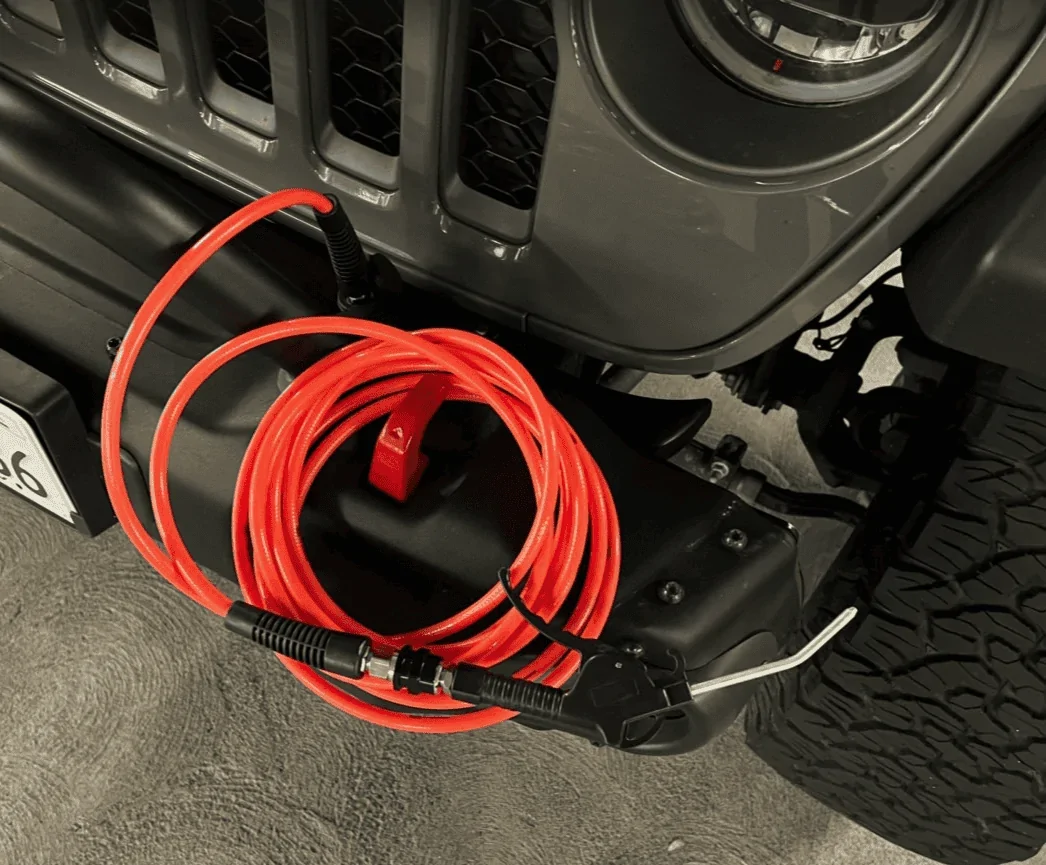

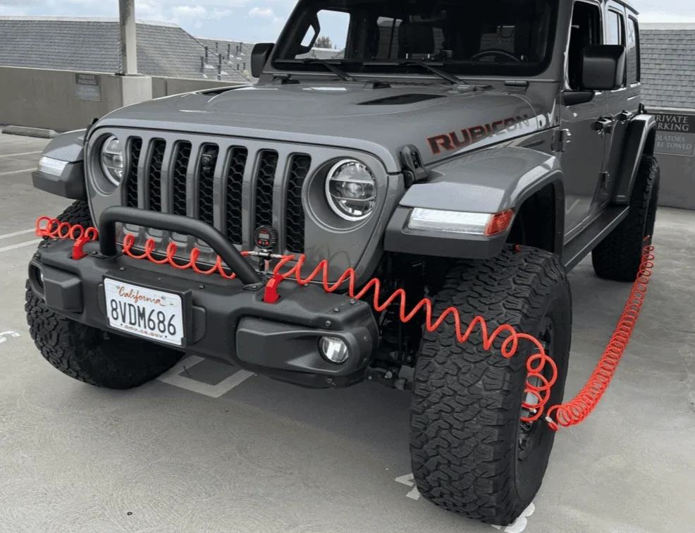

I was going to go the Powertank option but decided against it because I didn't want to do the math after each trip to see how much I used and how much I had for the next trip, the cost and limited places to fill it up, the space it takes in the back, and the worry that someone would steal it if I had the top off. I went with an onboard ARB dual and can inflate all 4 37" tires from 12 to 33 psi in just a few minutes.
Jeep Wrangler JL Compressor vs. Compressed Air Tank 1772494253340-a4
And have unlimited air to blow the dirt out of my engine bay (and filter) after the trail ride or blow the water out of the gaps after a car wash
