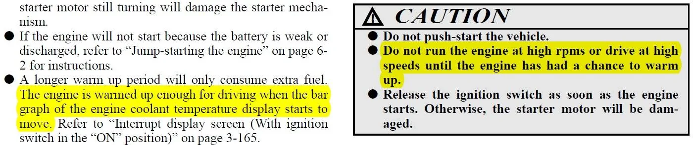

Not sure about any fundamental changes in metallurgy between engines of today and decades ago, but my last car that was sold up until 2014 (turbo 2.0L, but not direct-injected) definitely recommended/warned about warm-ups (and cool-downs after driving).
If the Wrangler manual doesn't state anything about it, then I really wouldn't worry about it too much. Personally, an extra minute or two every day and driving moderately for a bit really doesn't bother me, but if I need full-throttle for a good reason, then I'm absolutely gonna use it.
This is what was written in the owner's manual of my Evo from less than a decade ago..
