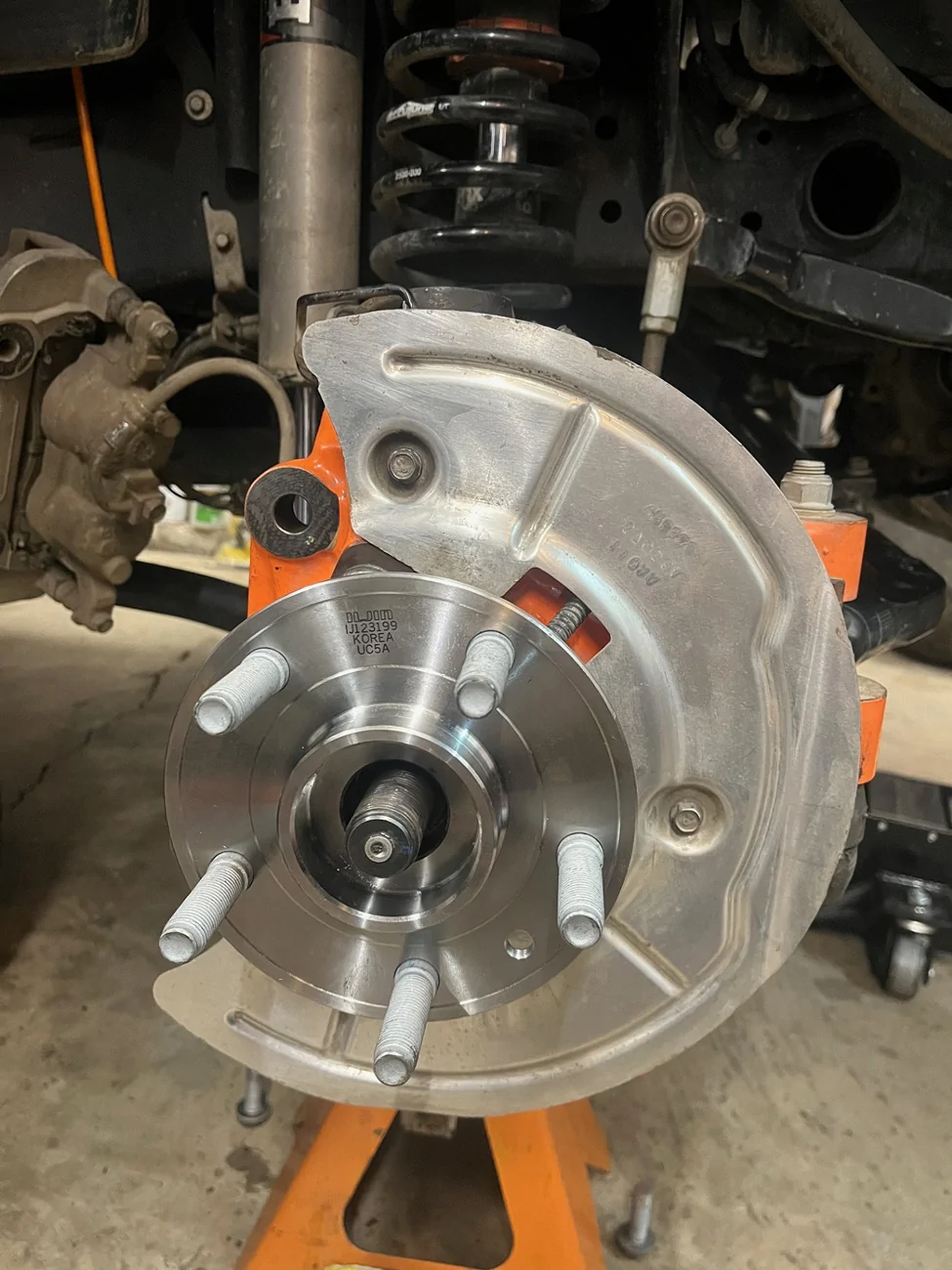

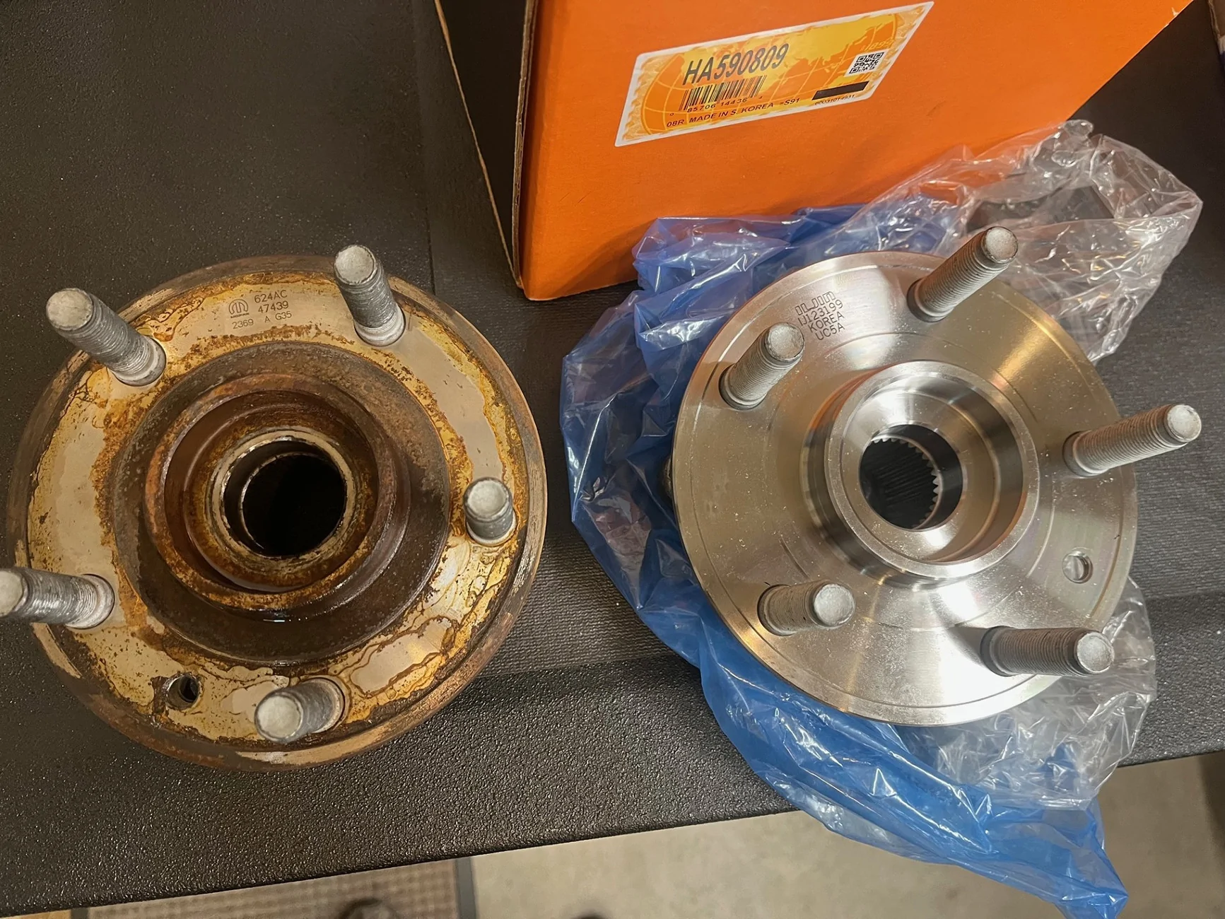

Had an issue with the front passenger side. Just felt like it was hopping over there on that side of the vehicle, especially to and from stops...like a really out of balanced tire or out of round tire. I even noticed the tire was cocked inward / to the body with the naked eye at some point and that's when I realized the unit bearing needed to be replaced.
I decided to go with Timken brand and replaced both driver and passenger side
Part Number: HA590809
Jeep Wrangler JL CO Ketchup Build UnitBearing01
Jeep Wrangler JL CO Ketchup Build Unitbearing02
Problem solved and back to a smooth ride.

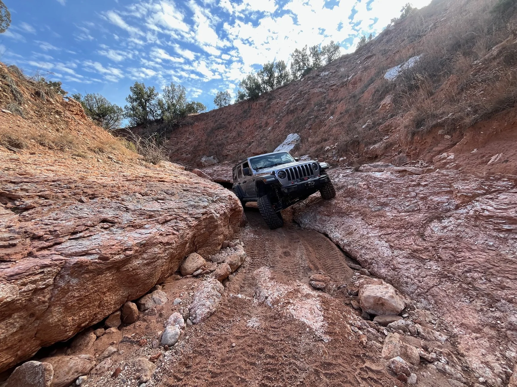

Spent some time in Texas visiting family during Thanksgiving so I decided to make it a road trip with the JL and hit some trails.
Northwest OHV Park, Texas:
