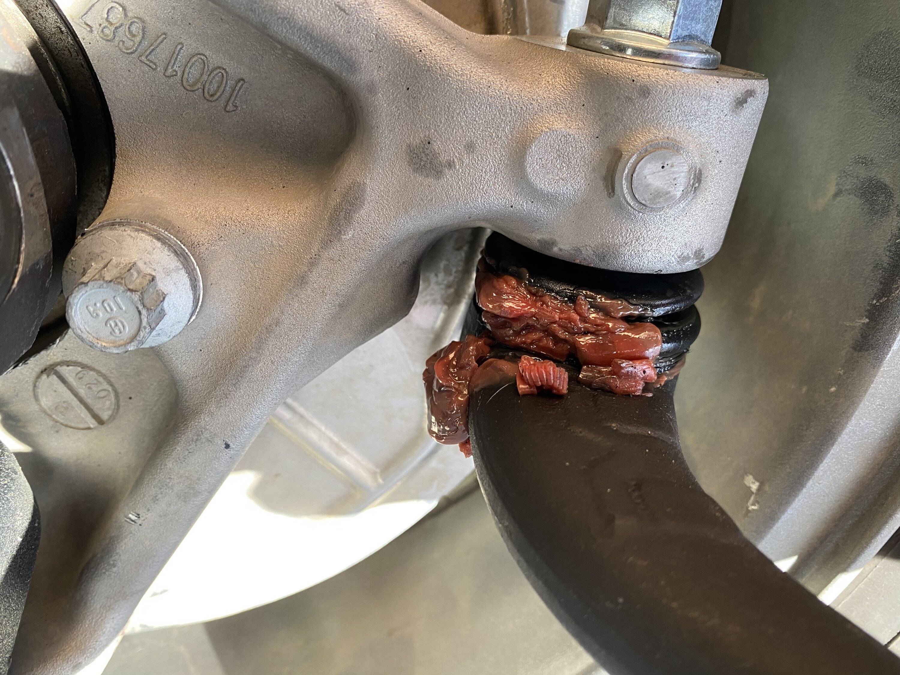

Ok, so I swapped in a UD44 front for my M186 and used the stock draglink and a metalcloack tie rod. The jeep already had all around adjustable control arms and adjustable track bars from metalcloak. I did the MC 2.5” springs at the same time. First 100 miles was fine. Dialed in caster to 6 originally and 1/8” toe-in. It recently started making noise up front. I can usually feel it in the footwell through the body, but occasionally I get a similar noise from further back and feel it in the seat. It is related to loading/unloading front/rear suspension and possibly lateral loads make it worse.
I thought I mistorqued something, turns out I missed front track bar axle side. Noise still there. I regreased the tie rod, better for a bit but keeps coming back. I might have a bad boot:
Jeep Wrangler JL Click/clank/clunk after front axle swap 93B9C3E2-C1A1-4B40-B792-B149A3B8BA77
Jeep also settled and was running crazy high caster. I fixed that last night and re-greased the tie rod again. Noise still there. I also discovered my front driver spring was unindexed axle side, fixed that. I thought maybe that was the noise because there is no isolator on the UD44, it is metal on metal.
I still don’t have my steering stabilizer on because I wanted alignment dialed in first. I also have to reset toe and re-center steering after last night’s caster/pinion change.
My next steps are:
Replace track bar bolts. I was already planning to, I just forgot to buy them while swapping axles. I will start with the front and if that noise goes away I will do the rear.
Could I have a bad ball joint from the factory? How do you test it? I know they’re torqued down enough because much more and the cotter pin won’t hold the nut.
Maybe it is the tie rod end, since greasing shuts it up for a day and then I get that goopy mess.
Any other ideas?

Yeah, I torqued them to spec. The weird insert on the top joint made me think I had messed up, but if that insert were pushed flush up top the cotter pin would become worthless.
I got it to make noise sawing back and forth while idling today, so I do suspect something steering (track, tie, or knuckle).

I think you answered your own question, if globing in the grease calms it down, I’d start there…and apparently globing is a word as I did not get autocorrected….. ?

Track bar bolts didn't help.
Yeah, I'm just hesitant to blame a brand new balljoint on the tie rod. I'll contact MC and see if they've got suggestions on how to check it.
