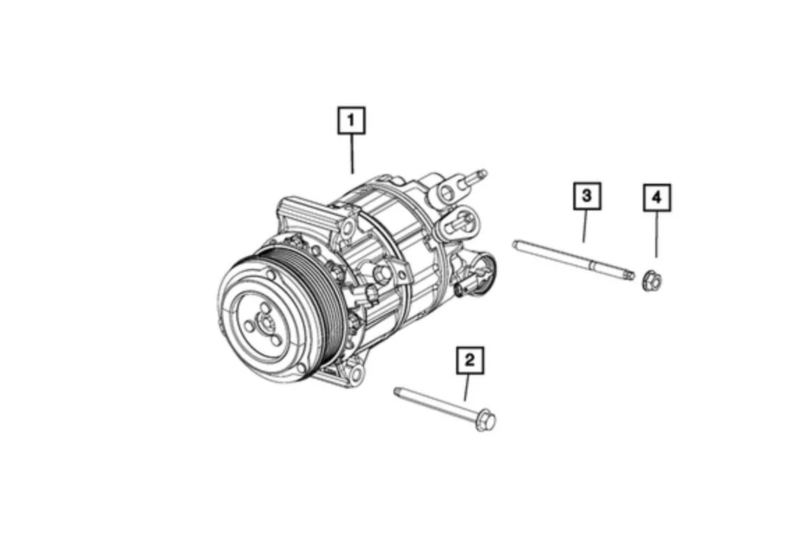

I'll try to get some pictures next time I'm at my Jeep. #3 and #4 missing in picture.

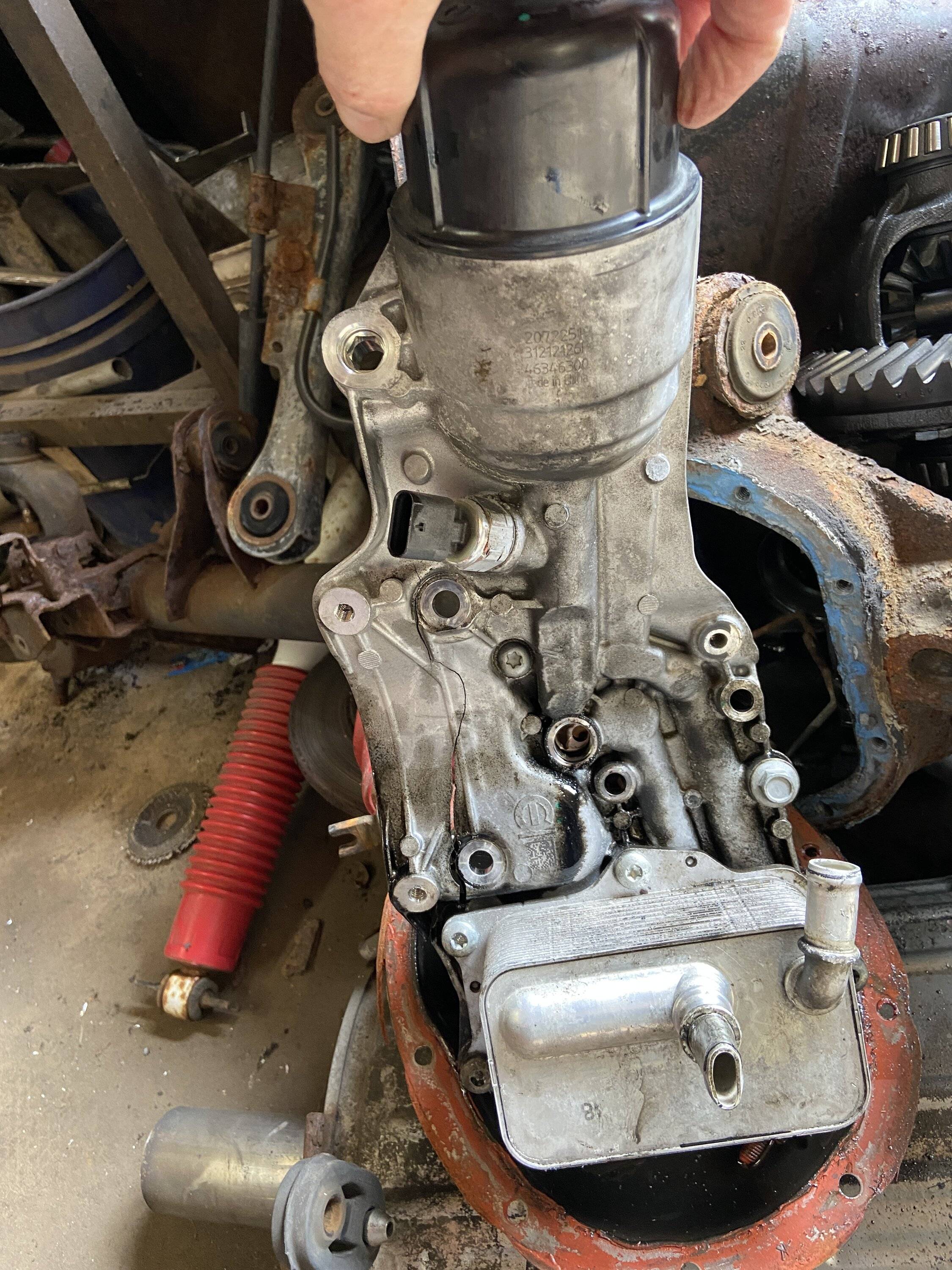

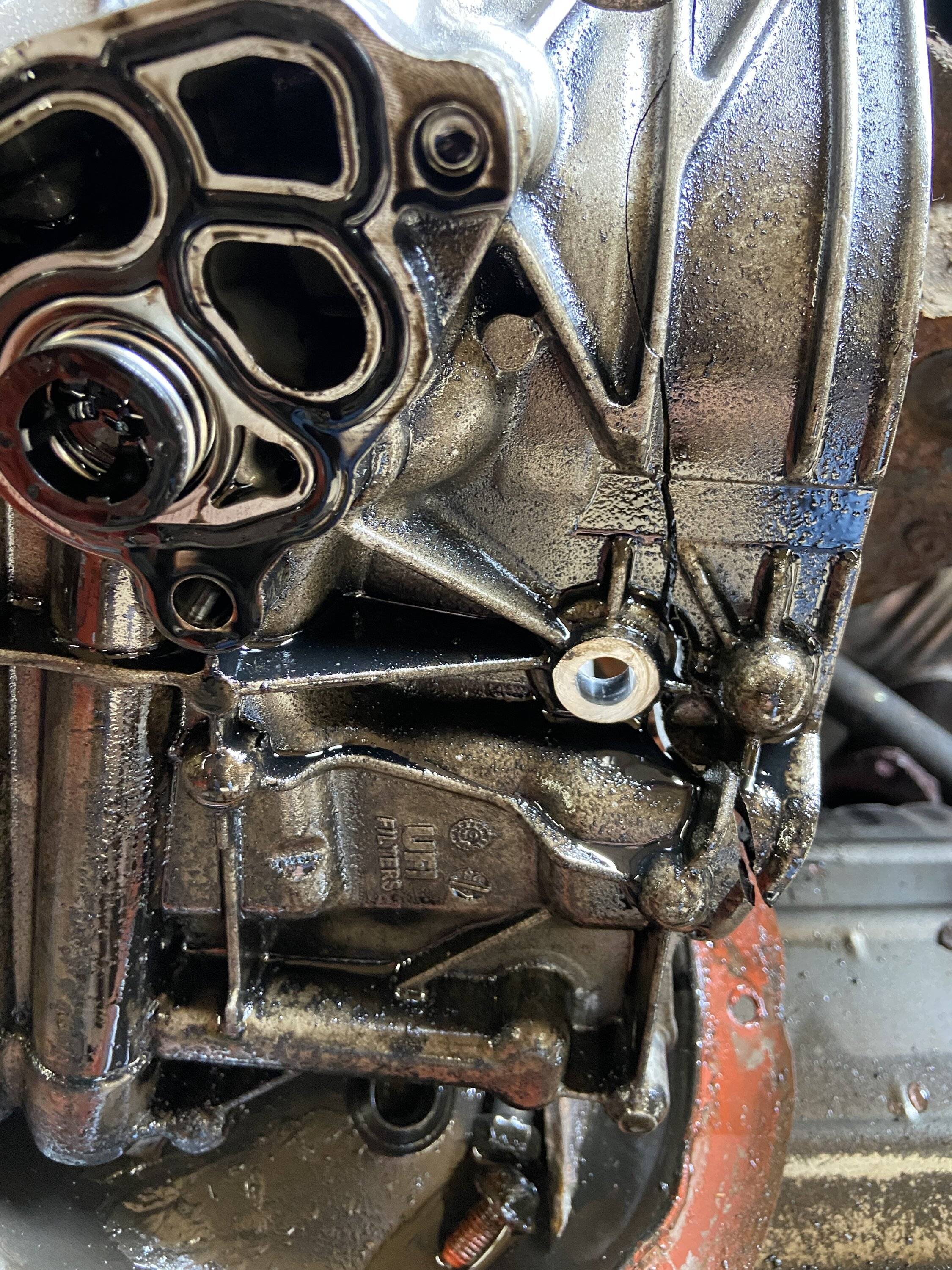

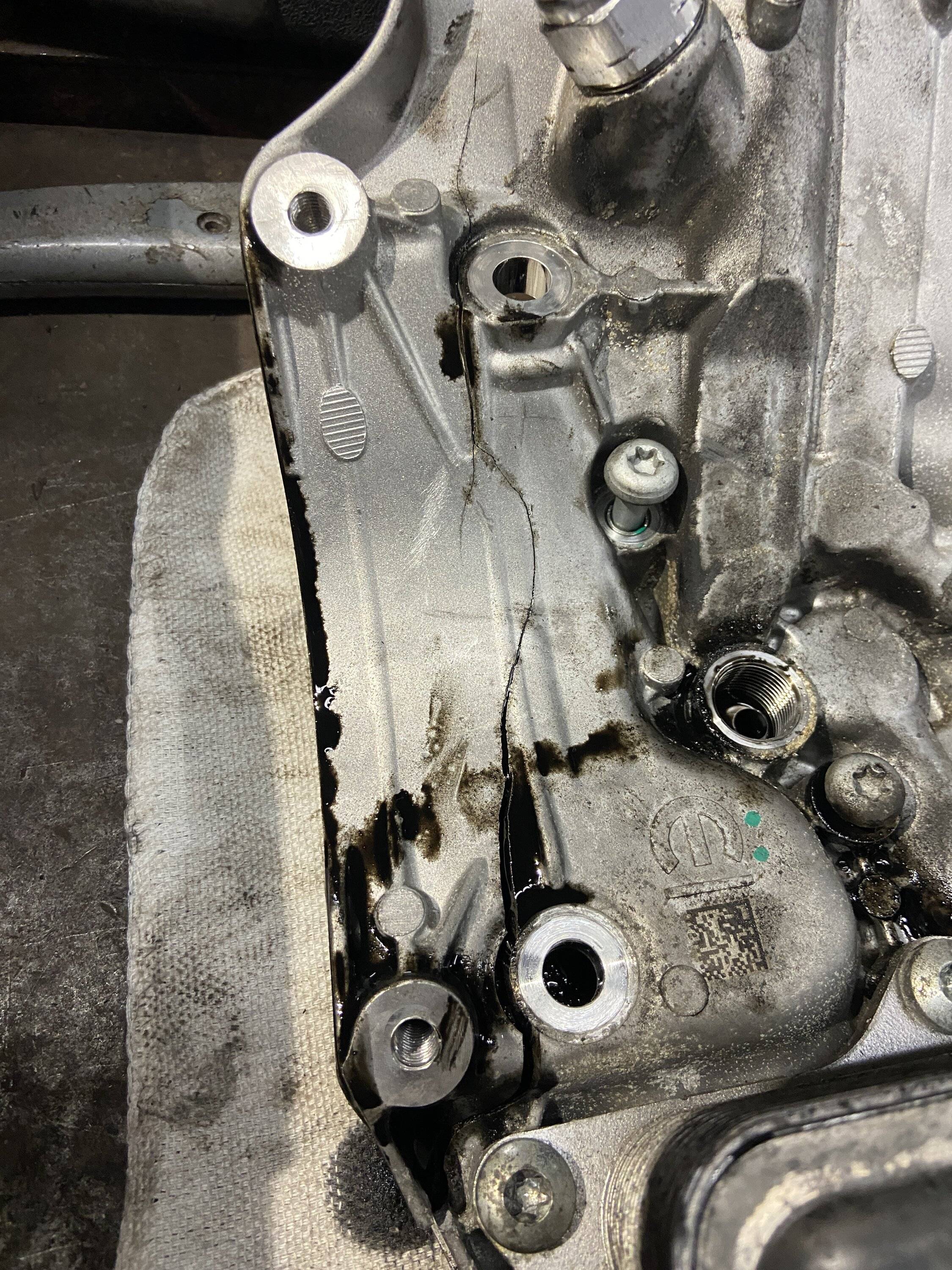

These are the pictures of the oil filter housing that got destroyed from the A/C compressor twisting when loosing a bolt.
Ouch. I hope it's all back together, and running well.
