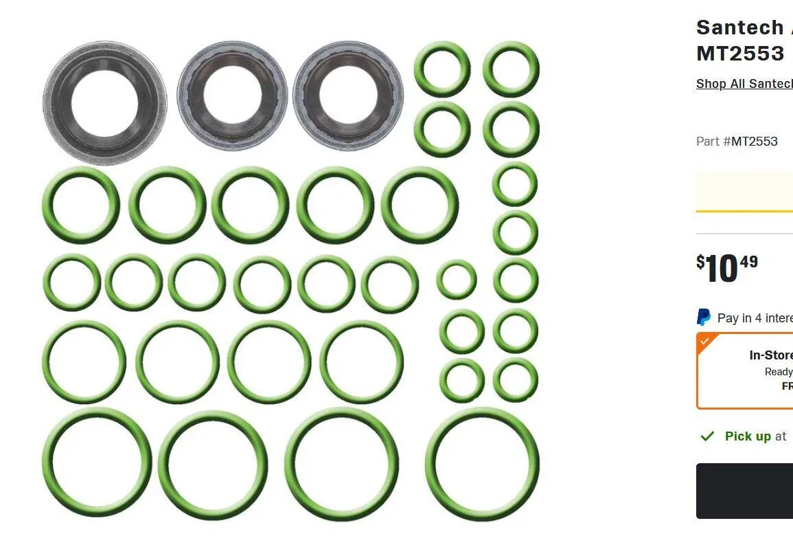

LOL $143.83 for a "seal kit". Usually good aftermarket parts already come with the seals. I bought a massive bag of A/C seals from somewhere locally for like $10. What a rip-off of an estimate.
