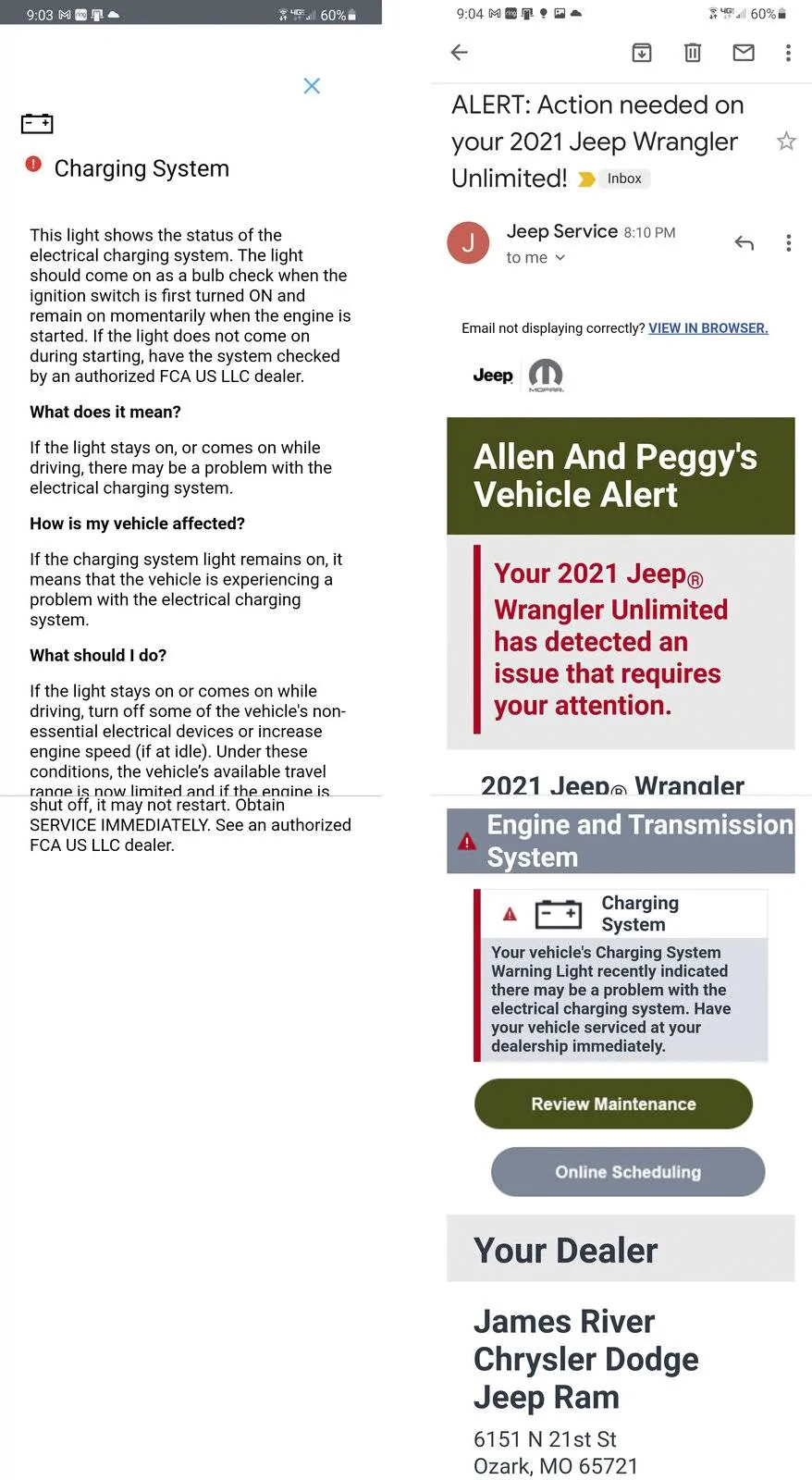

I have no electrical issues that I know of. When I start my Jeep the battery symbol on the gauges comes on for the bulb check and then goes out when the engine starts. The instrument panel display shows system voltage at 12.6v with ignition on, engine off. When I start the engine the system voltage goes to 13.5v at idle with all accessories off. While the engine is idling, I turn on AC with HVAC fan on high, cooling fan on high, headlights on, steering wheel heater on, both front seat heaters on high, rear window defogger on and front windshield wiper on. With full electrical load the system voltage, at idle is 12.5v. It just doesn't get any better than this.
But yet I get the messages (see below) from Jeep. I have checked all of my battery connections at the main battery. I did not check or test the aux. battery. I am thinking the Jeep is all good, and the Uconnect alert warning is screwed up.
Any words of wisdom on this issue? Just FYI, the Jeep is stock diesel and has the heavy duty charging system.

UPDATE: Charging System Warning Alert via email & Uconnect App
It has now been 14 months and 10,000 miles since I received a Uconnect "Charging System" warning email. NO MORE WARNINGS. I think it is safe to say replacing both batteries fixed this issue. ?
