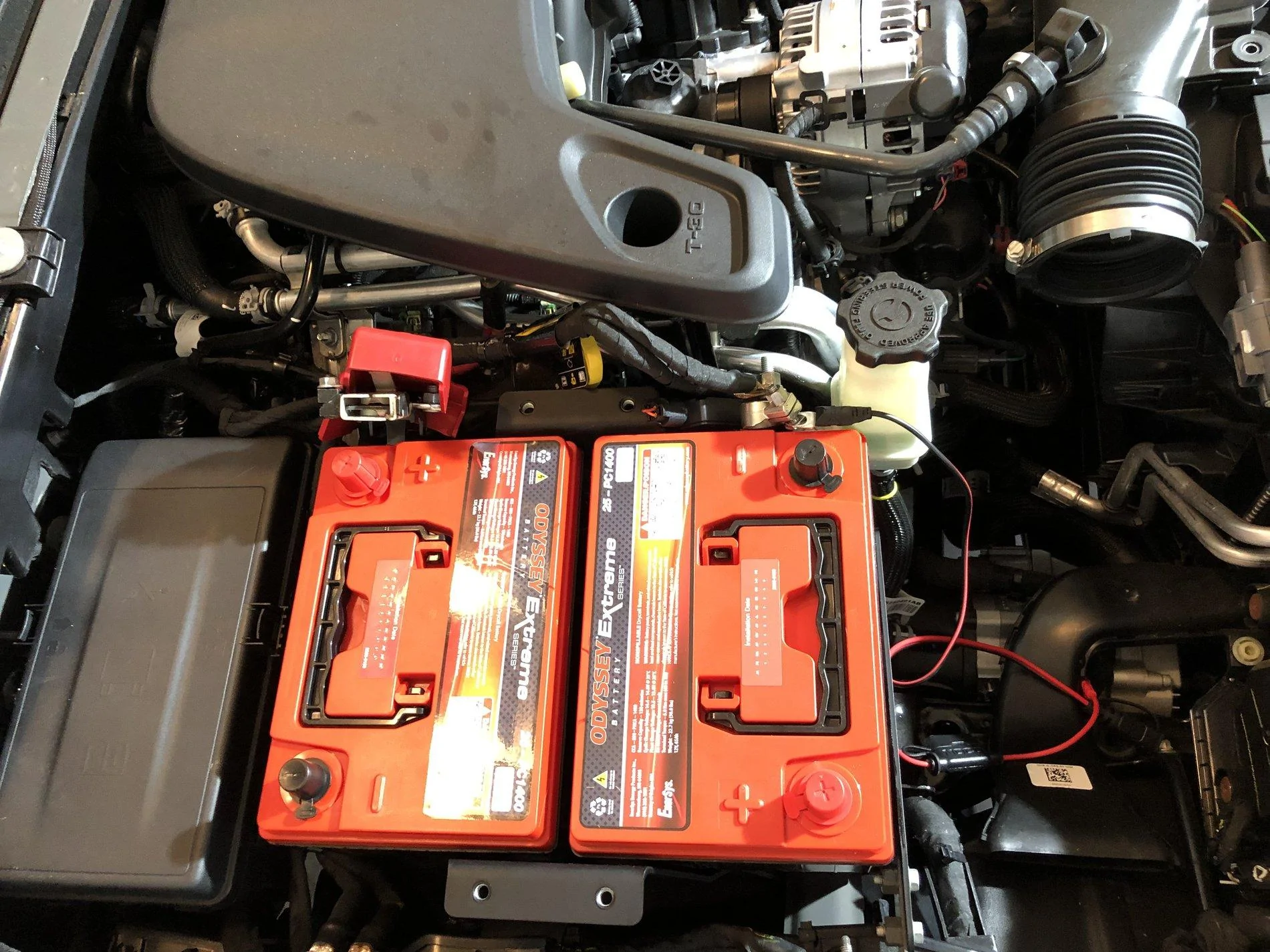

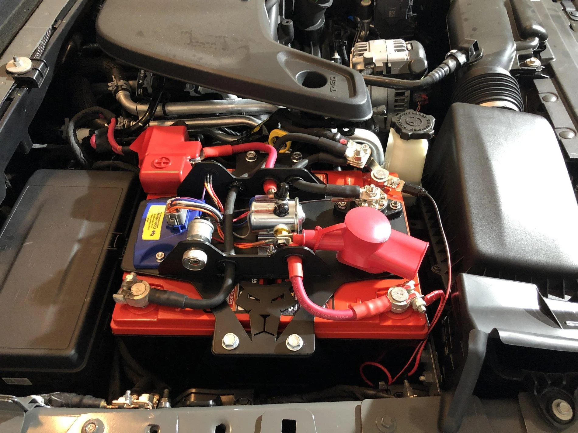

The JL’s have an intelligent battery sensor (IBS) that regulates voltage coming from the alternator. So if the voltage shown on your dash is bouncing around 12.8 to 14.2 while driving, the IBS is doing it’s job.
Even with the Genesis dual battery setup, it will behave the same. I’ve had mine in for a couple of weeks now. Works like a charm and no more aux. battery failure anxiety.
