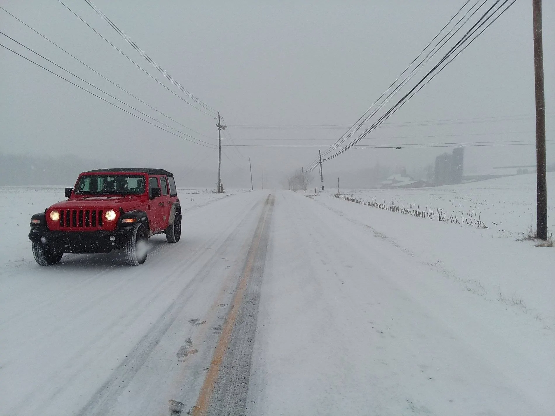

Any thought of having both AT tire and dedicated snow tire
My thinking is Yes!, if only because that's what I've already done. :)
The snow tires are studded, which was a requirement for me. As they're verboten between 16th April - 14th November, I couldn't compromise on an all-terrain tire for year-round use.
