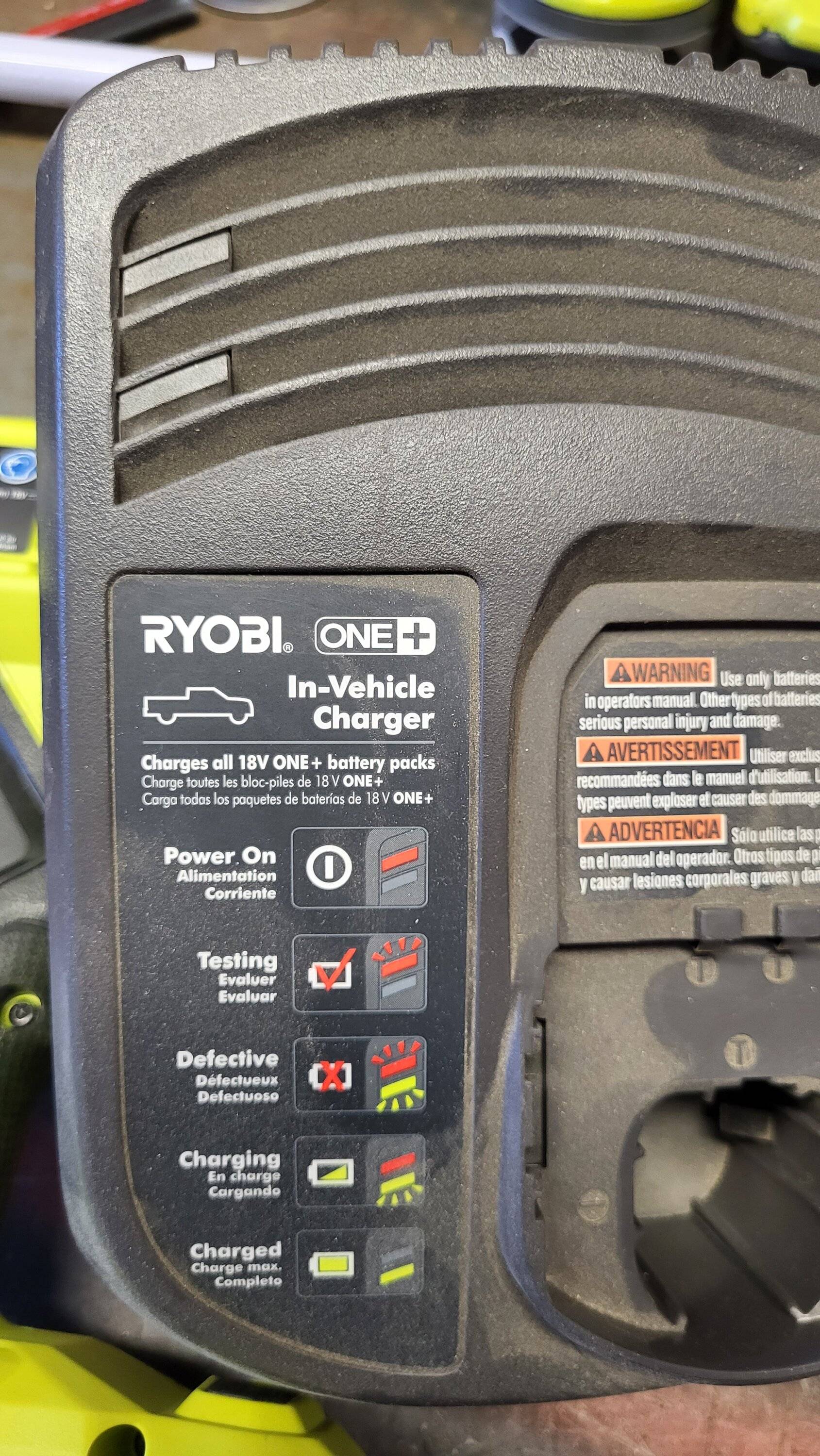

While drinking a weekly beer at a remote location just below the Mogollon Rim, I noticed another regular. The older gent (70+) had severely bruised and bloodied arms. A little bit to the face as well. I asked what happened? Flat tire on Toyota Tacoma 4x4 P/U, the small truck. He could not get the lug nuts off, had difficulty lowering the spare, as well operating the jack. Whew! I'm not that far away. I decided to be proactive and procure tools and adapters for the Jeeps 22mm nuts and jack. I already had lots of Ryobi tools, batteries, and chargers. So I went that way. That size impact (P262) will get the nuts loose.

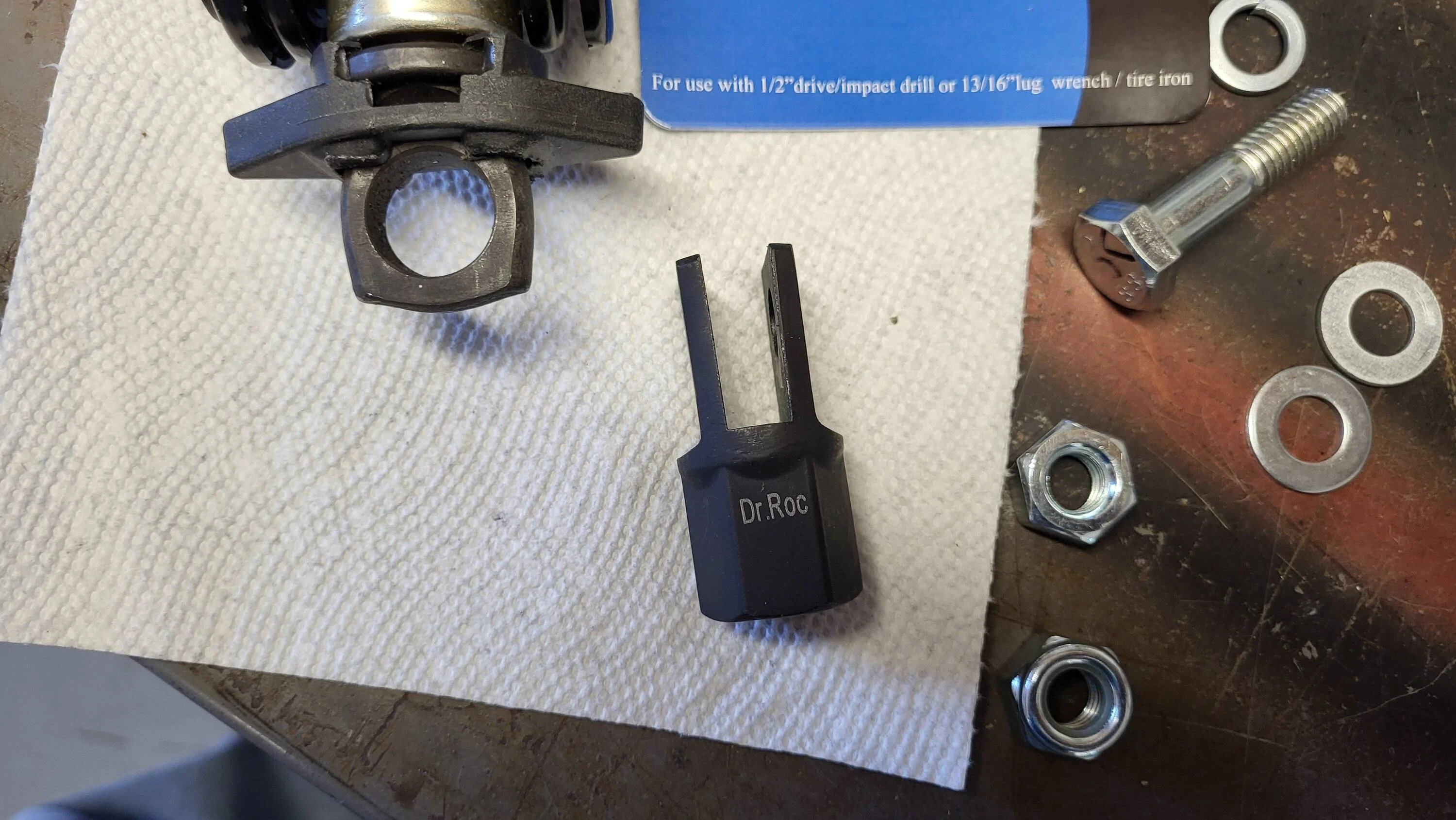

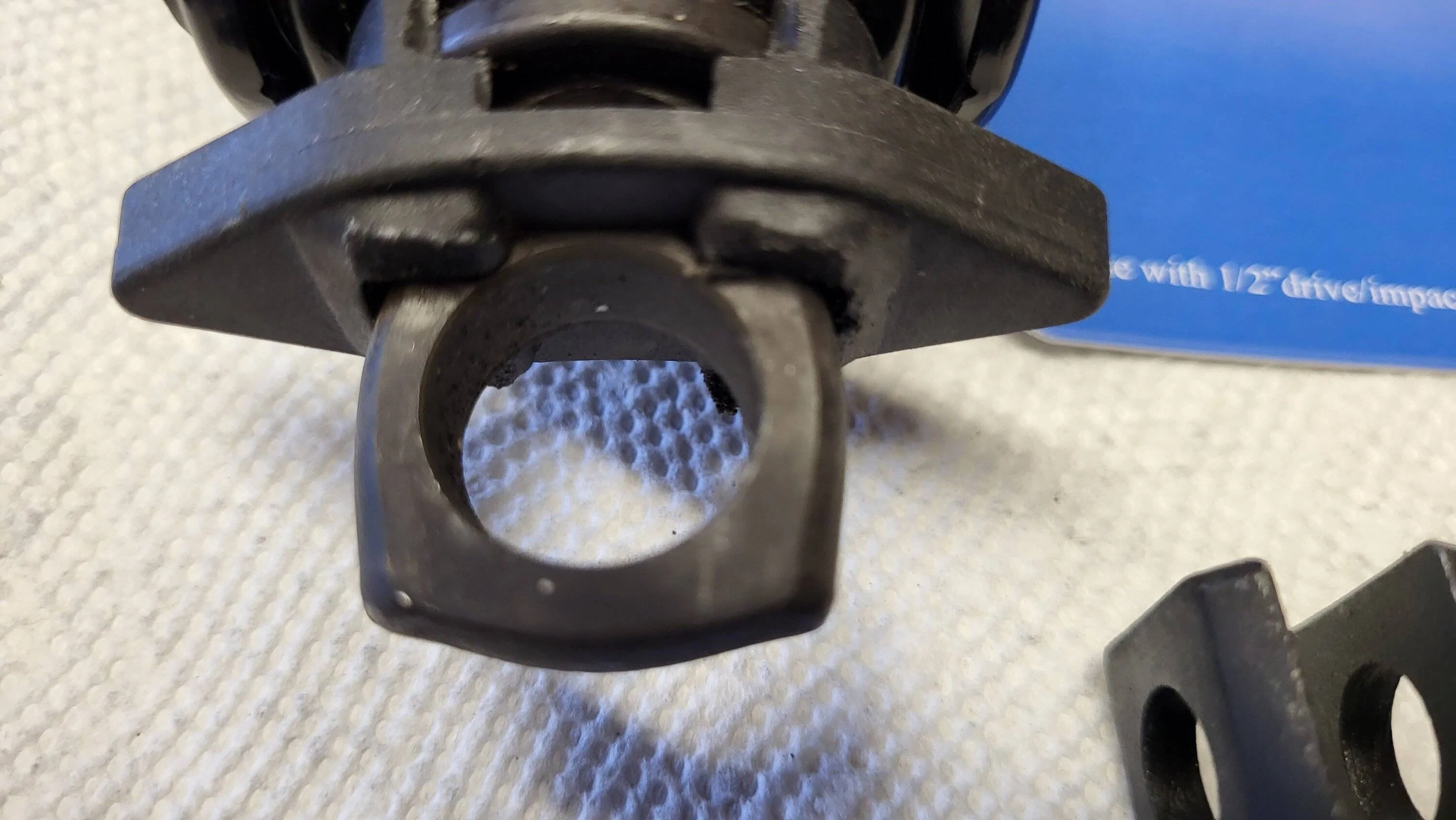

I tried to size the jack shaft(s), no way. Some weird size. FCA should have made them standard 3/8" drive socket. I did find on Amazon an adapter coupling to allow 1/2" drive or 13/16" socket. Dr Roc, while Chinese, Amazon it had on the shelf. I had to shave down the rubber nubs on the hand turning rubber.

I bought a nyloc nut (10mm x 1.5 thread) to secure it cause it wobbles. Go slow. Hard to film and jack with one hand :LOL:

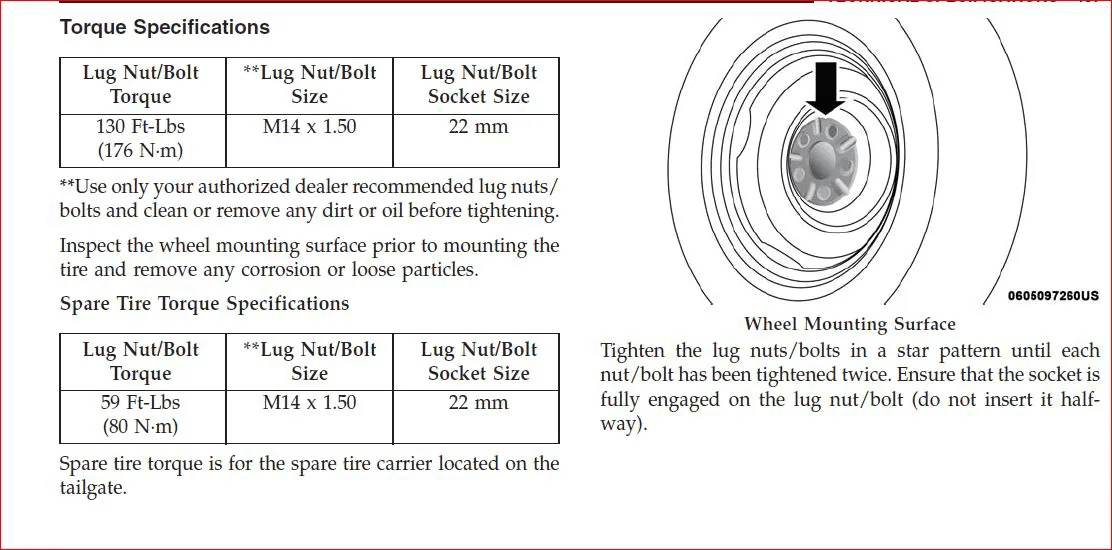

If your lug nuts are torqued to proper spec, you shouldn't need to carry an impact if you are of average strength. Nice to have, yes. It is another tool to carry and maintain.
Yes I can still break them loose. I use a torque wrench on them to correct when tires get rotated, etc. But why work that hard? Especially in the dirt, in Lord knows what conditions.

I literally just walked inside from rotating my tires. 18” breaker bar and 22mm socket makes VERY easy work of loosening the lugs. I am anal and always torque to exactly 130 ft-lbs.
I personally keep impacts far away from lugs. I’ve seen people cross-thread or over torque too many times.

I know what my pneumatic impact torque is at what setting. The approximately 100 ft-lbs was perfect for my previous trucks. The Jeep owner's manual is calling for 130 ft-lbs that requires a little more and finish with the torque wrench. The Ryobi electric is a bit different and I'll dial that in. This whole post is just one way, of many, but relatively easy to accomplish.
