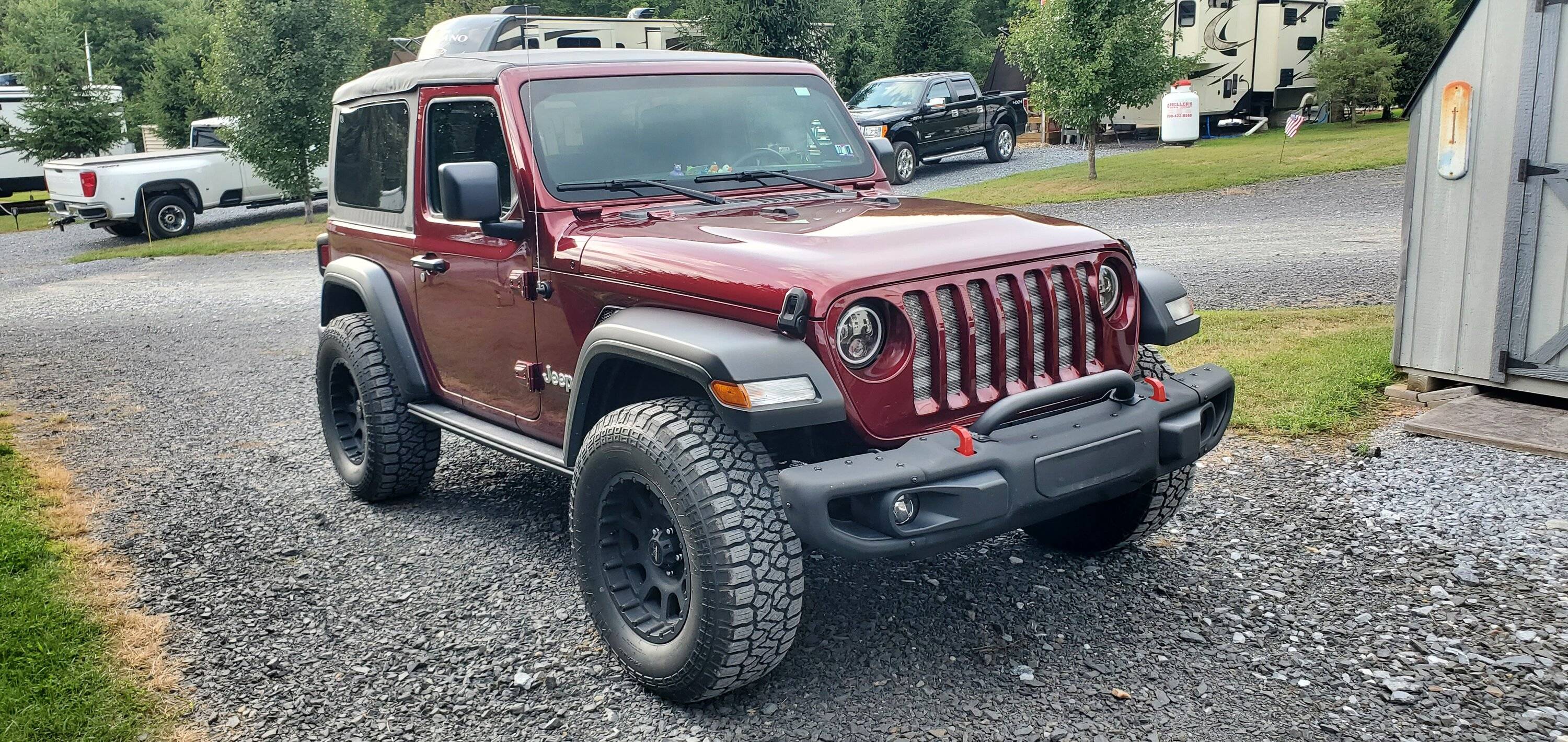

Why so worried about the weight? If you're worried about it for the performance (on a wrangler) you bought the wrong vehicle. I would be more worried hanging the extra weight on the tailgate, but there's always reinforcement or delete options for that. I stuck with the 285s because they're more popular. I read reviews on tires for their ride and reliability. I bought wheels with -12 offset with 285/70R17 Kenda Klever AT2 and I think it looks good(just my opinion) and rides way better than stock.
If you're going for looks do what makes you happy. Don't over think it.
Jeep Wrangler JL Changing the wheels on a 2023 JLU Willys. 20220903_172714

Certainly, I'm not looking for the Wrangler to be a performance vehicle. This is about appearance. But, I asked the questions about weight because I've seen posts commenting that the extra weight of larger and heavier wheels has a major affect on performance, such as not being able to stay in 8th gear, and even 7th gear on a level road. And, as I'm about to spend over $3700 on this mod, I want to get it right. And considering that the Willys has the 3.45 axles, I would like to get some idea of what going from 73lbs to 100lbs on each wheel will do. I don't know if adding approx 100 total pounds to 4 wheels is the same as 100lb of cargo, or if rotational loading one the wheels is worse.
BTW, those wheels look great, and is making me regret not going with the -12's. Do you have rear view and front views showing the protrusion? It's not too late for me to change.

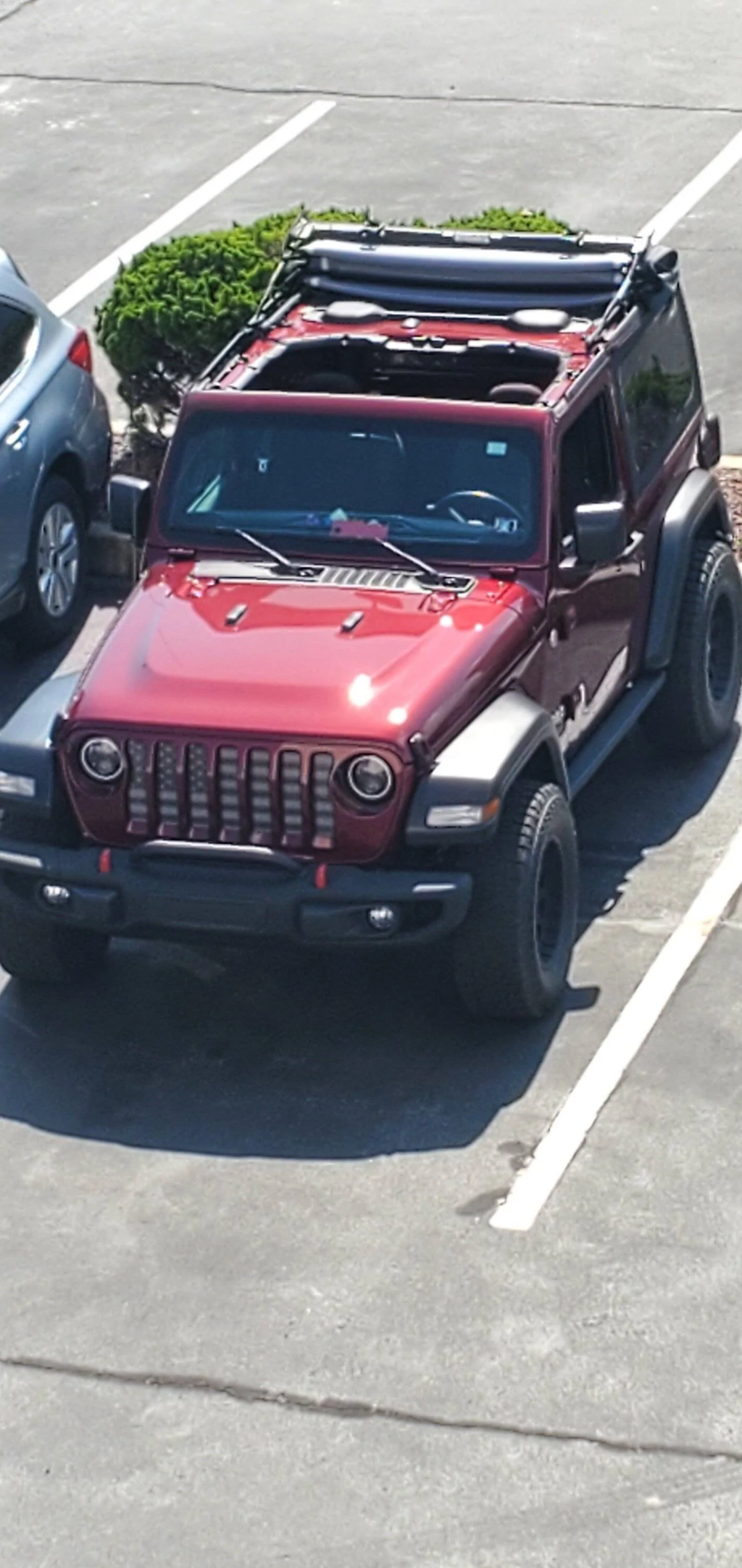

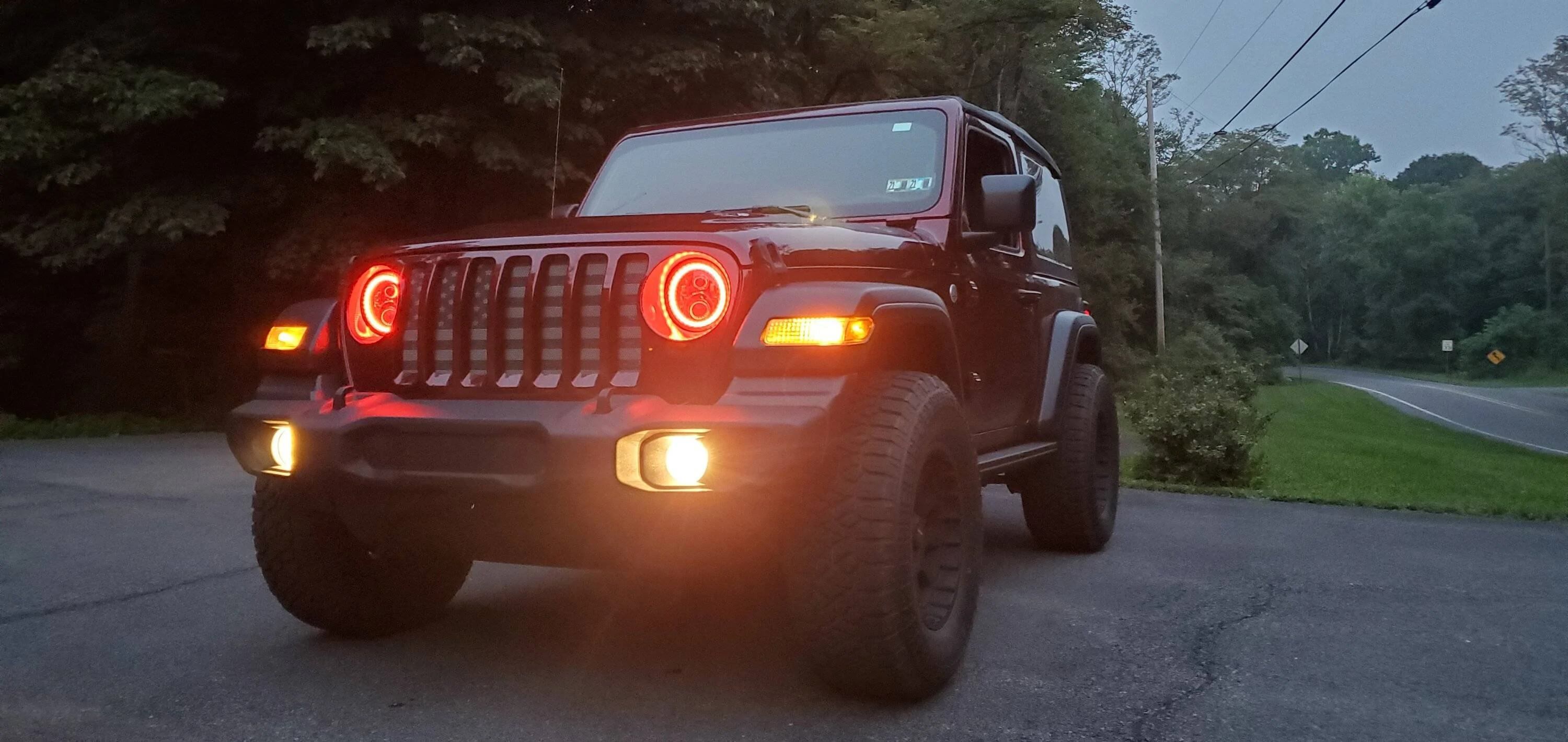

I see now what you mean. I dont think it's so much in the weight as it is in the tire size. I've read people regearing when they get to a 35 or bigger tire. I haven't had any issues with mine running these 285s. And yes, with the sport I have the same gear ratio as your willys. I will say the ride quality improved in mine going to this set up. We use ours for long road trips too without problems.
Can't find any pics from the back but here's a couple more. I dont think they stick out too terrible bad. And without a lift this is the look I was going for.

Jeep Wrangler JL Changing the wheels on a 2023 JLU Willys. 20220113_133825
Jeep Wrangler JL Changing the wheels on a 2023 JLU Willys. 20210720_204258

Those wheels look perfect, but not what I thought the -12's would look like. As said, when I tried just the -12 rim, it did not have a tire fitted.
Are they 17 x 9's? And are your tires LT or P rated?
I think that I might have miscalculated when changing to the +1's. Although, my calculations were based on using a 295 which adds 5mm to the outside compared with 285's, resulting in only a 7mm difference to your setup.
