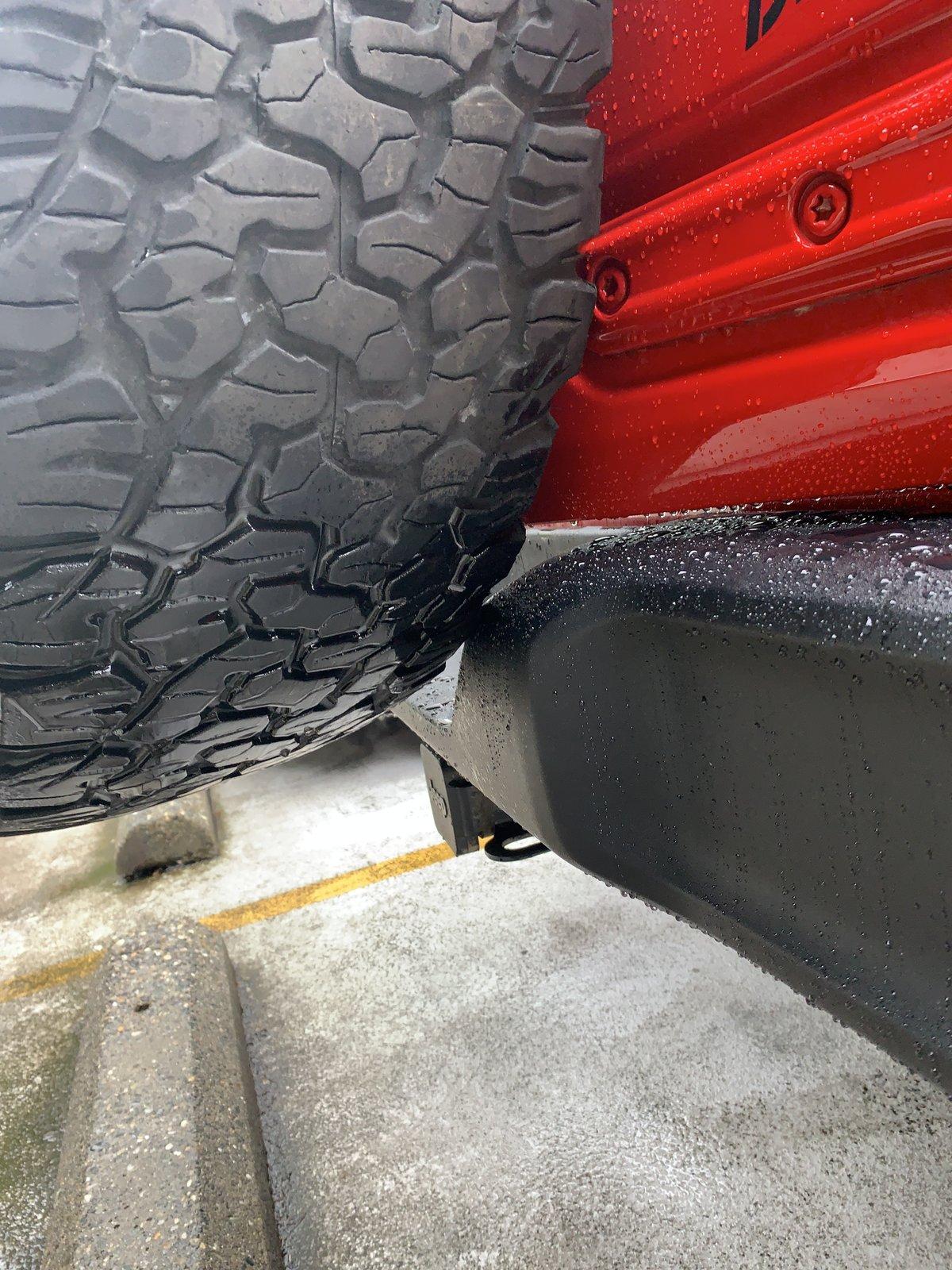

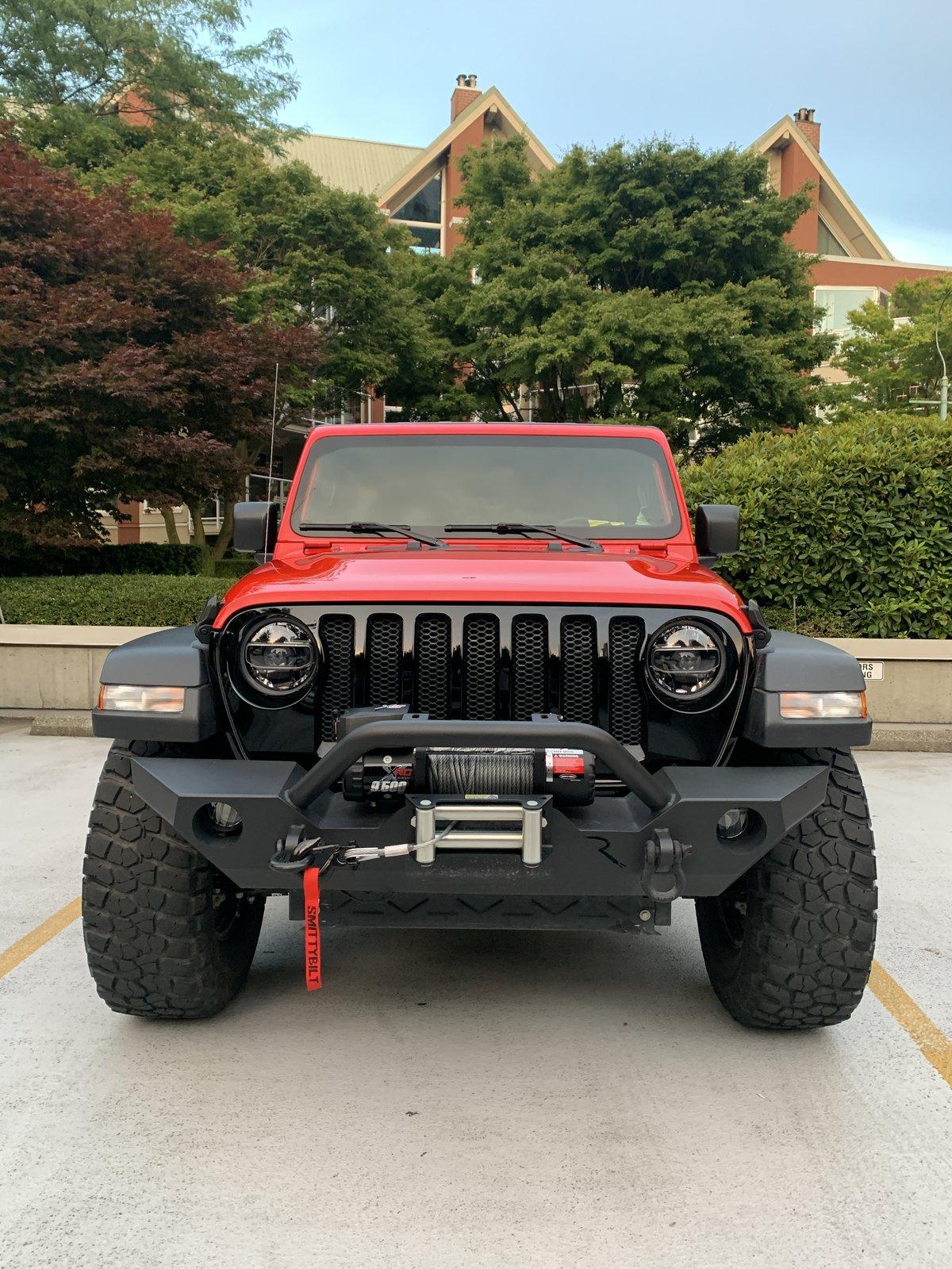

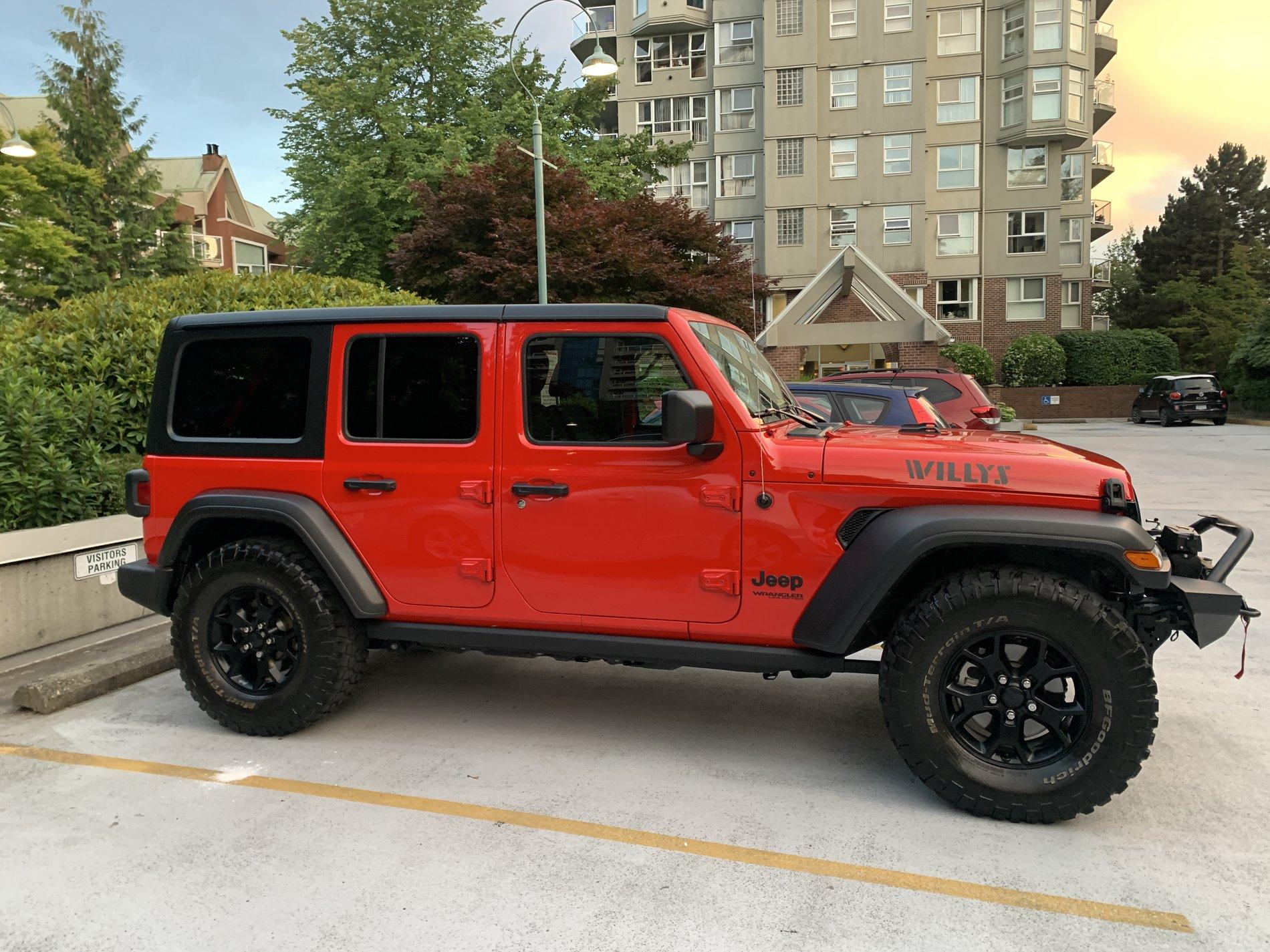

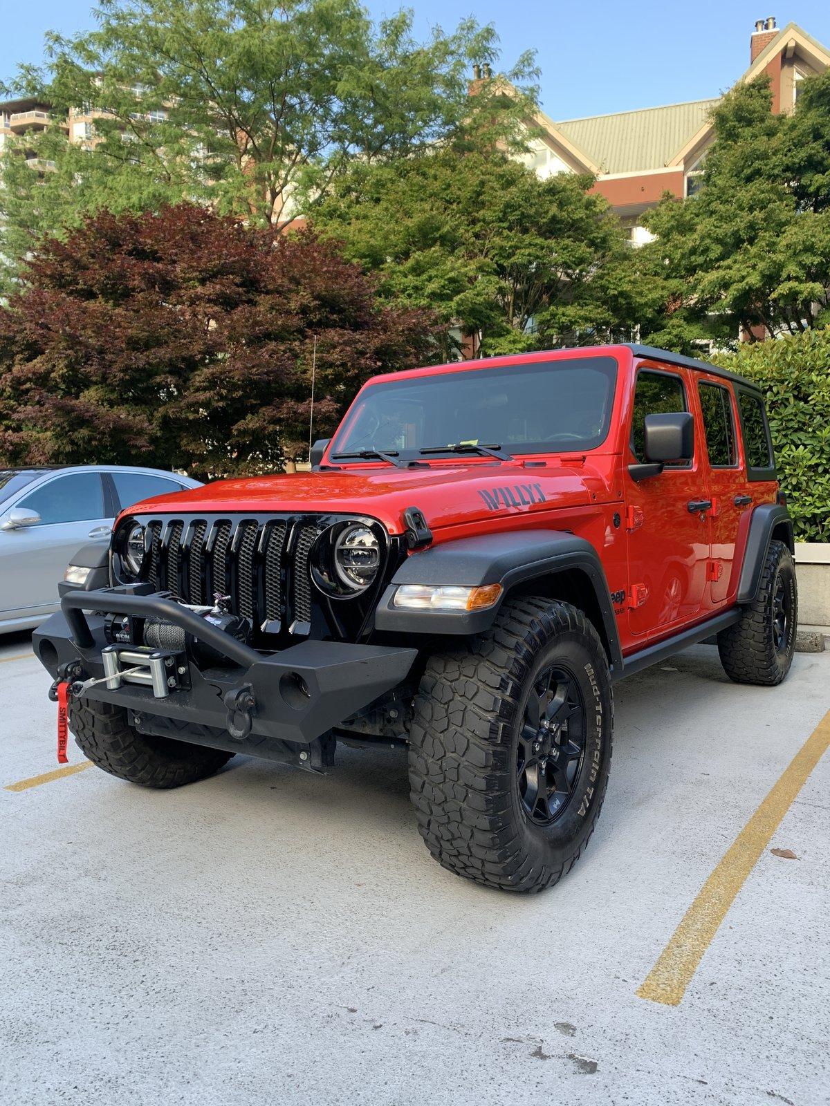

Finding parts for the willys edition could get frustrating as it’s like the rubi and sport had a child and it became this:
In my knowledge, the willys edition is basically a sport with rubi suspension and heavier duty brakes. Was frustrating to try and find the right parts as I never truly knew when ordering if it would fit.
35/12.5/17s BFG Mud terrains with no lift, rubi suspension, sport fenders (but obviously trimmed) and the stock Moab wheels.
Very minimal rubbing at full lock. Will be putting a 2.5 lift once it comes in but I’m loving the stance!
Shop told me they couldn’t get the spare tire on the tail gate which really bothered me. I decided to play around with it myself. Needed to raise the third brake light and an extra hand. It fits but definitely rubs the sport rear bumper which I kind of like since It support: the weight of the tire.
(will be getting a relocation/reinforcement bracket soon):
But yeah, hopefully this helps anyone with a willys edition JLU or a sport with rubi suspension takeoffs that is thinking about getting 35s. It works!

Do you know the spring #s on your Willys? There seems to be some conflicting information about that suspension setup. I've heard it's just Rubicon shocks, and have also heard it's a full shock/spring Rubicon set. Sure looks like you've got more lift than a basic sport :)

Nice looking Jeep. What front bumper do you have on?
You may experience some rubbing off road. After market fenders should fix that.

I would highly recommend a different carrier, rather than a relocation bracket. I chose the Teraflex Alpha HD carrier. It's a very well made piece that allows both height and fore/aft adjustability. In my opinion, it's not a great idea to allow the spare to touch the bumper. Some will argue that it adds support, but when things start getting bouncy the body and frame are designed to move independently of each other. Would you want the bumper pushing on the spare, increasing the stress on the tailgate? The Alpha allows the spare to be mounted higher to fully clear the bumper, and also keeps it in close to the tailgate so the tire remains pressed against the rubber support bumpers. The latter does not happen when using a relocation bracket.
Good job so far.
thank you!
rampage rock rage bumper
Awesome looking Jeep you've put together!
Sound advice. Thank you!!
The Teraflex Alpha HD carrier does not do anything for tailgate or hinge strength/reinforcement, is this correct? I would assume that would be a concern as well?
It simply replaces the factory plastic carrier with added beef and the ability to be adjusted up/down and in/out to keep the spare both tight to the gate and supported by the factory rubber bumpers.
Teraflex was supposed to follow up with a hinged tailgate reinforcement to pair with this carrier, but it sounds like delays are increasing. I'm hearing sometime next year.
The carrier alone is a great solution for someone sticking with 35's, and was otherwise contemplating a couple hundred dollar relocation bracket for their stock carrier. In my opinion, a hinged reinforcement is needed for larger spares on a vehicle that will be bouncing out on the rocks.
I'm now on 38's and am building my Jeep for rock crawling. I can't wait that long for Teraflex, so I'm now eyeing the full Cavfab hinged tire carrier.
