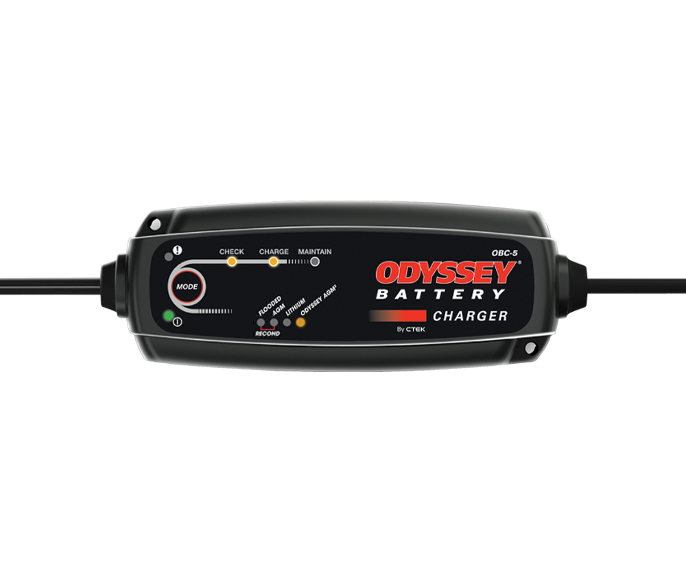

As an aside, I have an Everstart Maxx 15 amp charger with an AGM mode and I also bought a CTEK 5 amp charger that is specifically made for Odyssey batteries and has an "AGM2" mode specifically for Odyssey AGM batteries. I realize that the 5amp is not ideal for an 80ah battery but CTEK, who makes charges specifically for Odyssey said that the 5 amp charger would work for my specific battery but would just charger slower. After paying $350 for the battery I didn't have $275 for the next step up, the CTEK Odyssey specific 15 amp charger. The next step up after that was like a 300 amp charger for around $800 if I remember correctly. So I paid $110 for the 5amp since CTEK said that it would work okay until I could get one rated higher.

Out of curiosity, how long did it last and how often did you maintain it? I ask because I may want to try maintaining it more often than you did as hopefully some insurance. I sure don't want to have to buy another battery for at least 5 years minimum. Ultimately I hope to be able to set my Jeep settings to keep the SOC / state of charge at 12.85 volts so that I don't have to charge it once or twice a month.
Odyssey did discontinue some battery chargers but do sell Odyssey branded batteries made by CTEK. They have a 5 amp @ $110 (which is what I bought), a 15 amp @ 275, and a 25 Amp Charger @ $327. ODYSSEY BATTERY CHARGERS DIRECT What I like about these is that they have an AGM2 mode that is specifically programmed to charge only Odyssey AGM batteries. They sure are expensive! After shelling out $350 for the battery I could only afford to get the 5 amp for the time being. For the price that they sell these for it would seem that it would have a display panel showing the charging rate, amps, volts, % charged, etc. As it is, one doesn't have a clue what it's actually doing and how far along in the charging process that it is.
CTEK has these chargers for sale without the Odyssey branding and without the special AGM2 mode for the same high prices and I am really curious what differences - if any - that the special AGM2 mode has in charging.
The Odyssey-branded "OBC-5" 5A charger that I got is seemingly well made and has some heft to it. It's made to be bolted under the hood as an onboard charger and it has permanent leads that you can connect to the battery posts instead of clamps. It has a simple way to disconnect the charger clamps and connect to the installed permanent battery post leads.
I got 4 years, almost to the day. Symptom it was bad was anti-lock brakes engaging on their own. Fun. See: https://www.jlwranglerforums.com/fo...ults-i-feel-the-brakes-briefly-engage.160589/
I have this charger, and it was expensive. I think it's great, though: https://www.energy-xprt.com/products/odyssey-obc-20a-amp-battery-charger-917729/
You won't want to hear this, but a 5a charger isn't going to cut it. See: https://www.jlwranglerforums.com/fo...acement-question-for-the-experts.66343/page-6
I throw my charge on once a month in warm weather, bi-weekly (or more often) in cold. How do I decide? I keep alternator voltage as my default view on the dash. First trip of the day will always show 14.4-14.6, even on a freshly charged (or even brand new) battery. The second trip it will go down to 13.x. The longer I drive on that second trip, the more it falls. So long as I see it get to 13.1-13.4 I know my battery is healthy and adequately charged. Now, as the battery ages or when it's really cold I'll never get out of 14.4-14.6.
When it never gets lower than 14.6 no matter what, battery is done. That's my anecdotal observation, anyway.
If I were you I would return the CTEK (they are very nice) and get something heftier, even if you go with a lesser brand (e.g. Noco). Or, if you're lucky, you might find the one I have second hand. It really is a gem. Shame they discontinued it. (I never bothered to check if it was just a rebranded one like they now do with CTEK.)
