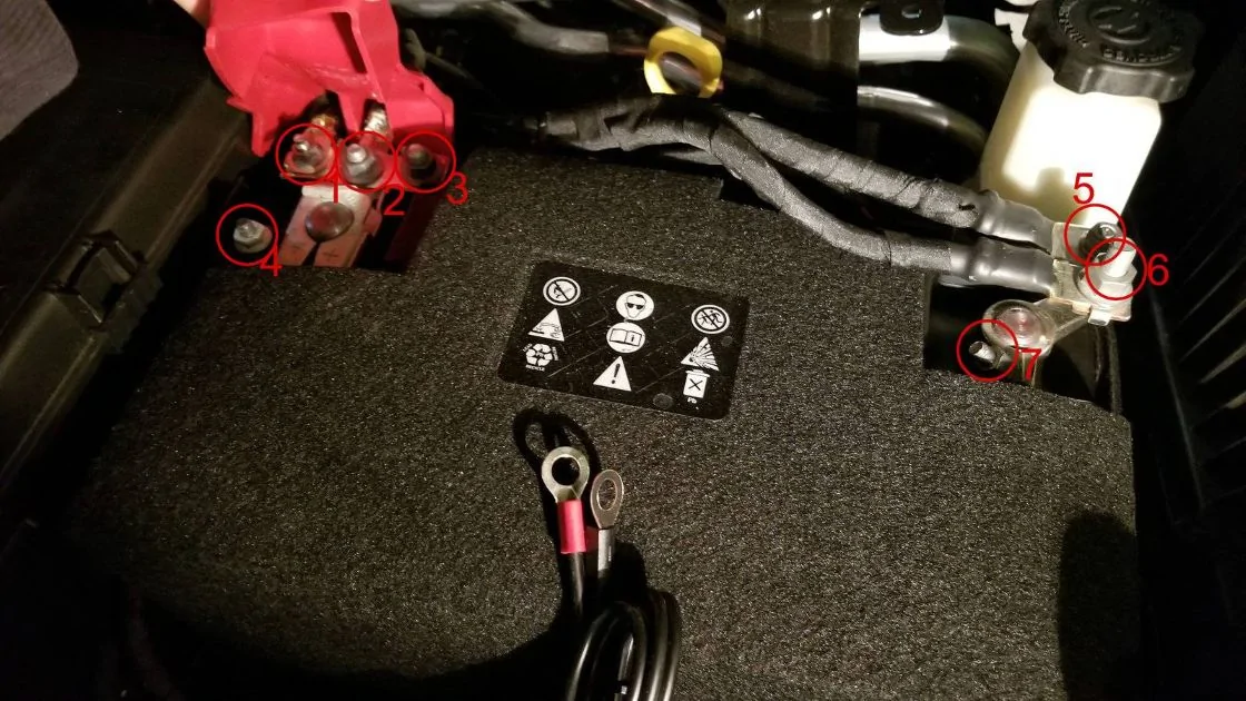

also, there is a thread where I was told it does make a difference where the pigtail is attached to the battery post. Is that true? It was suggested to got to numbers 4 and 7. I did notice that when they installed my battery, they did not set it up this way. I had the pigtail set up that way (4 and 7) before they changed it with the new battery.
below is pic of suggested 4 and 7.

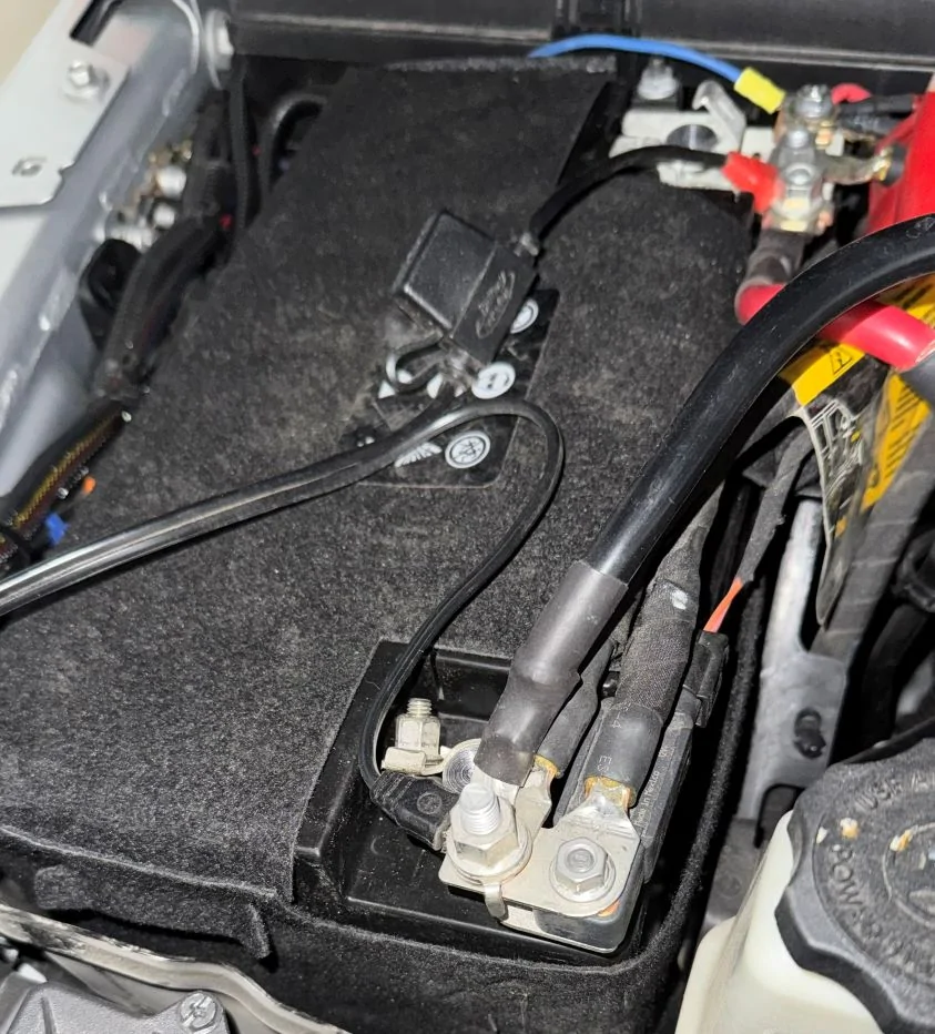

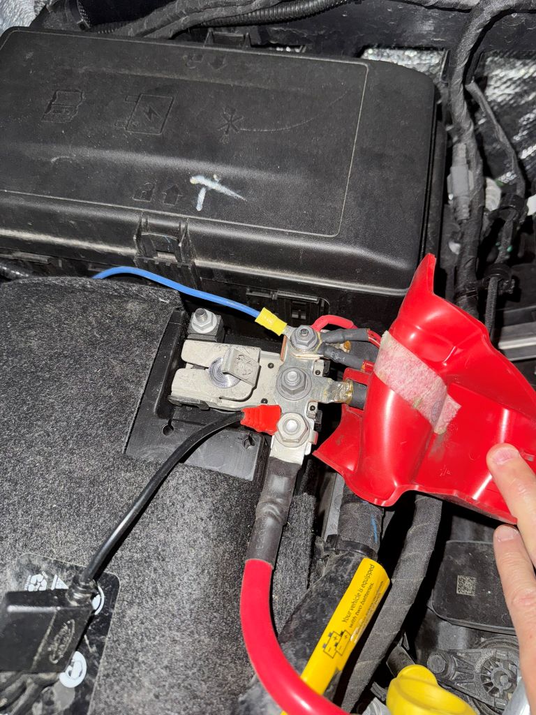

my current battery set up with H7 and pigtail

the post/thread below talking about the way to connect the pigtail so you don't bypass the IBS and other big words I don't understand.
https://www.jlwranglerforums.com/forum/threads/battery-maintainer-question.87013/post-1814538

Aux battery and H6 were fully charged before I added the H7. I don't think the Battery Tender shows a "green light" charged if the aux is depleted. I'm still wondering if it is where I have my pigtails connected to the battery. That is the only thing that is different from the last install, and of course the bigger H7 battery.
