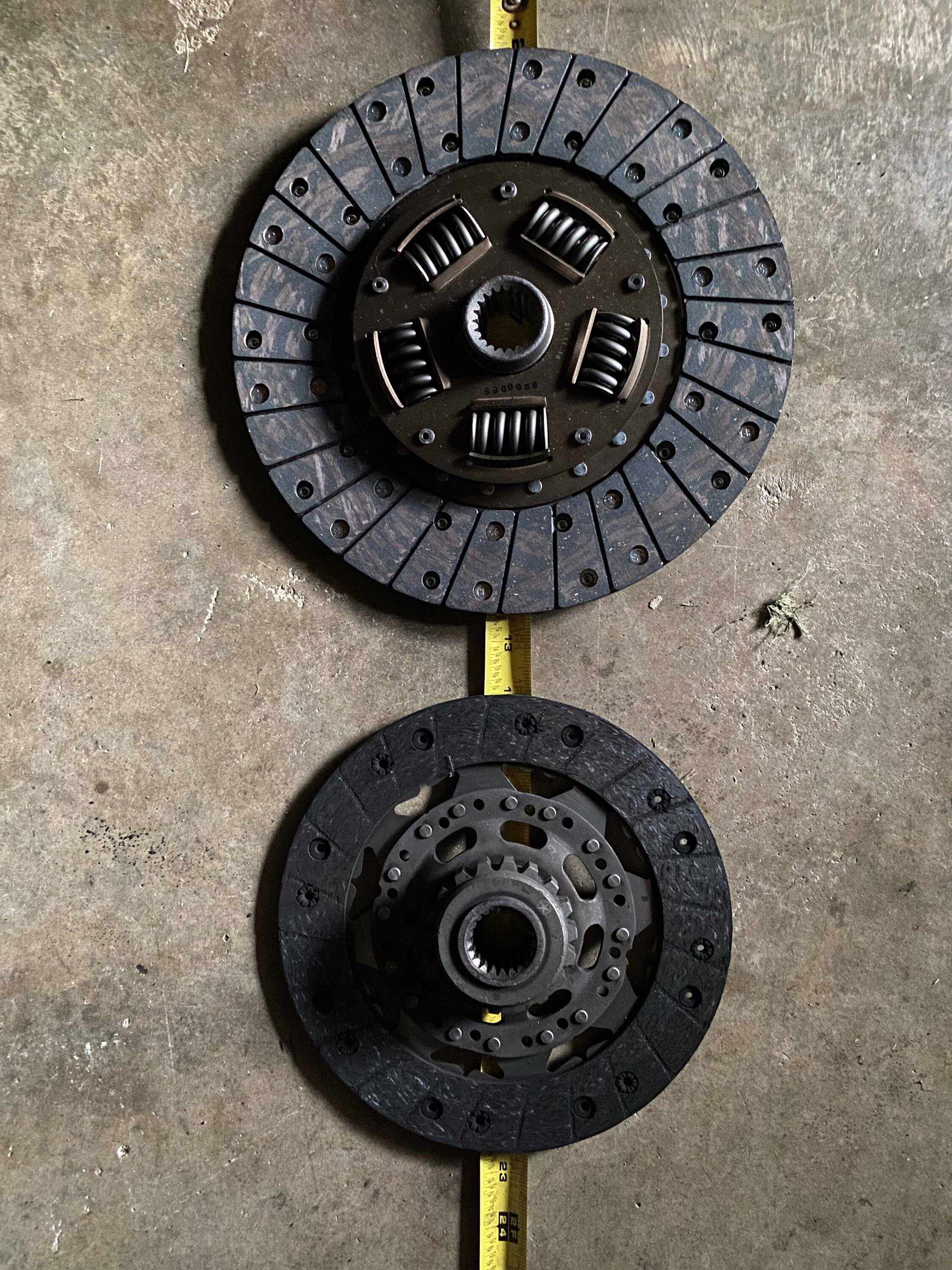

OEM is 8 1/2 and CF II is 10 1/2 inches in diameter.

Some addition observation on the OEM vs CenterForce II
Weights in lbs:
OEM Flywheel - 29.6
CF Flywheel - 43.9
OEM Pressure plate with both clutches - 19.3
CF Pressure plate with clutch - 21.6

The CF II is a straight forward install especially if the shop has installed a clutch in a Jeep JL. LUK is the OEM manufacture for the Jeep JL clutch. Make sure the shop understands/reads the instructions provided in the installation of the CF flywheel especially using the provided ARP bolts 1/4 turn at a time to install it onto the crank shaft. CNC machine work on the CF Flywheel is very high tolerance. Just make sure they don't beat on it with a rubber mallet to install.

The slip you feel is most likely the two "clutch packs" sticking and not engaging smoothly as one unit. You won't experience that with the CF as it is a traditional single disc clutch with predictable engagement. No more guessing when the stock clutch will bite

My 27K 2018 JLUS clutch was slipping so bad that I barely made it home. The new CF II is installed and it's night and day. Very solid engagement with the new unit. The heavier CF II flywheel is a great help in getting it rolling initially. Very happy
