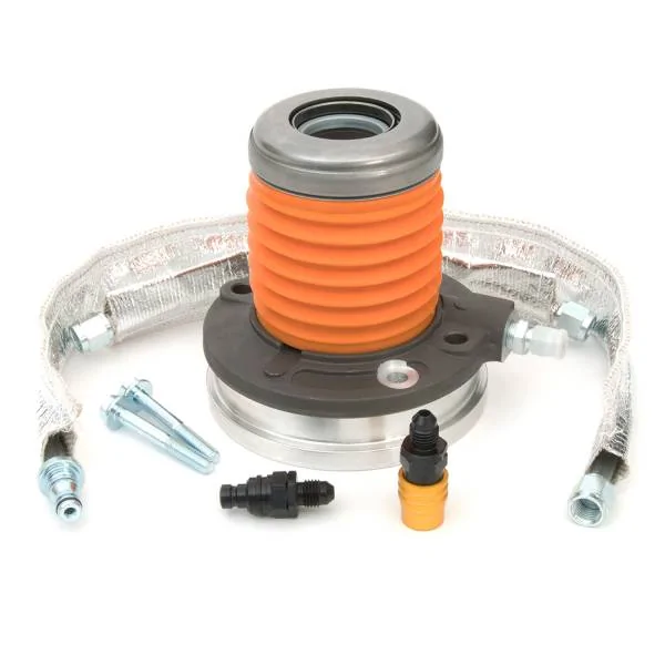

Throw out bearings/slave cylinders are very specific to the application. The front of the transmission where the input shaft is needs to have threaded mounting holes to attach this style slave. This is what I have on my Dakota but it was swapped to a Viper T56. The entire hydraulic system is now Viper specific. The stock Jeep TO bearing uses that yoke shaped lever and does not use threaded mounting holes in the face of the transmission. There might be an adapter plate included, not sure. Mine just uses a spacer to get the distance to the pressure plate correct but it uses the same bolts that the TO bearing does. I can't tell a huge difference between the shaft mounted slave cylinder vs the one mounted outside the tranny but this setup uses a pilot bearing in the crank unlike the Jeep and was not subject to this kind of clutch failure.
soo, now there is another part that needs to be installed? I thought the CF clutch kit included new hoses. What is this part now? Geez, this clutch fix is getting expensive.
No I think that new part is optional, and the CF2 kit I have does come with new hydraulic unit/hose, someone smarter than me can tell you exactly what the new hose does, but I'm sure its an upgrade from the OEM...

I really doubt that CF will offer this hydraulic throw-out bearing for our Jeeps. We are lucky to get these new CF kits today.
Yeah I only see it for a Camaro on the CF website, nothing for the JL

Exactly, I see it for the T56 / 6-speed
That's what I have on my T56 Dakota. All Viper stuff also fits the firewall for master cylinder and the clutch pedal linkage as well. Probably won't get that lucky with the Wrangler and there is a custom spacer usually involved to make the TO bearing work with the PP correctly. I think this style would help with the offset clutch wear as another poster mentioned, axial movement rather than a lever style pivot.
