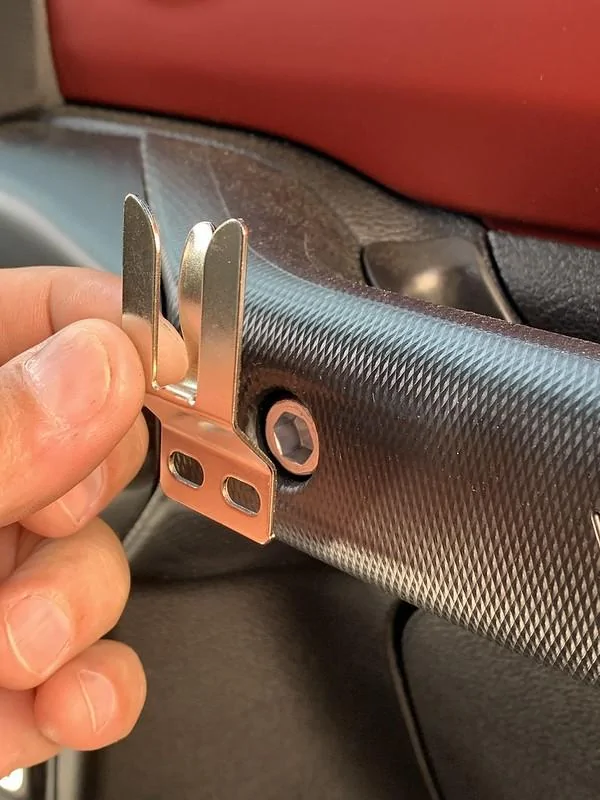

On a side note: I'm leaning toward mounting the mic in the spot on the grab handle where this bolt is...
Jeep Wrangler JL CB hardwire question 50017923952_8c592e89dc_c
Anyone done this? The bolt is recessed and the only thing I can think of is to replace that bolt with a longer one and attach a small mounting plate to it. I just screwed right into the plastic on my old JK's dash for it last time but really do NOT want to drill any holes into the JL dash.

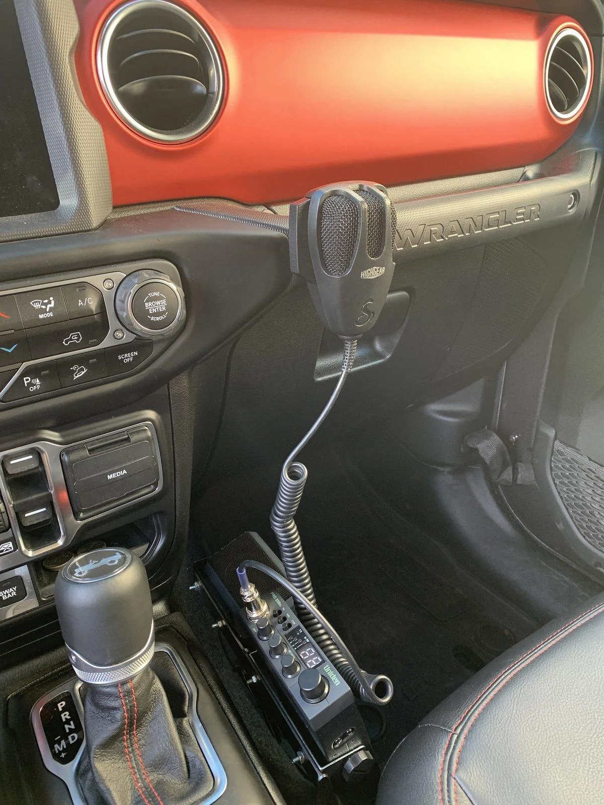

A CB draws little power on receive, unless you don't drive your Jeep for many days it shouldn't be a problem especially if you just leave it on over night.
Yeah I guess. I'm not overly concerned. Maybe I'll just go directly to battery.
Bingo!! I'll think I'll order one. I did get a different longer screw and mount it to the left side of the passenger grab bar however I think it's just a tad too far for my reach to be comfortable. This solves that! Thanks!
Where I currently have it:
Jeep Wrangler JL CB hardwire question 50024868877_f7ed708ad2_k
