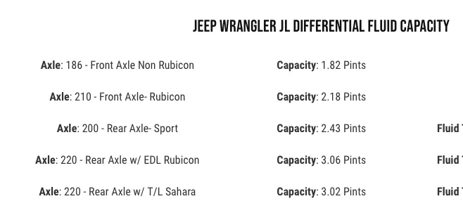

I have these also on my Jl. My question is how much oil and what plug to fill up to front and back
I'm no expert, but my understanding is that these are the same volume as stock and so you should look up which axle you have and use that amount. There are two holes because you might also have a lift which would change the angle so they give you a second higher hole incase you can't get enough in using the lower one. The front diff in mine doesn't have that much fluid in it.
Here is the capacity chart I used and it matches others that I have seen: https://motobilt.com/blogs/first-blog/jeep-wrangler-differential-fluid-capacity-chart#

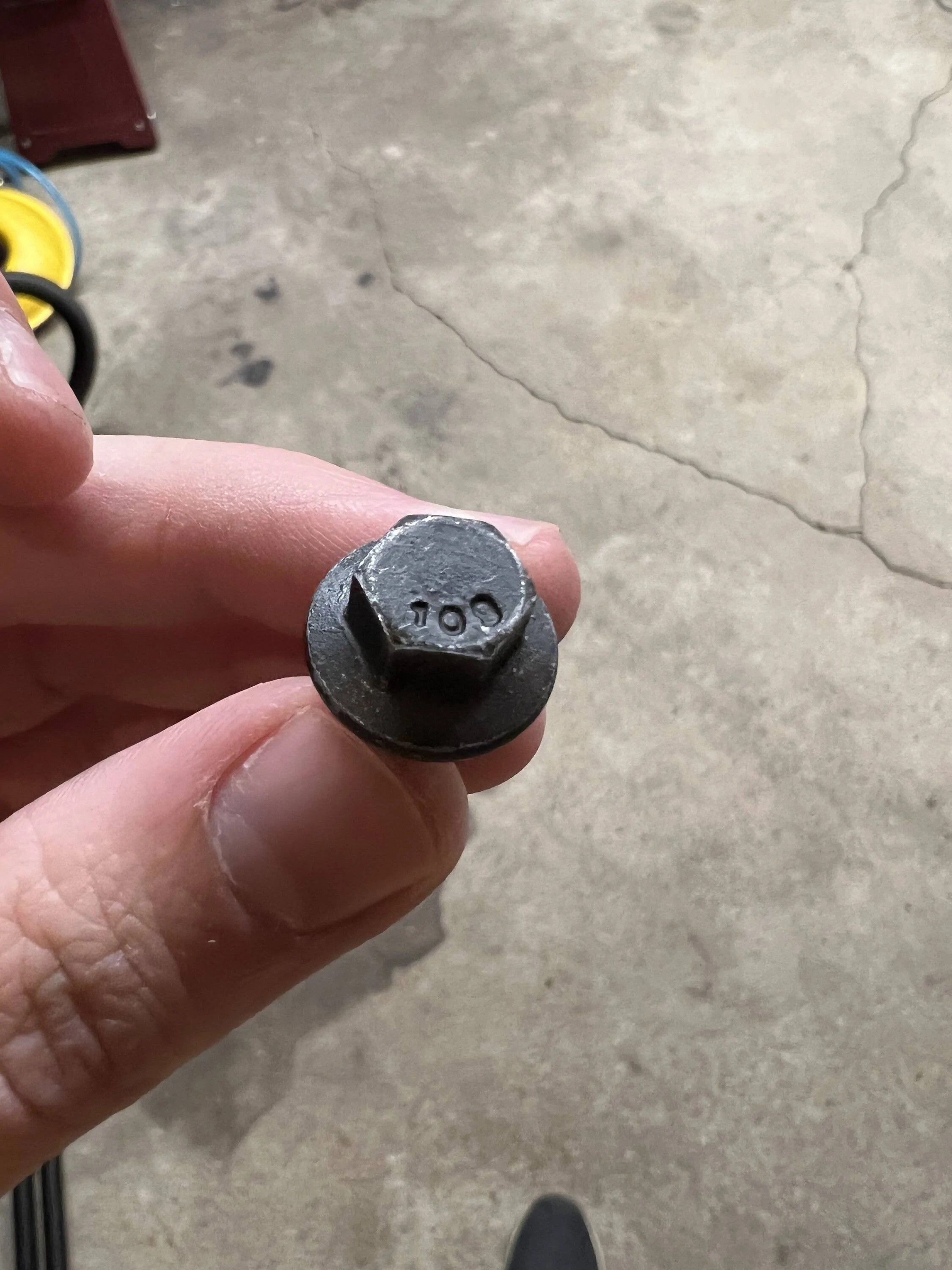

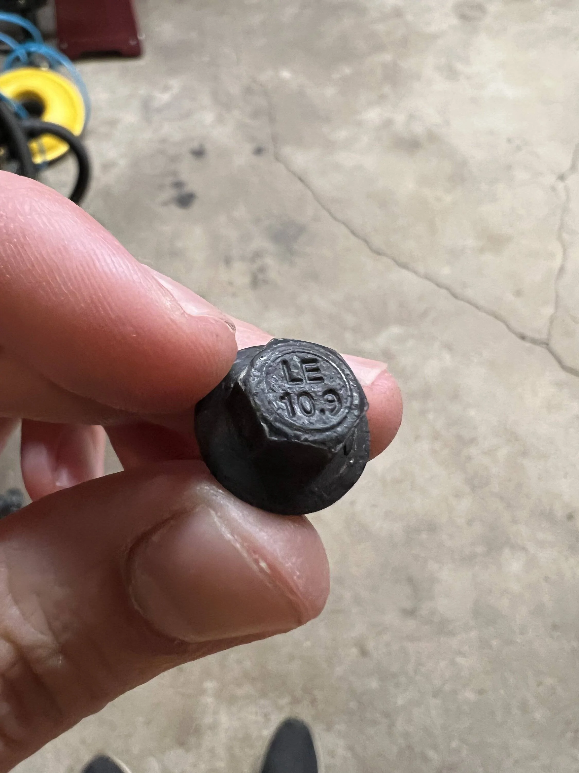

These look like they may be stamped as 10.9 but it’s basically illegible. Metallurgy feels different from OE at a glance. But I’ll be sticking to 20 lb/ft after I fight this out of the housing.
Had the covers off of my first JL often and never had this issue.
First photo is stamping from OE for comparison.

they certainly don't appear to be quality fasteners.
Unfortunately there are plenty of counterfeit fasteners in circulation.
'LE' is the manufacturer's stamp. (legit)
The lower bolt should have one also, but it doesn't. (suspect)
Sorry for the delay in answering. Just saw the notification and reread this post.
The fluid capacity specs that Motobilt had listed are correct for the various JL/JT axles:

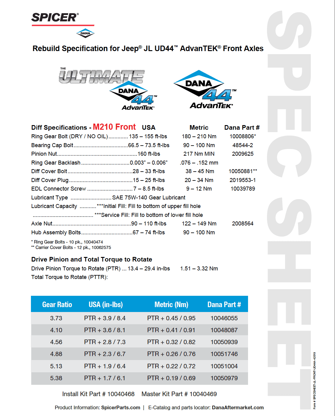

As far as with the Dana aftermarket covers, the only info I could find was the spec sheet that comes with the Ultimate Dana 44 axles. Which states to fill to the top hole on initial fill and to the bottom hole for service fills.
Jeep Wrangler JL *Caution* Dana Spicer Advantek 44 Diff Covers Screen Shot 2022-10-12 at 11.57.33 AM
Dana never has answered me on correct bolt torque with their cover bolts. As per the 10.9 markings on the bolt heads, it should be in that 30 ft-lb range, but with seeing people snap them in that range, dropping bolt torque to 8.8 values would probably be a safer bet.

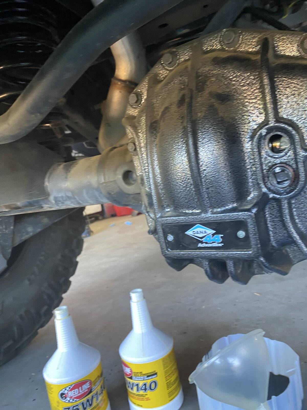

I put these on about 2 years ago. Rubi front and rear. XR with factory 4.56 gears and no issues on long trips with Amsoil 75-90.
