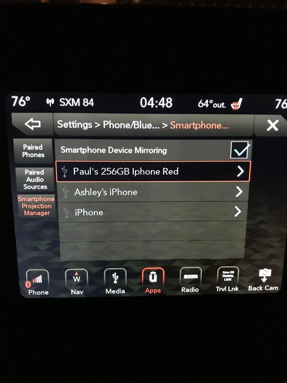

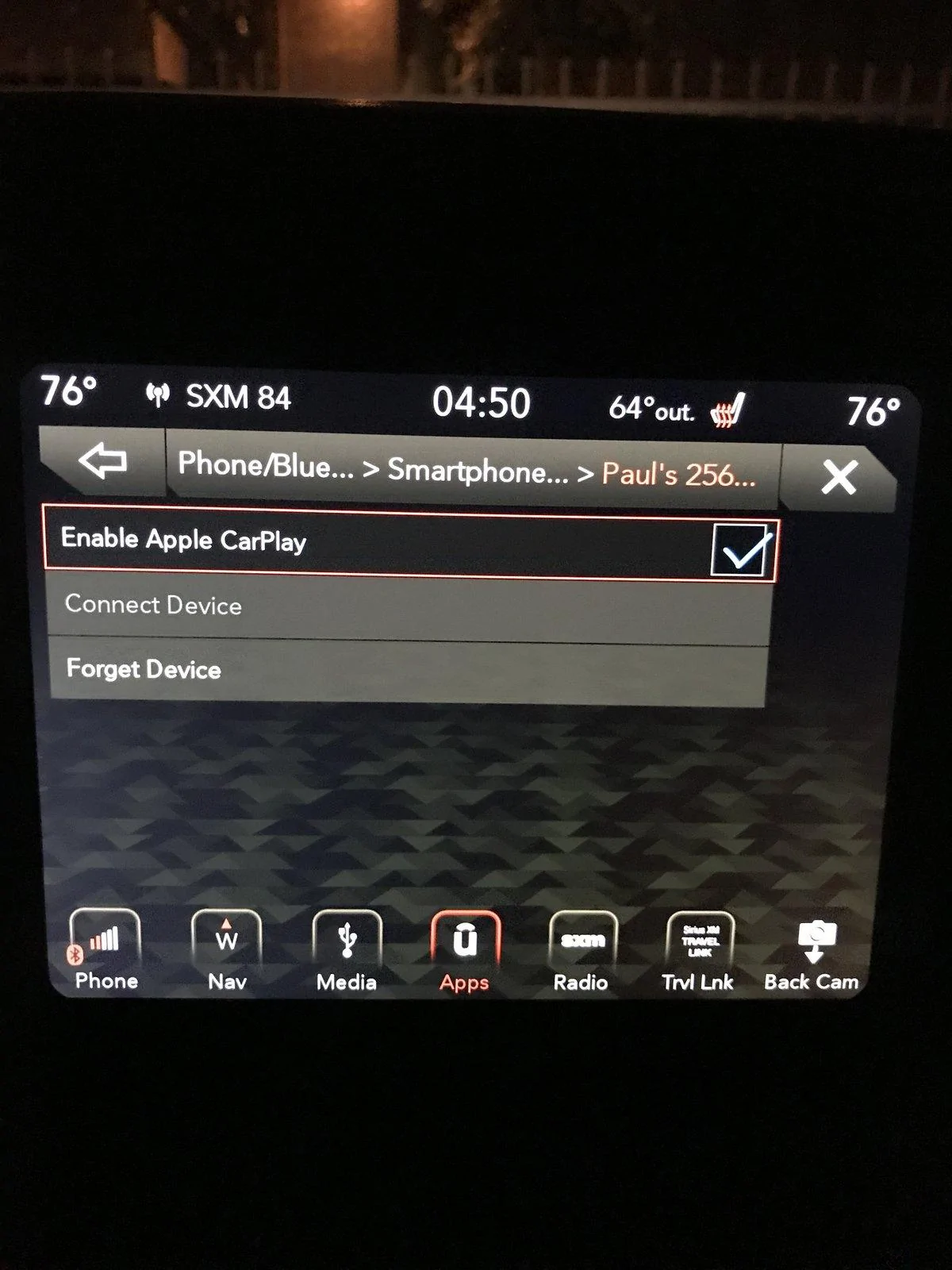

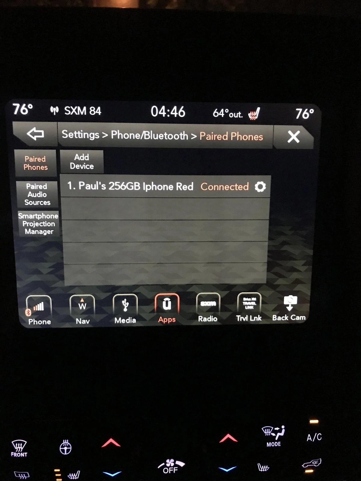

Having the same intermittent CarPlay problems. It mostly happens from the center Console USB port. Tried removing the phone from the projector and the bluetooth settings and rebooting the phone. It doesn't seem like its iOS because when the center Console USB cuts out (it still charges but you cannot use CarPlay or USB reading) and I plug it into the media USB carpal then works. 6 days with the jeep.
Today tried out a few things. Wife has iPhone 6s Plus and I have iPhone 7 Plus. Tried both our phones, 3 different cables and and all combinations of usb plugs on the Jeep. The. Checked settings on each phone. Nothing worked. At this point I ruled out the phones being the issue. I then started messing with settings/options on the Jeep. Honestly I just pressed butttons to see if anything would work.
Note: I have JL Unlimited Rubicon with the Infotainment Group (8.4ā€ display).
Try this:
1. Settings
2. Scroll down to Phone/Bluetooth
From this menu I just went through all the settings. Made sure it was actually connected (see photo). For both ā€œPaired Phonesā€ and ā€œPaired Audio Sourcesā€ options. Next menu option is Smartphone Projection Manager (See photo). Then pressed on ā€œPaul's...ā€ phone and pressed on ā€œEnable Apple CarPlayā€ if it wasn’t already not sure. (See Photo).

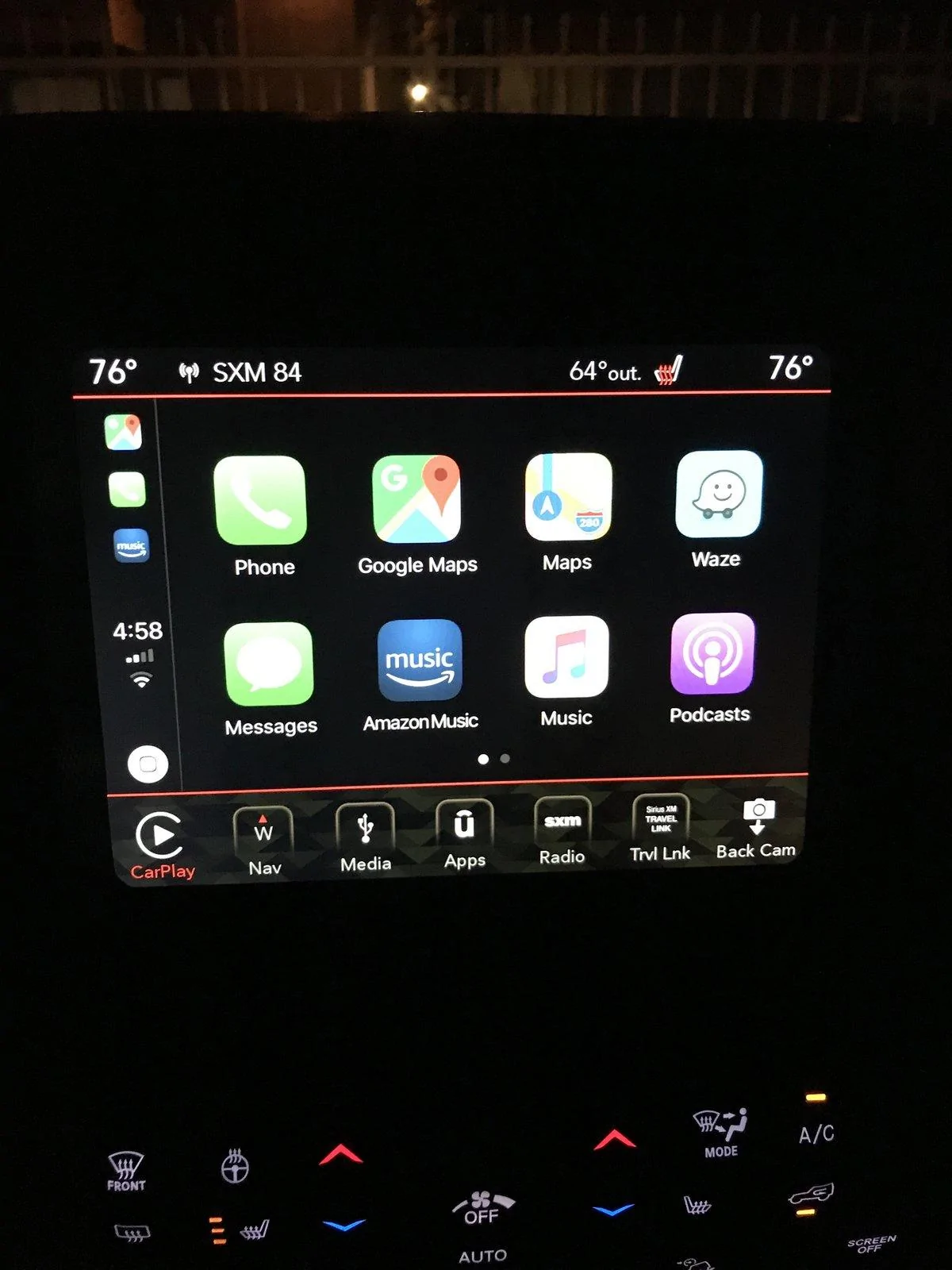

Then I plugged in my phone to each USB (1, 2, 3).
Notification on my phone said to unlock. So I did...and voila it worked!!!
Not sure what made it work exactly, mind you I just pressed buttons...
Let me know if this works for anyone!
Good luck!
