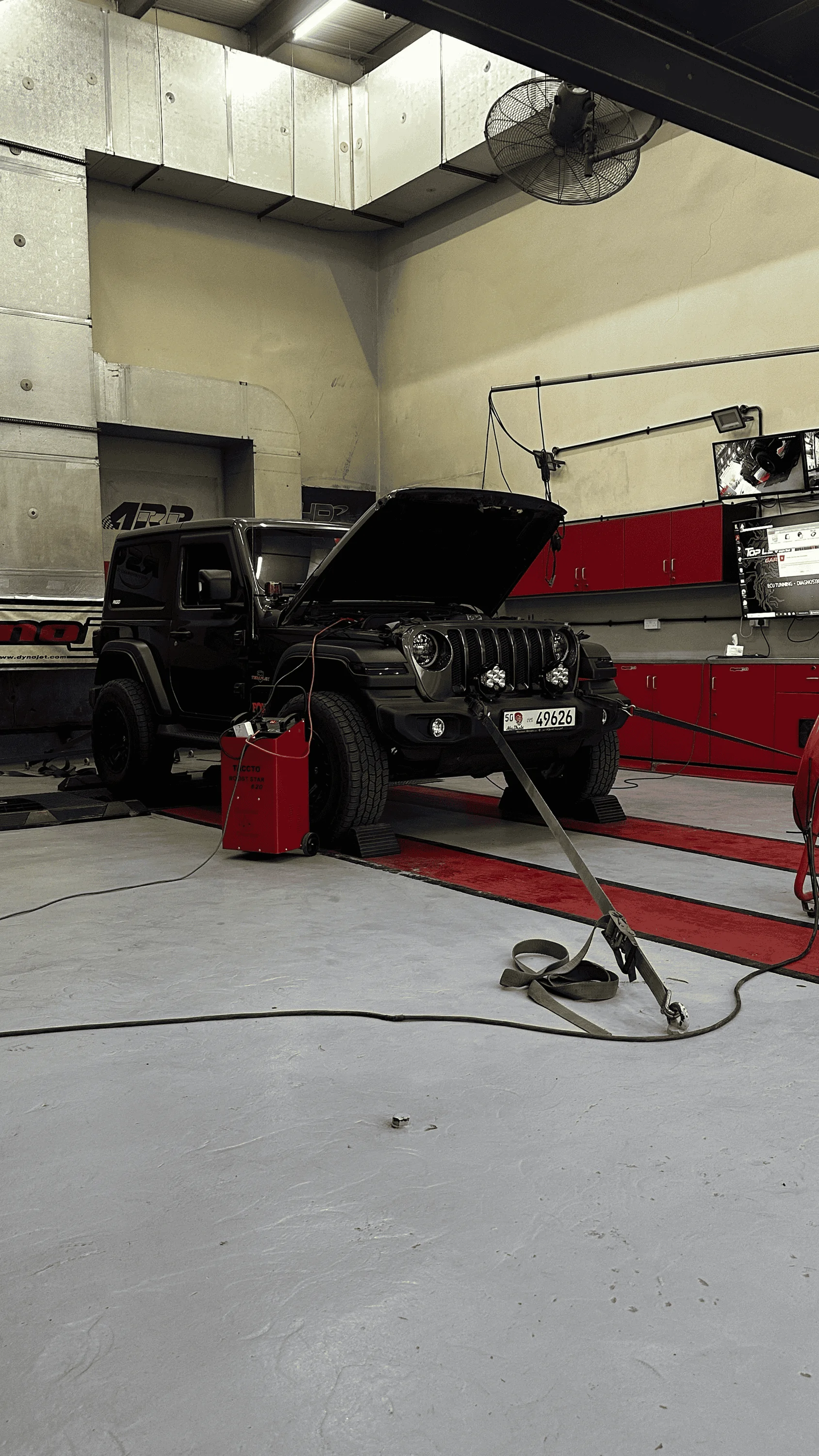

Jeep Wrangler JL can't understand this oil leaking tempImageQGBPOk
