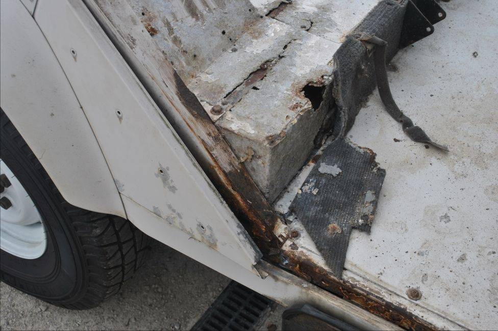

The worst thing that can happen is your Jeep eventually starts looking like a Landrover. ;)
Old Defenders are well known for dissimilar metal corrosion.
Here the floor and rear body tub are (were!) aluminium, the seat brackets, chassis and door frames are steel. Road salt speeds up the reaction.
