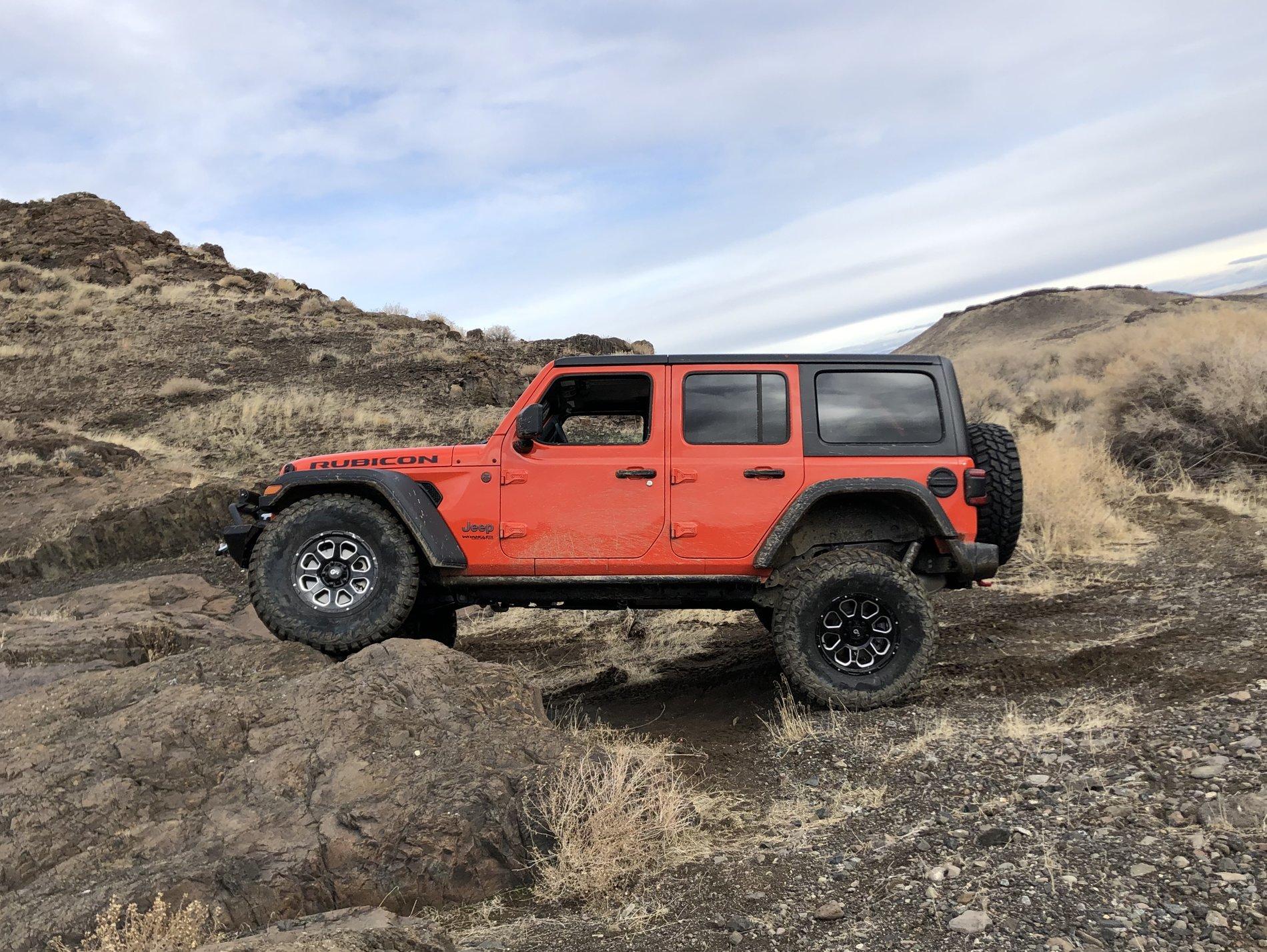

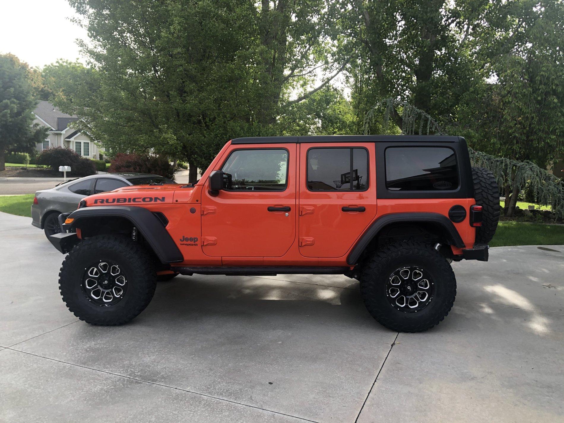

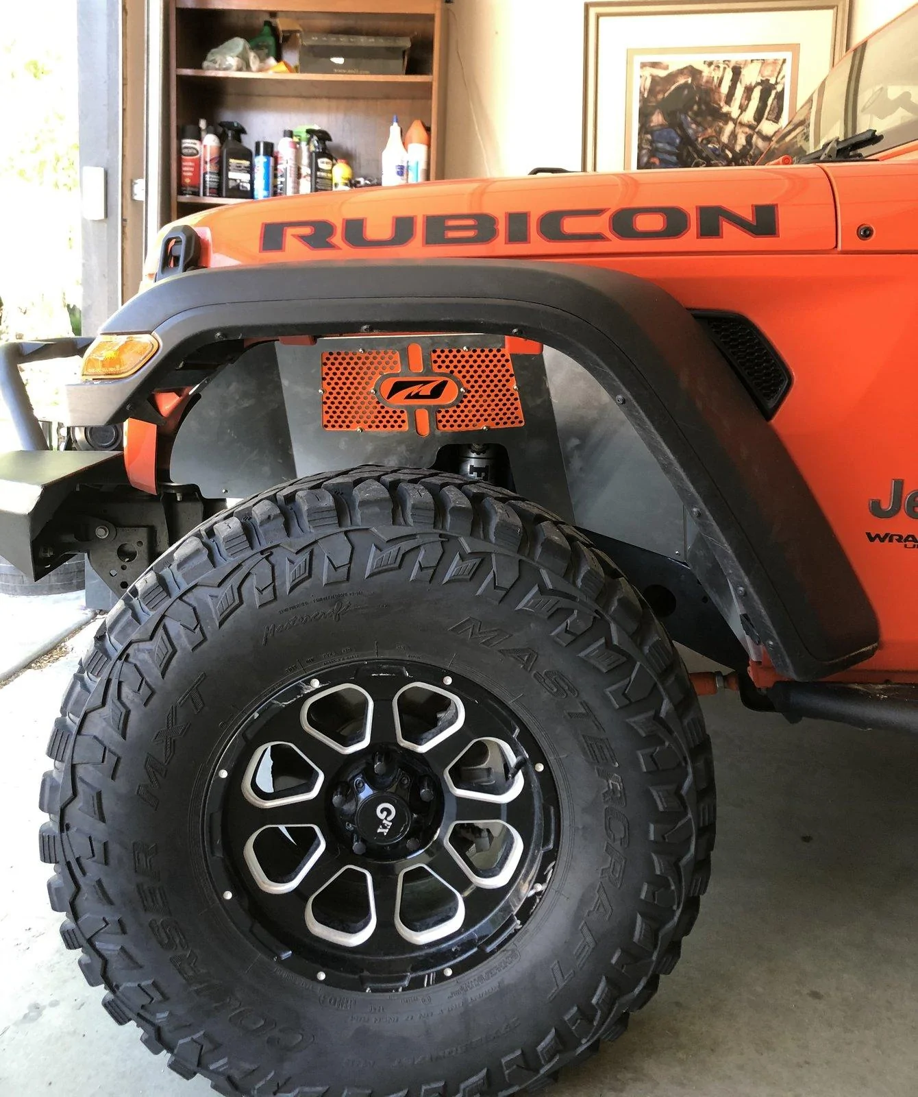

Very nice. Whst size wheels are those?
Mikeyut3
Mikeyut3
Michael
May 15, 2020
58
428
330
07901
2020 JLUR
17x9+12 offset. 37x12.5 mastercraft mxt tires. Use it too.

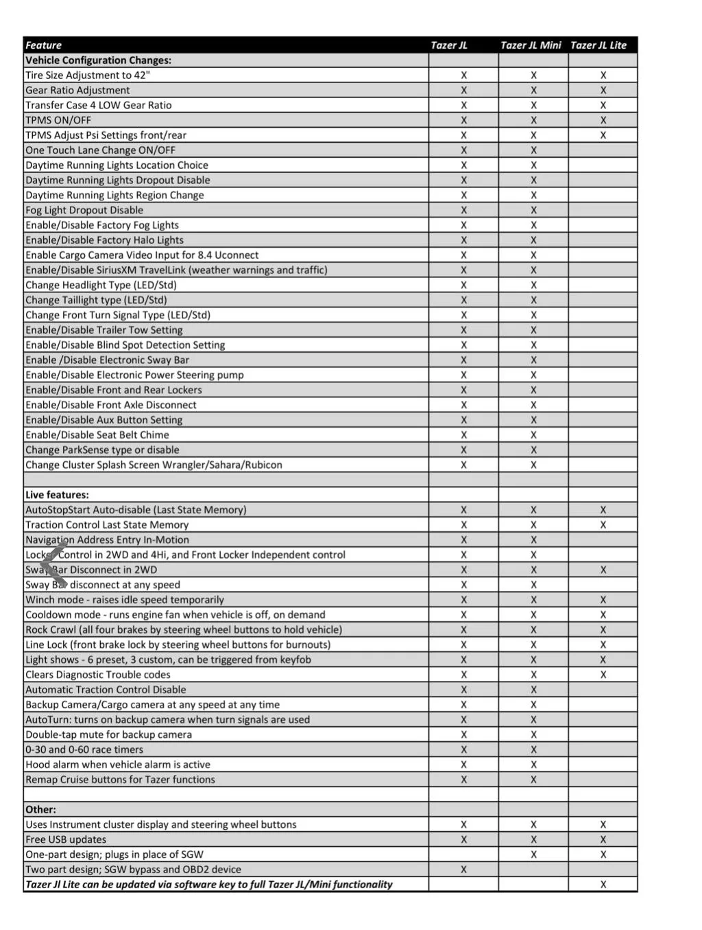

Personally with the rubicon I would get the full for around $300 I believe. I can’t remember exactly. I’ll post a comparison shot here for you to see. If you off road much the sway kill function allows you to disconnect sway bar in 2wd and at any speeds. Factory is in 4wd only and only up to 18mph. Then when you run larger tires your psi will be around 30 vs stock at 37 so may have tpms light on all the time. Tazer allows you to change the light threshold to 25 or whatever you desire so your light isn’t always on. Also does a lot more, but those are the main ones I use along with start/stop kill. The light does some just have to see if you’d use enough of the extra ones on the full/mini.

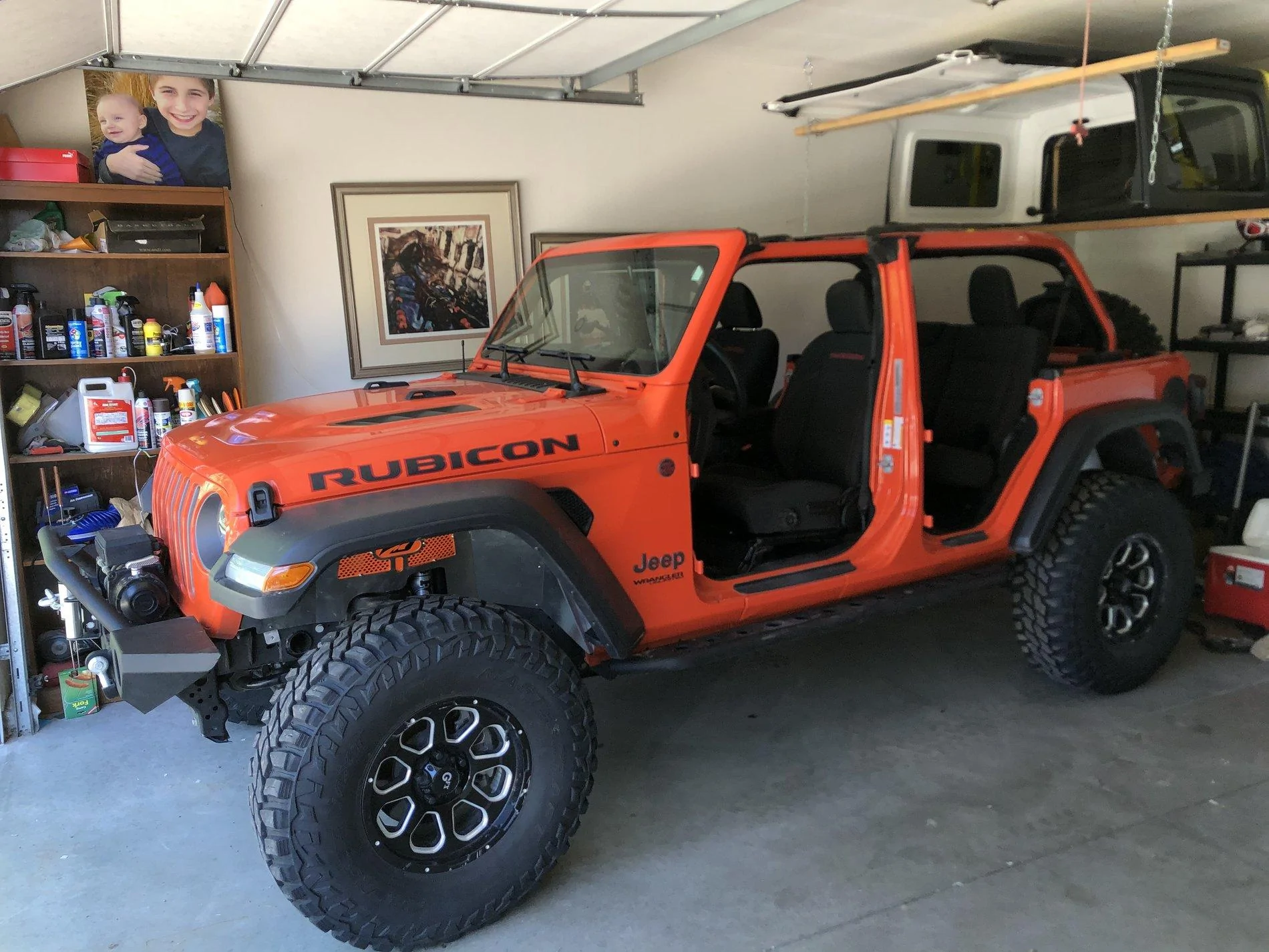

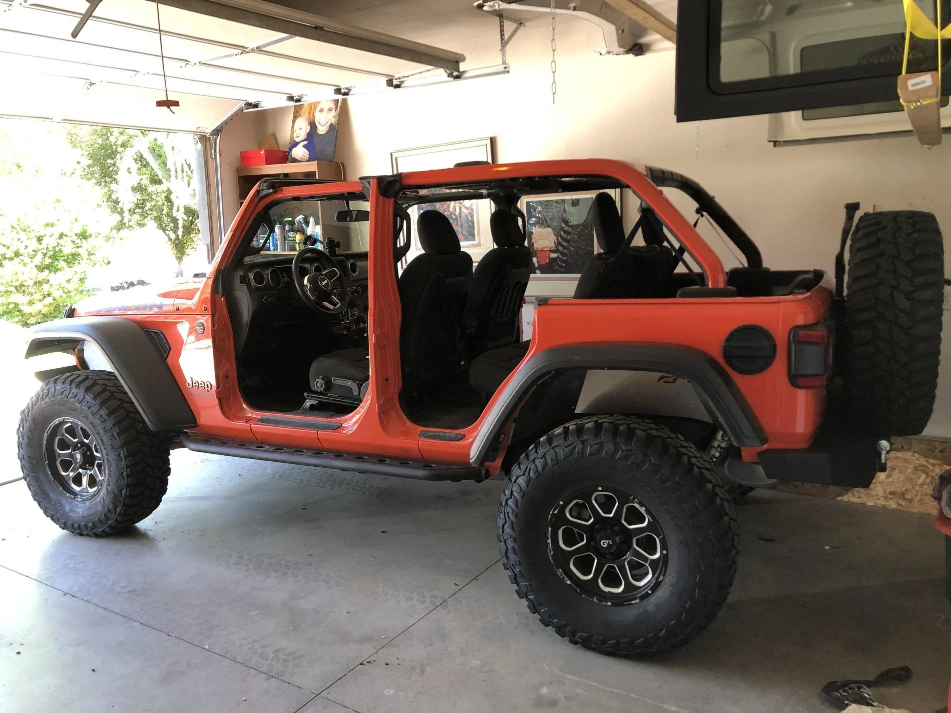

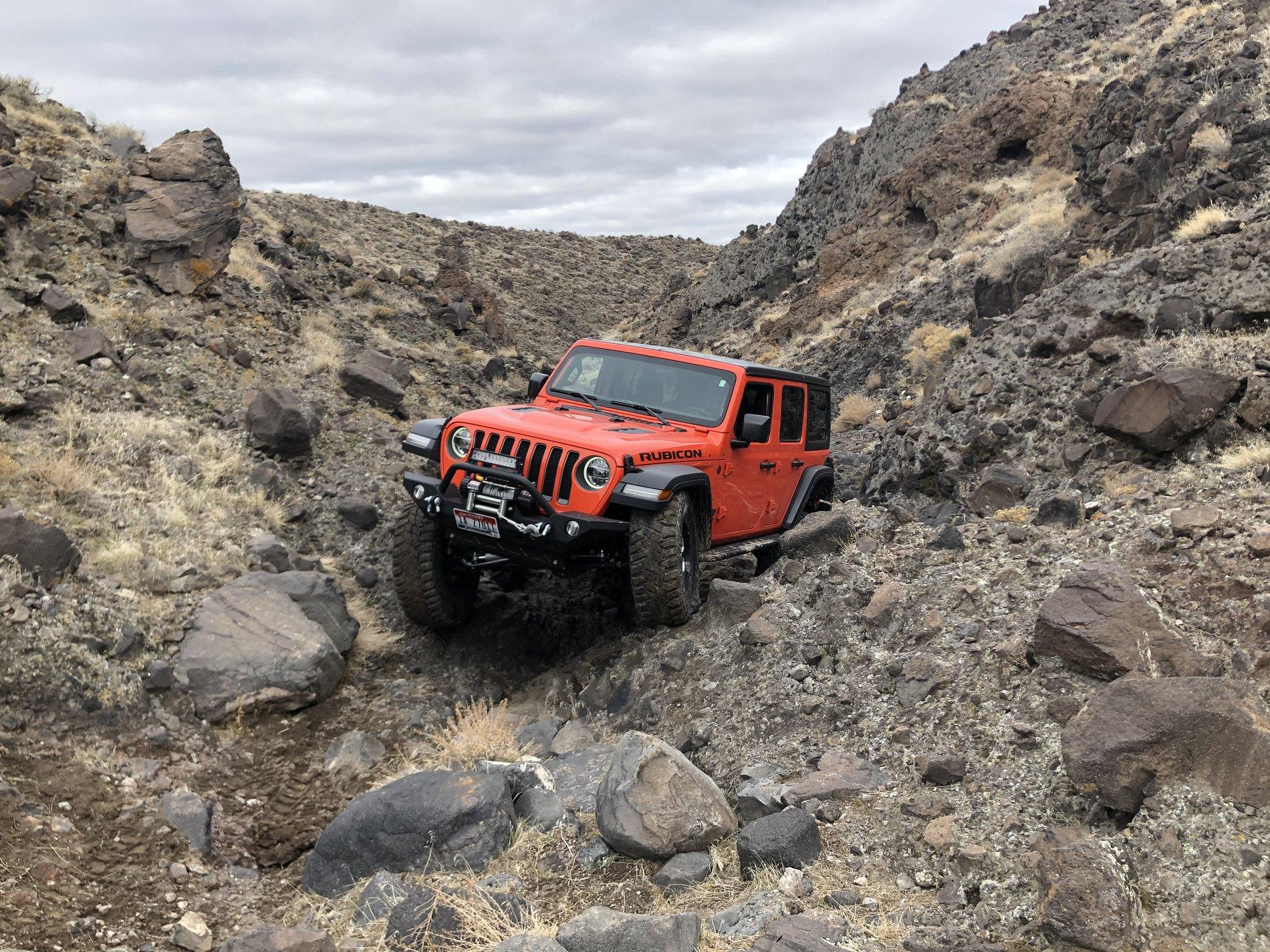

Nice pics...how many bumpstops are you running and how much do your tires rub wheelin when flexed up and turning?

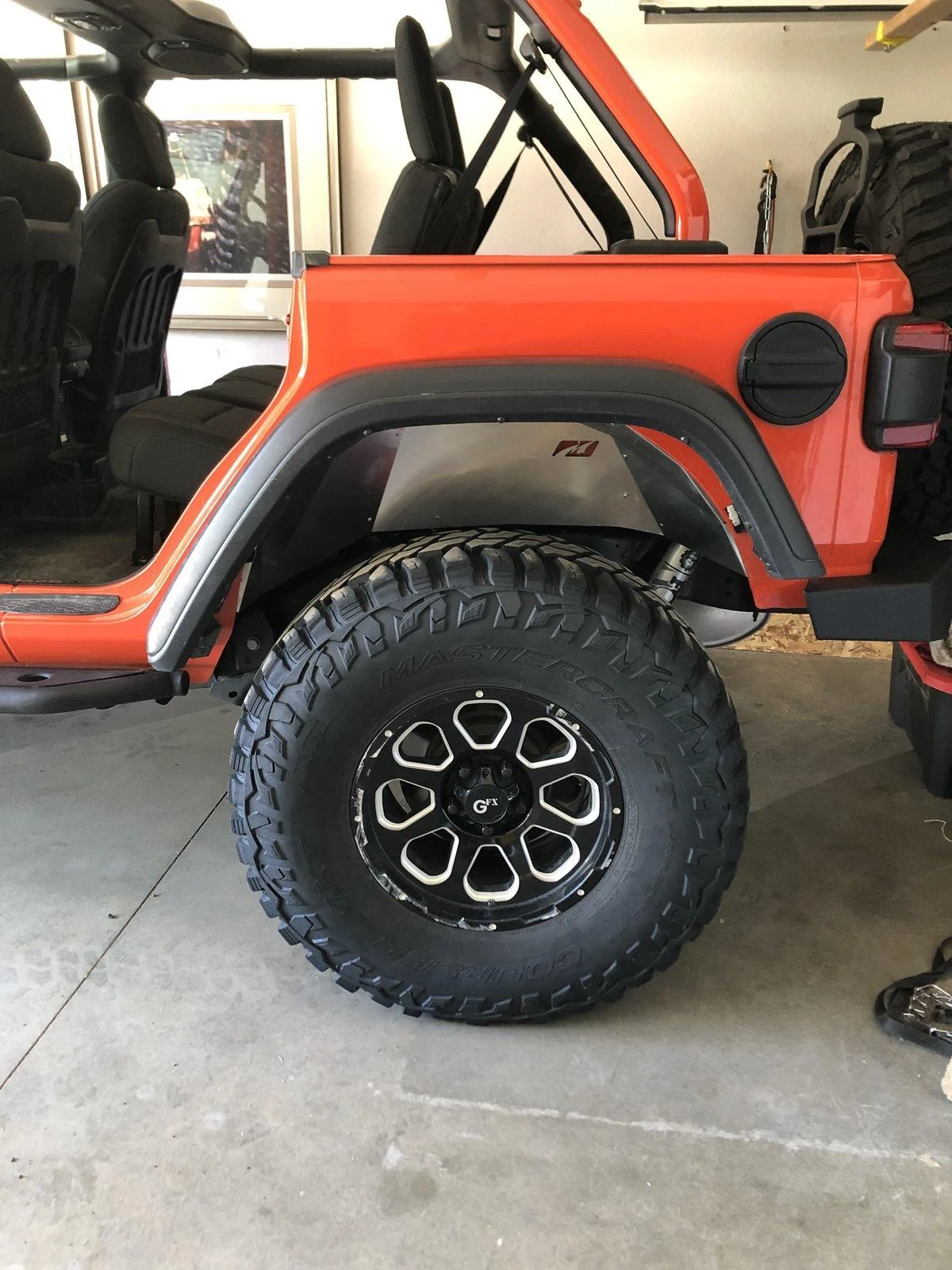

Just the bump stops that came with the mopar lift. Think they are about 2 inches front and back. Can measure them if you want. Minor rub in the rear inner fenders and if I have passengers it will rub a little more but overall pretty minor. None on the front that I’ve noticed at all. I am putting motobilt inner fenders in front and rear later today or Thursday which may help a little with the rear rub. We will see. Like I say, it’s real minor.

Nice...I installed motobilt rear liners and artec knockoff front liners a few weeks ago and like them. I used a nutsert on the driver side due to access. I'm also running 2" bumpstops and have 17x8.5 wheels 4.75 backspacing(0 offset) and 37s rub the front inner liners a bit when flexing up and turning a decent amount. I imagine yours would rub a little more with +12 offset wheels...think a backpacing of 4.25 or less would clear 37s in front at full stuff and full lock.

It tucks up under the flare so I will let you know. Haven’t had any rubs in the front though so we will see after inner fender install.

Here’s the liners. Sorry for borrowing your thread OP!
