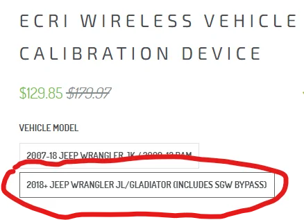

If you wish to go the ECRI route, you need to purchase the bundle that includes the Security Gateway Bypass and the ECRI module for the 2018+ JL.
would that be the "lifetime vehicle unlock" they charge for? You can either buy it now or "purchase later" and the price drops like $40 if you don't buy it. And from what I see, this seems easier than all the wiring harnesses than with JSCAN solutions?

@ejewels
Jeep Wrangler JL Calibration after new tires 1709150091828
I believe you need to purchase the unlock for 1 vehicle one way or the other. I believe it is done upfront via the lifetime purchase or in the app.
The harness I linked to above is optional, but many purchase it to use with the ECRI bypass module or a Tazer to make the connections easier.

@ejewels
thanks, are you talking about the extension cable you linked? In their ad, it looks like it just plugs in right under the dash/steering wheel. Is this not the actual case for our JLs? I'll buy it if its necessary. at $130 (or more if I get that cable) and a lifetime of changes, I'm sure this is the best route considering I guarantee my dealer will charge more. I'm also assuming this won't void warranty? Back when I had my APR tuned GTI, the dealer could tell if you flashed your vehicle... not sure if the same applies with Jeep.
