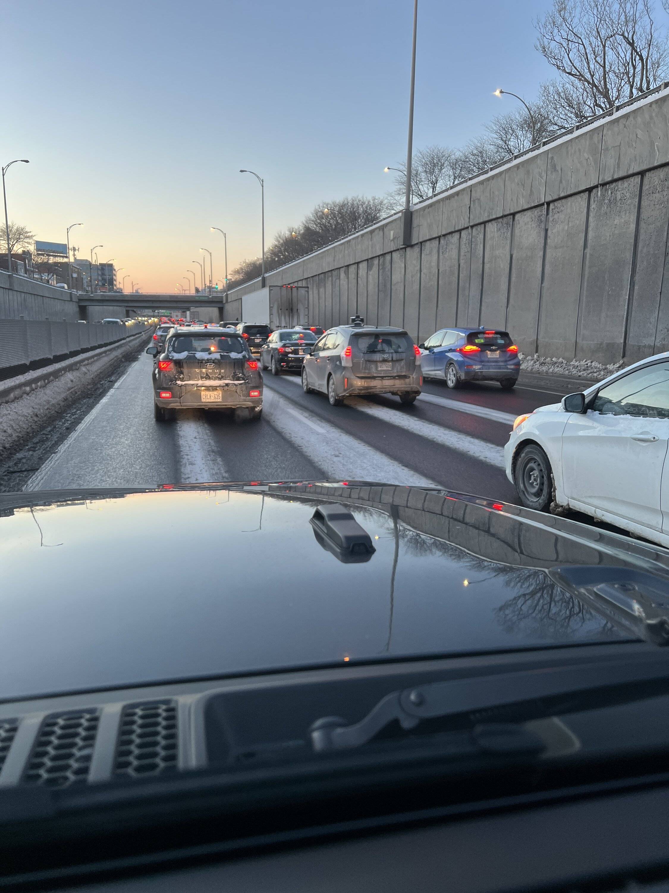

Happened to snap a pic(clean windshield) of the traffic yesterday after picking up my Jeep from the body shop.

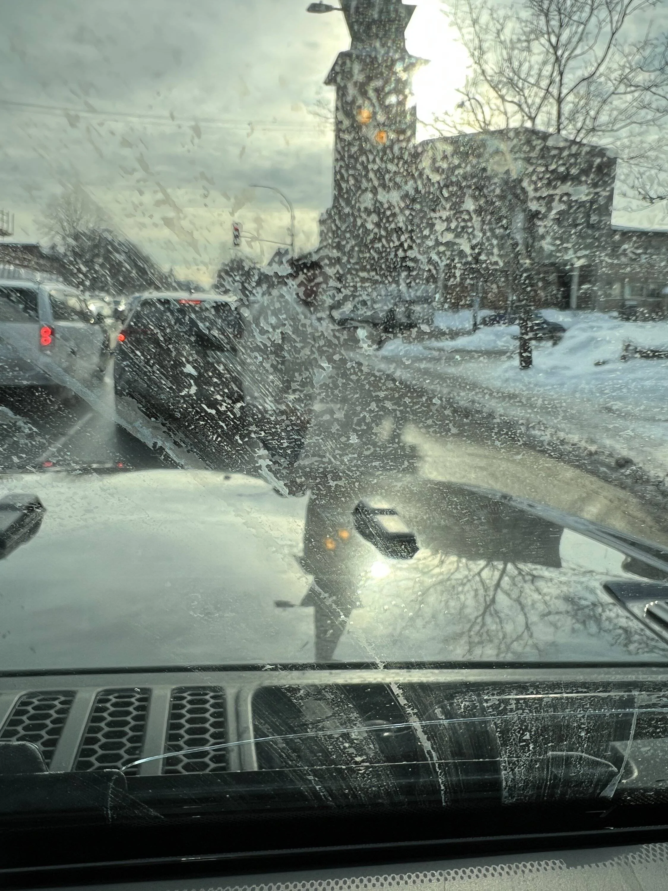

This morning was a decently cold one and as I'm driving to an appointment, I hear a small crack...a few minutes later I see the newly formed crack in the windshield (dirty windshield)!
Like WTH?
Can't see any impact mark. Crazy that these windshields are so prone to cracking, seemingly from the cold today

probably caused by the defroster - there's several threads. Happened to mine.

Yeah probably. But that is a little ridiculous. I’ve owned dozens of cars and this morning was cold, but not as cold as it gets. Never expected this

I have similar crack, the rock hit in the seal area below the wiper on the windshield and it finally cracked the rest of the way after defroster.

Seriously though, a few other folks have had similar issues with what is apparently sudden changes in temp. I agree, OP, that it shouldn't be a thing in this day and age, but apparently it is.

I have had a crack start in very similar location and run like yours. Seen others similarly so. I’m thinking there is some induced stress put on the windshield during installation and rapid temp differences inside vs outside cause it.
It would be interesting to see if the installer is bending the glass a little when they seat it in the frame.
