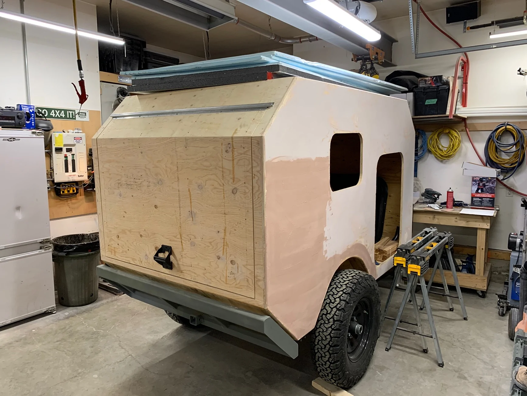

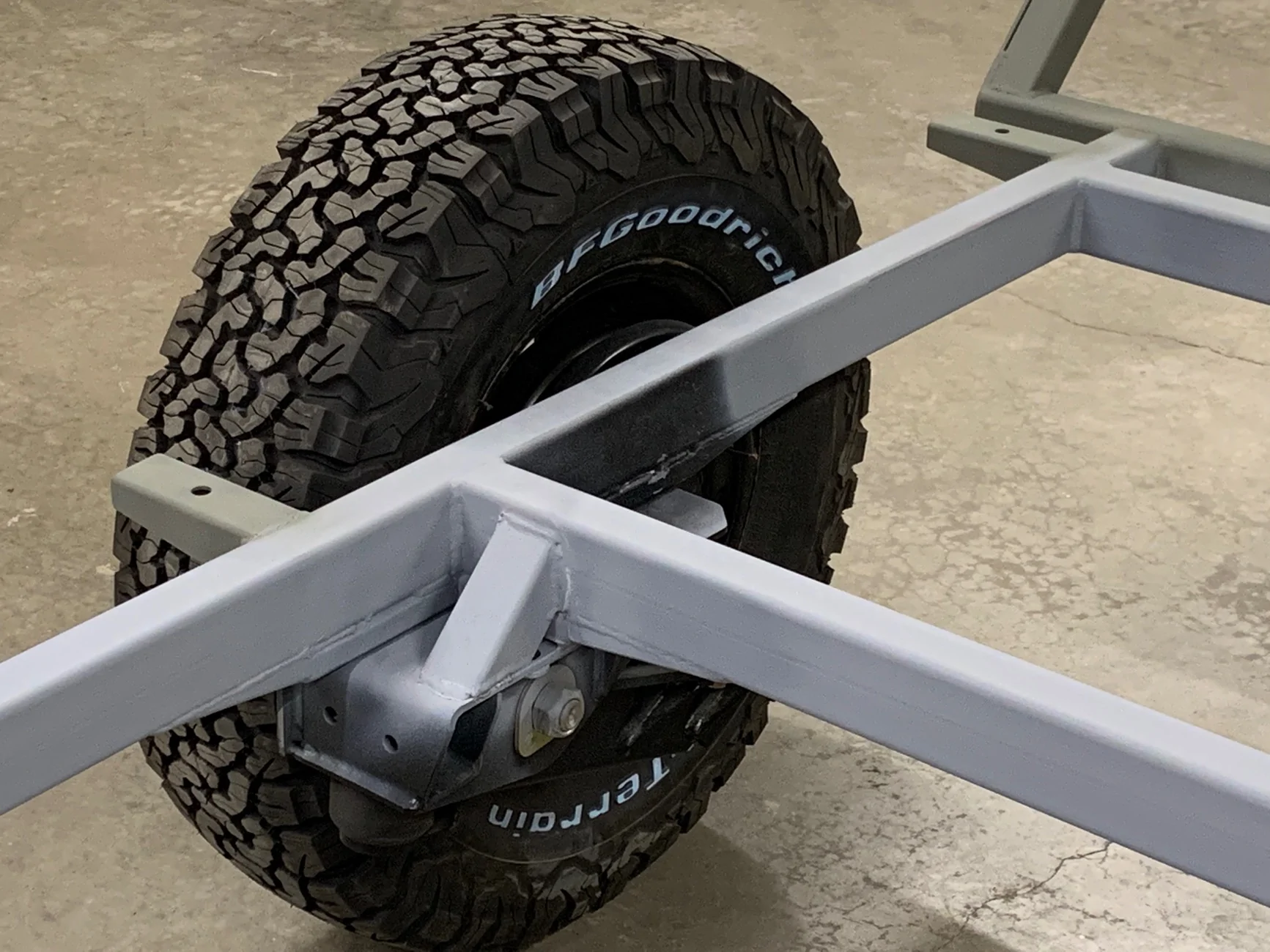

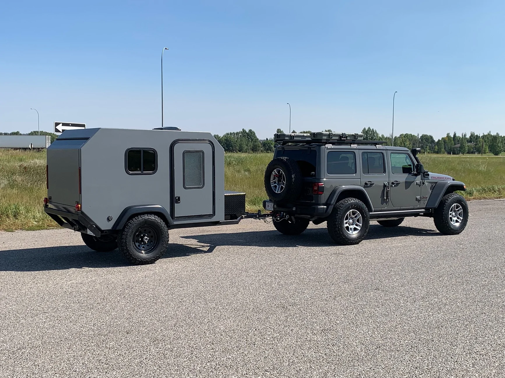

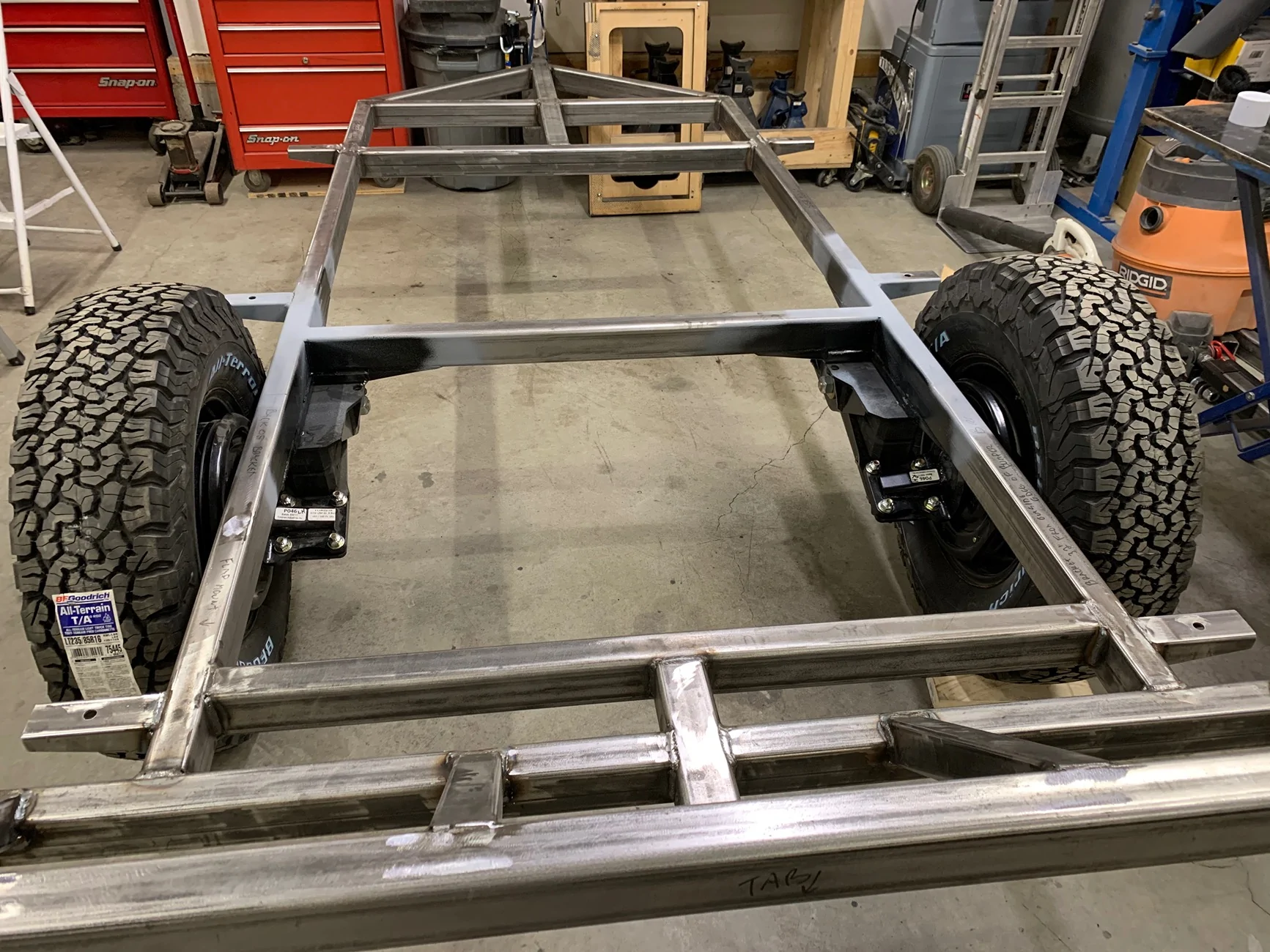

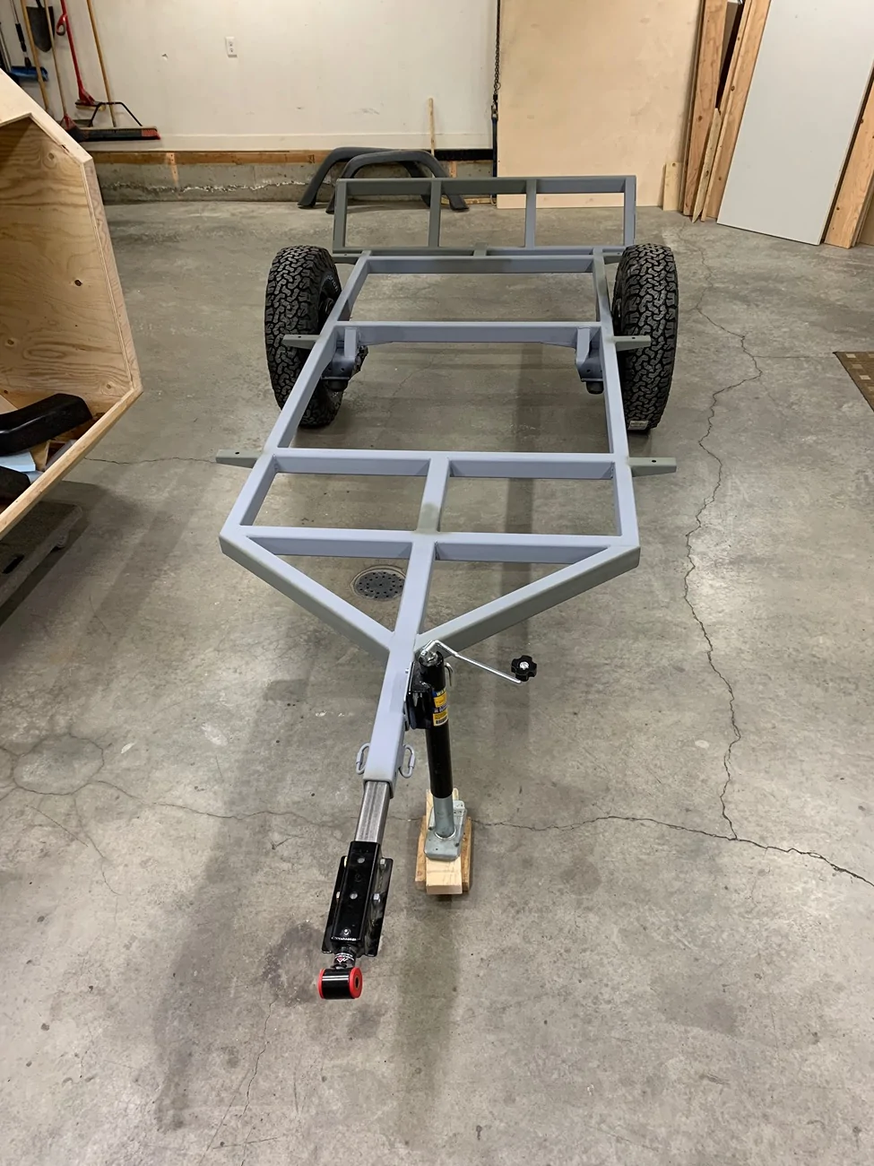

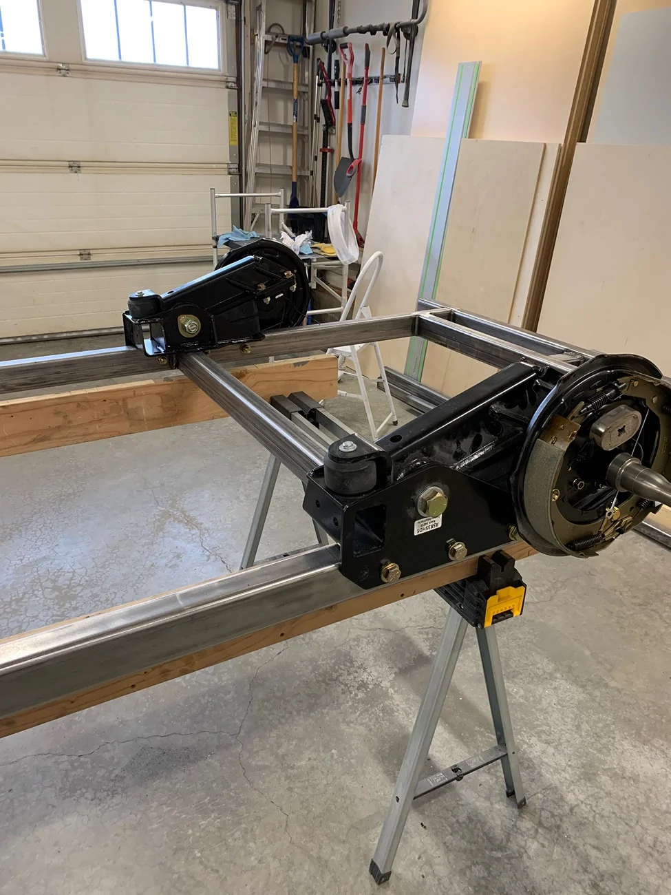

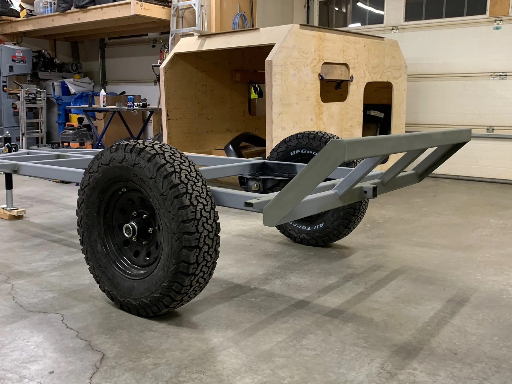

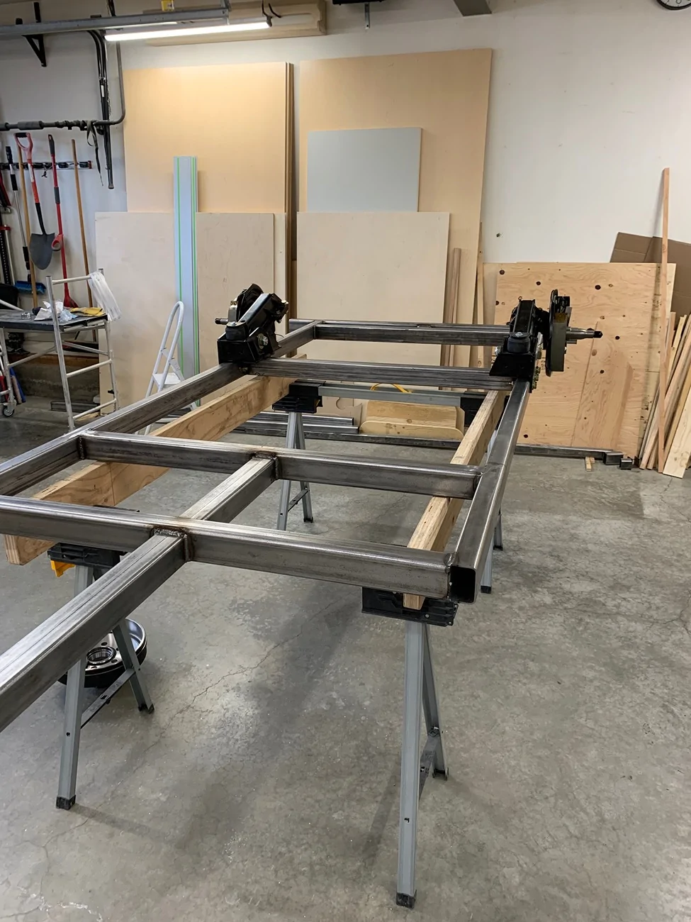

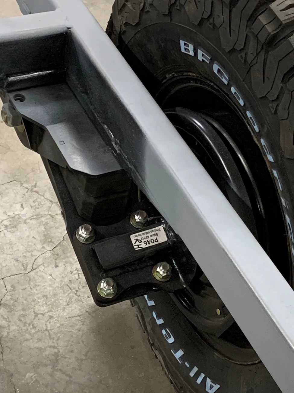

Timbren 3,500 axleless suspension with 6,000 hubs and 12” brakes. Dry weight should be right at 1,600 lbs
Jeep Wrangler JL Built myself a DIY off-road squaredrop trailer IMG_8424
Photos in no particular order
Jeep Wrangler JL Built myself a DIY off-road squaredrop trailer IMG_5610
Jeep Wrangler JL Built myself a DIY off-road squaredrop trailer IMG_5529
Jeep Wrangler JL Built myself a DIY off-road squaredrop trailer IMG_5609
Jeep Wrangler JL Built myself a DIY off-road squaredrop trailer IMG_5598
Jeep Wrangler JL Built myself a DIY off-road squaredrop trailer IMG_5611
Jeep Wrangler JL Built myself a DIY off-road squaredrop trailer IMG_5530
Jeep Wrangler JL Built myself a DIY off-road squaredrop trailer IMG_5548
Jeep Wrangler JL Built myself a DIY off-road squaredrop trailer IMG_5612
Jeep Wrangler JL Built myself a DIY off-road squaredrop trailer IMG_5670
Jeep Wrangler JL Built myself a DIY off-road squaredrop trailer IMG_5528

Been considering something like this, was this your own design or did you have plans that you followed?
Other than the general shape everything was my own design, from the frame up.

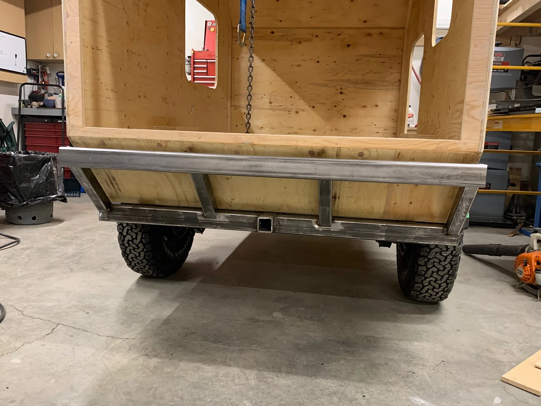

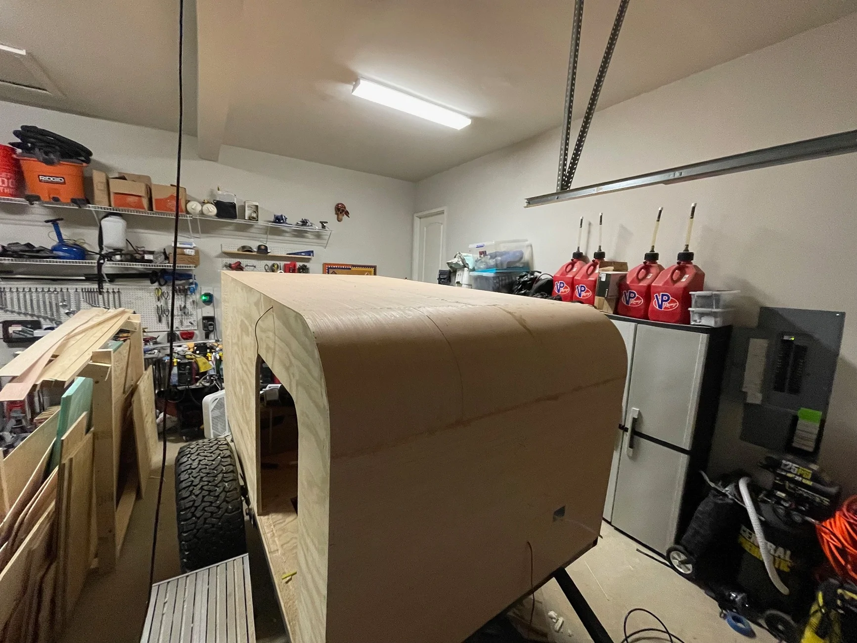

The pics give me PTSD. Thank god you were smarter than me and didn't try to radius the front top, that was the biggest pain of the whole build.
I really like your rear skid, that's one thing I thought about and didn't do.
Haha, I spent many, many, many hours trying to figure out I could radius the angled joints before finally giving up
GATORB8
May 30, 2021
8,887
11,810
CLT NC
21 JLURe, 06 LJ, 25 HDZR2

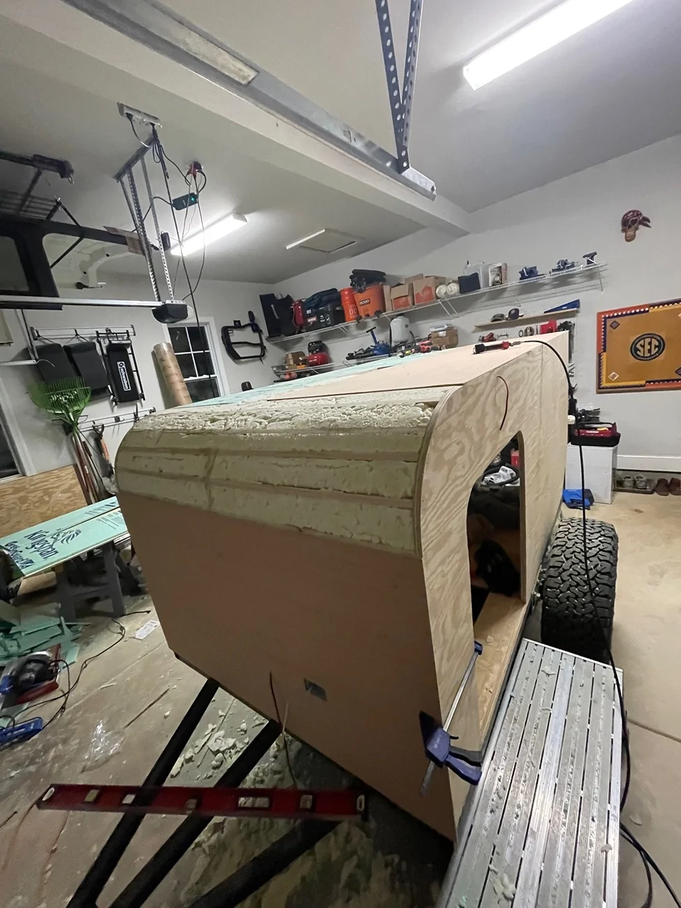

God, it was awful. Sectioned horizontal framing filled with spray foam, steamed Luan either side, then bondo. It was barely out of square and caused issues with my interior laminate, exterior skin, and interiora/exterior trim. Finished out by far the worst of my interior.

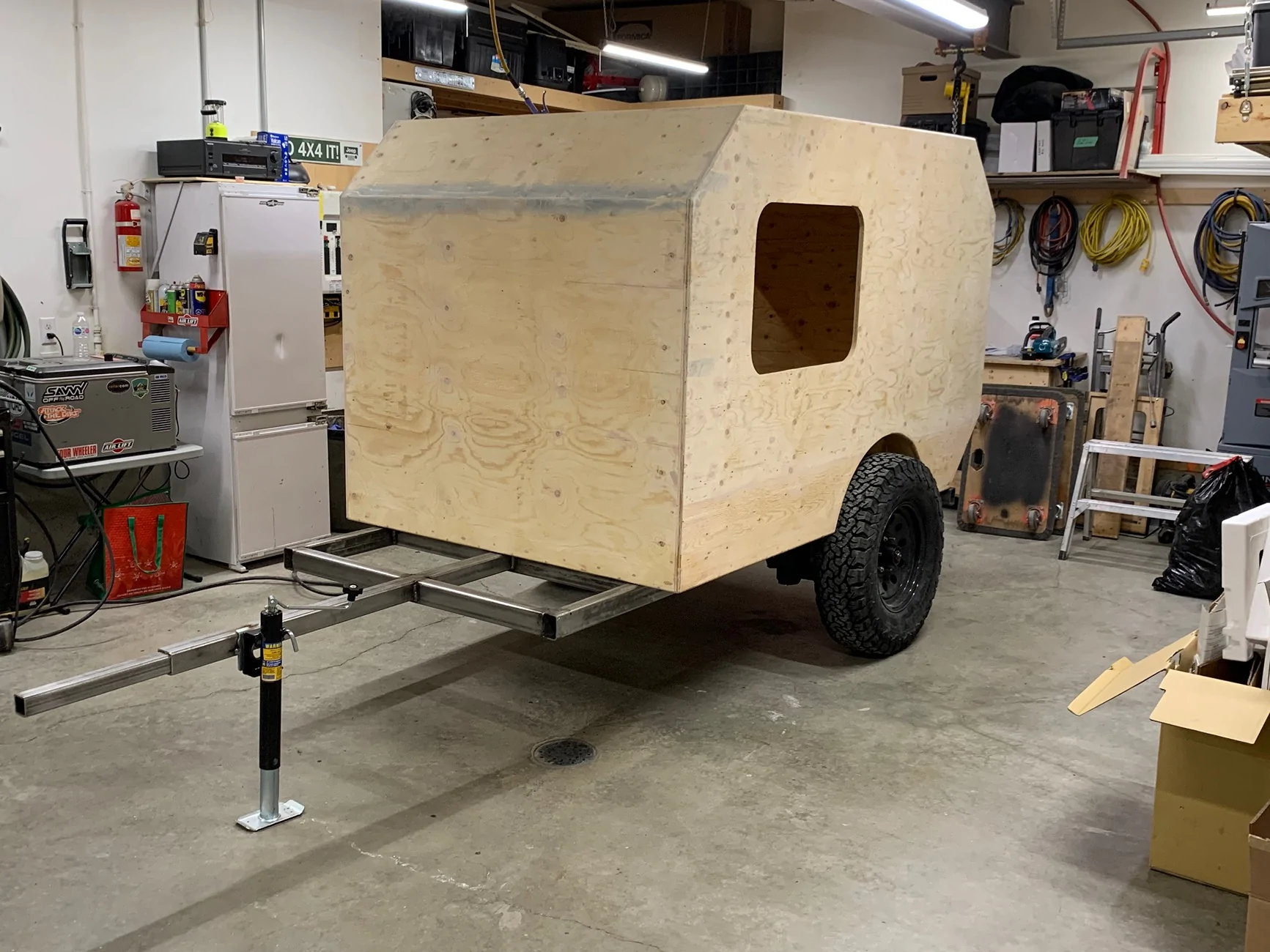

NICE!!! Looks very robust.
When I was rolling over the box to epoxy the bottom it got away from me and fell about 2’- 2-1/2’ and not a single joint has so much as a bondo crack in it.

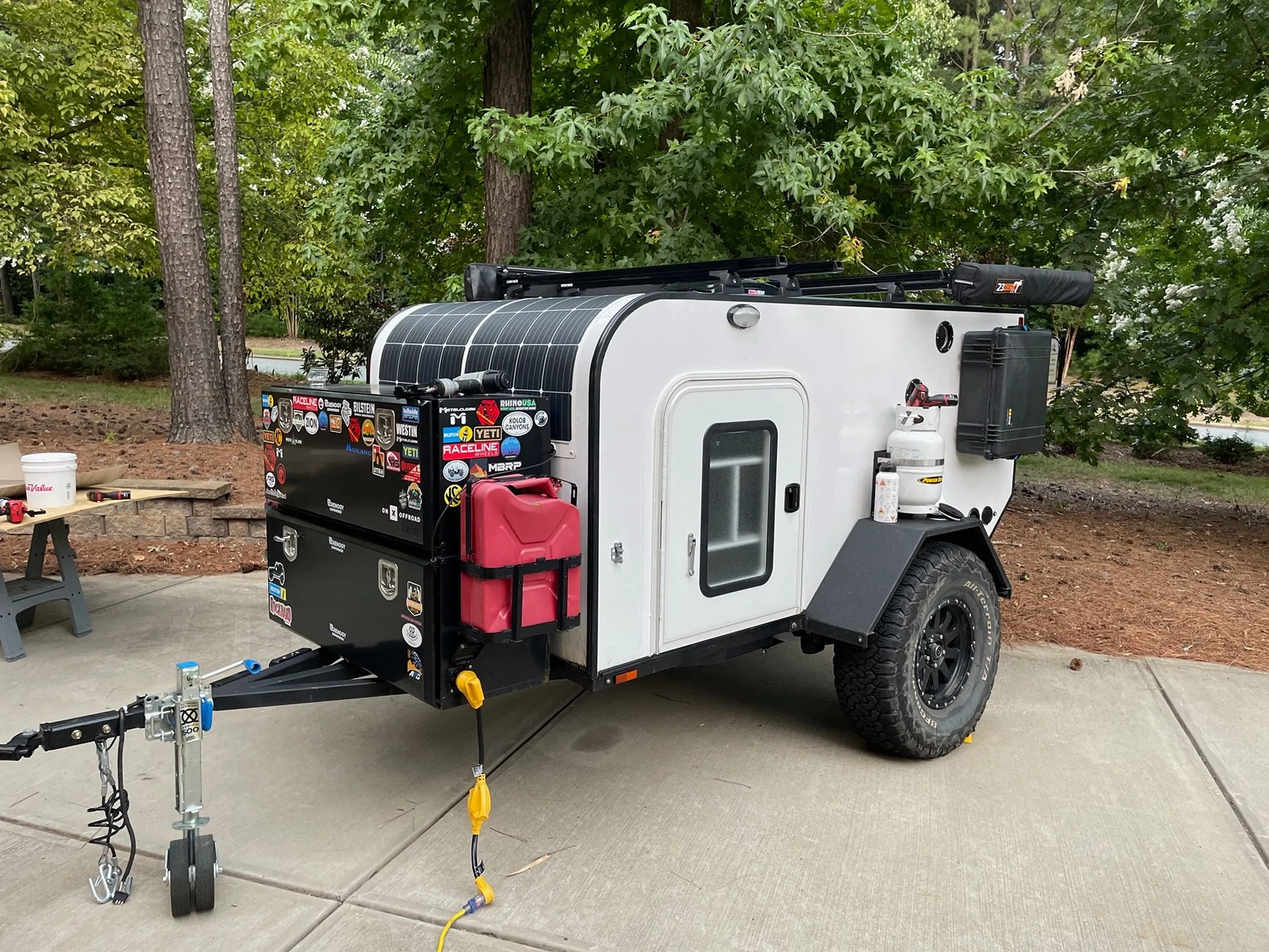

Very nice job! Can we see the interior?
what did you use for roofing?
