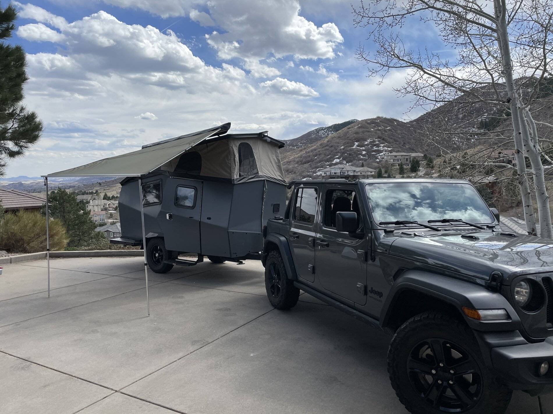

Another vote for the Taxa Cricket. Wife likes a little more comfort. Put a lock and roll hitch on and it tows great. Solid axel and have taken it down a few harder trails but noting too extreme. For what we do so far so good. Solar is great and the upgrade LiPo batteries give us plenty of power.
Just be ready to give tours of your set up.

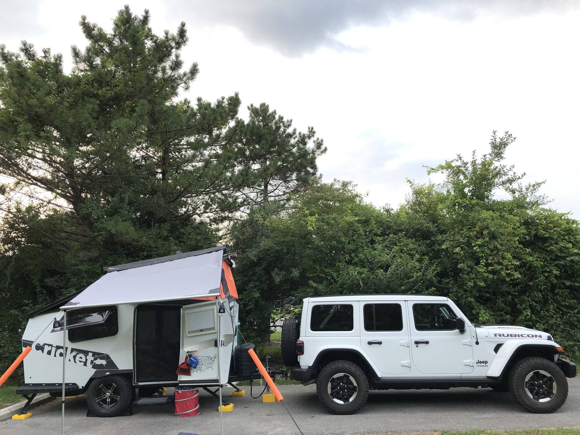

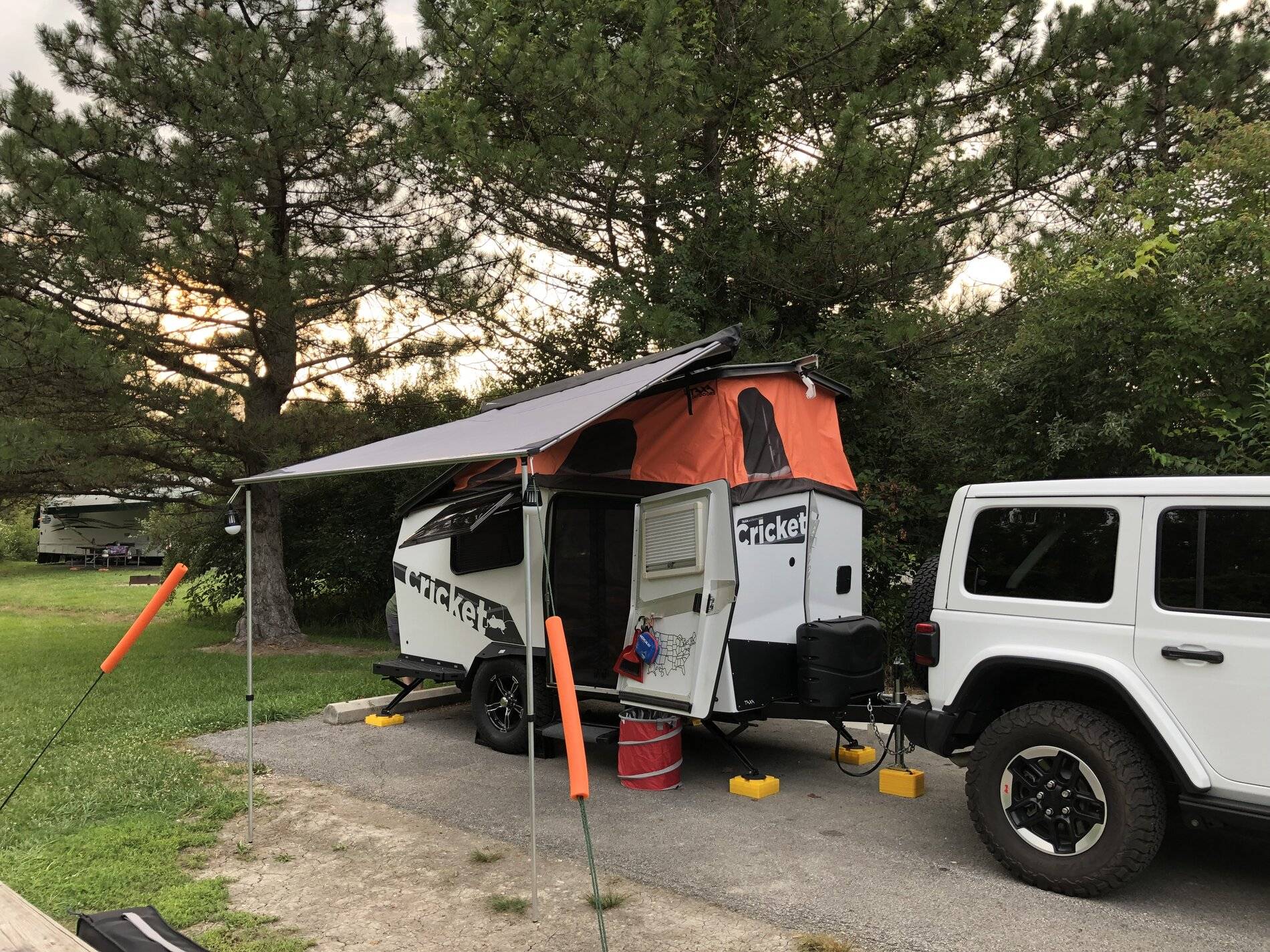

Here is our Taxa Cricket, picked it up on July 24th and started the build for solar, etc. This is about as bad as the Jeeps for taking money.
200ah of lithium, 100w fixed panel on the roof with another 200w portable, automatic transfer switch, switched out to Lithium compatible power distribution panel, Victron solar charge controller, Victron BMV-712, and 1000w pure sine wave inverter.

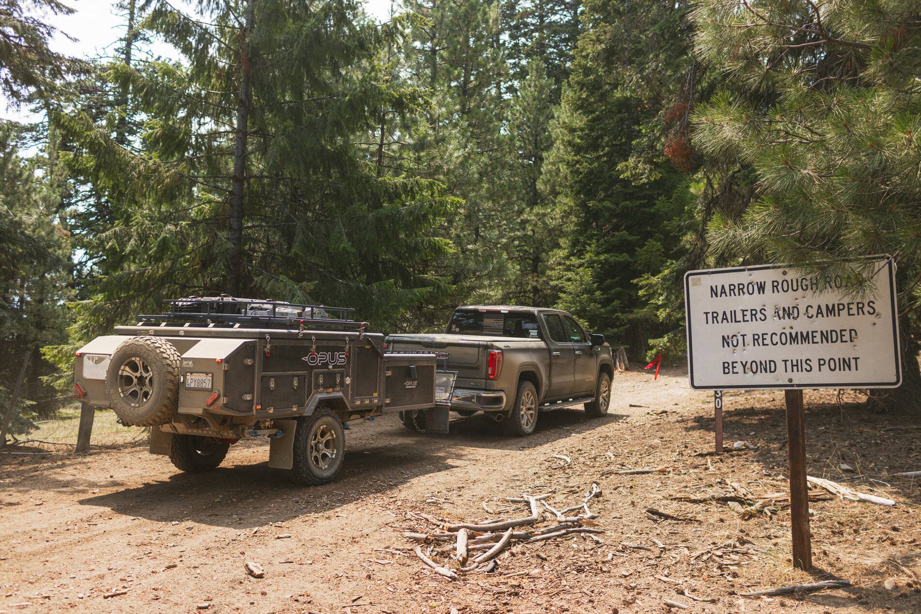

If you decide to swap out or what you ordered didn't meet your expectations - have a look at the OPUS. Fantastic off-road capability and comes in various configurations. We have an OP2 and love it - sorry, not pictured with the jeep (two door can't tow it). https://www.opuscamper.us/2-sleeper/ Jeep Wrangler JL Off-Road Campers opusoregon-0352

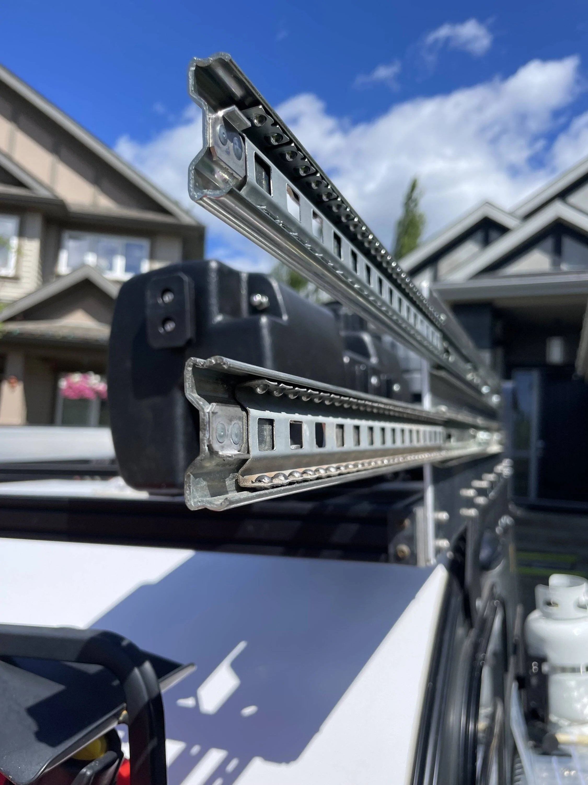

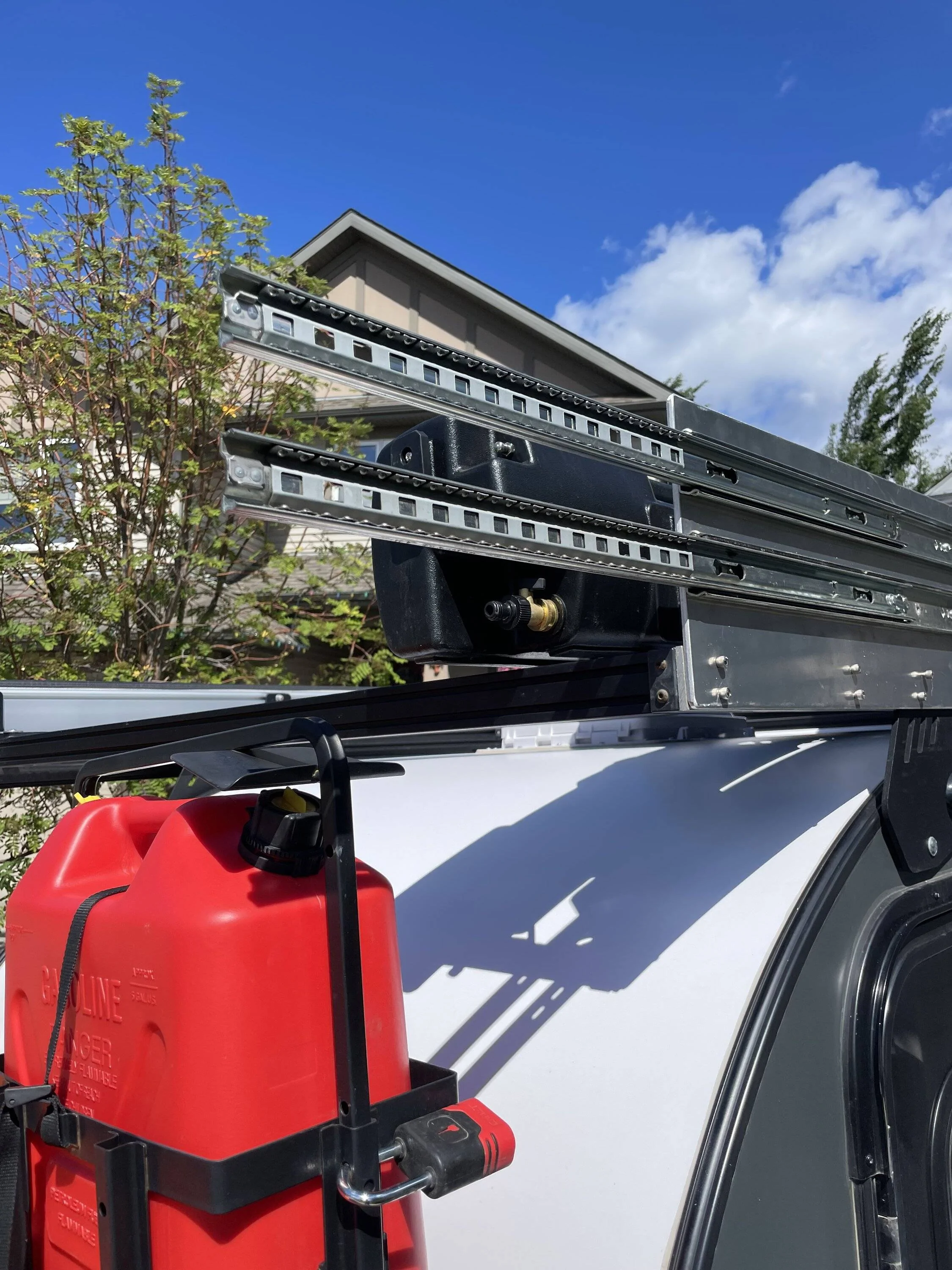

Finally got around to finishing the details and fabrication for the QuickPitch metal box ensuite. Whiel it was mounted to the trailer before our April trip, due to the side twist/torsion against the slide, it would tip and looked very unsupported. Despite using 250lb slides, slides are design to take force up and down for drawer weight with 1 slide per side, not support 25lbs of metal twisting it. So I had a 10" x 44" x 1/4" aluminum plate cut from Innovative Welding. With that, I drilled 14 holes in it to mount to the side of my 80/20 aluminum roof rack system. From there I used the 2nd slide, drilled out the locking mechanisms and then mounted both slides to the plan and both slides to the back of the box. I used neoprene bonded washers along with 1/4-20 x 1/2" button cap nuts and bolts and a locking washer to fasten the slides to the QuickPitch.
Below are some photos and here is a link to it in action: QuickPitch Quick-en-Suite Metal Box Unit custom slides
