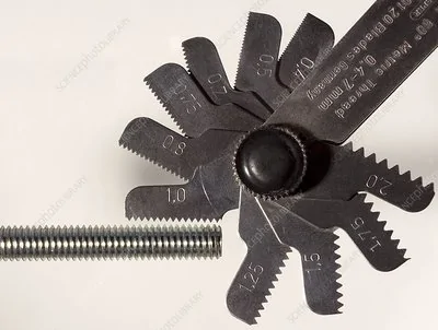

Measuring would work. If that's too much of a bother, go to the hardware store and buy some 6mm bolts/nuts in fine and coarse thread pitch (.75 and 1.0).
Jeep Wrangler JL Broke my door check nut - help! pitch gag
Jeep Wrangler JL Broke my door check nut - help! screw checker
Jeep Wrangler JL Broke my door check nut - help! caliper

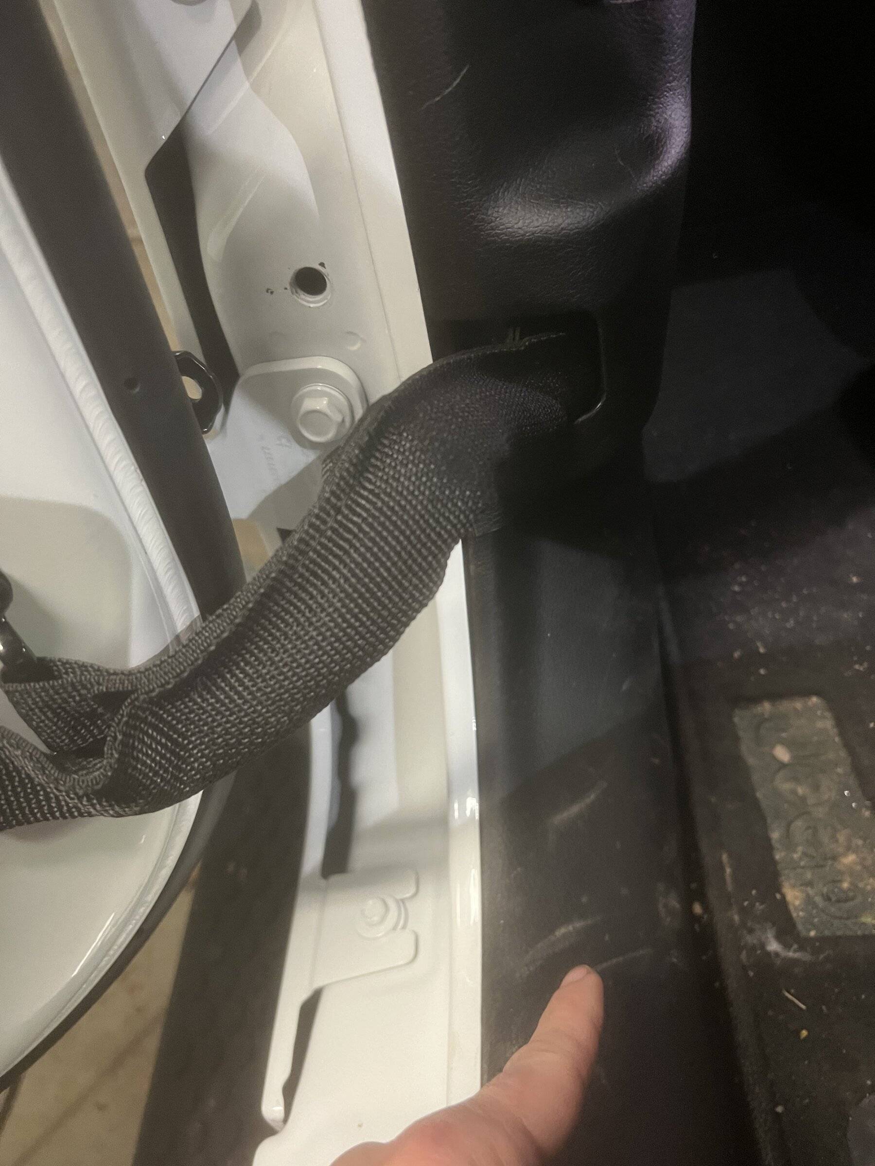

Here’s the hole, in the white metal upper left corner of the photo, just to confirm what I’m talking about.
So we don’t think the nutsert / rivnut will damage the door jamb? I don’t mind if it doesn’t look perfect.
In the photo I’m pointing to a bit of plastic that I wonder might give me access to where the nut fell, If I could remove it? But I don’t want to attempt to remove it if there’s a danger of breaking that too. Any idea what the piece is called, how I can look up removal…?

If you pull the kick panel, can you access the area behind it?

haven't tried but i just ordered some rivnuts they seem to be the solution
If it's something you don't remove regularly, a Rivnut will work. If you take the doors off and on a lot, Rivnuts tend to spin and make life miserable. For a frequently used fastener, I'd put a regular nutplate behind it with rivets holding it.

Second that — I added a rivnut, which worked for a little while, and then came off again. So instead I just left it, as I do take the doors off a lot and don’t care much about the door-stop function. (Although I did tear the cloth door keeper thing in a rear door — anyone know what part I need to repair that, how to do it?)
